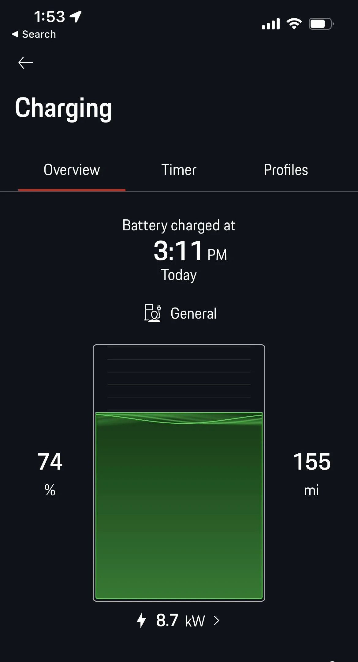

My car is charging right now via the Mobile Charger Connect that is connected to Wi-Fi at home and I believe I paired with My Porsche App. Just got all of this yesterday.
here is what the app looks like while charging. Is this what having the nicer Mobile Charge Connect shows you? Or is this normal and I’m not actually looking at the right place to see the additional data from the Mobile Charge Connect? I don’t see for example, where I can tell the car to stop or start charging, it’s just pulling from my profile.
thanks in advance.
thanks in advance.
PMCC is no different
I've not found a way to start/stop charging directly - you can fiddle with direct timers/profiles with the app however and those changes can cause charging to start/stop - but it's a bit indirect…
this is why the eV charger does not matter - it isn't that smart - all charging is controlled by the car (not the external box) - the car can charge from any EV charger - and the same scheduling and control is present because the EV charger is "stupid" and just an on/off switch to let power flow or not flow…
the fancier and more expensive (too expensive) PMCC has the following
1. wifi - PMC+ does not have Wifi- what you are seeing your app is the "car's view" of the charging session - it will be the same with _ANY_ EV chargers (EVSE) - for example charging at a public charger at the mall/business.
2. LCD screen
3. the ability to upload charging statistics to your porscheID portal
4. adjustable "amps" so you can lower the amps from the maximum
5. interface with the Porsche Home Energy Connect (HEC) for "smart" power manaagement - HEC to date is NOT a thing in North American - so that functionality is so far un-tapped.
functionally the PMC/PMC+/PMCC/PWCC are identical in terms of charging the vehicle - with no more/less control over a charging session.
