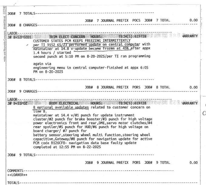

I got 8 "optional available updates related to customer concern on line 8" (refer back to my work order in post #1). Probably worded as "related" for warranty reimbursement reasons. I was told these had nothing to do with the update to version 3885, but simply showed as updates available for my car when the tech got into the Porsche system. The specific updates seem to be VIN/option specific. My dealer is pretty conscientious as there was no reason to even tell me about the available updates as they were not really related to my complaint and update to version 3885. Sweet talk your dealer and see what is available.
