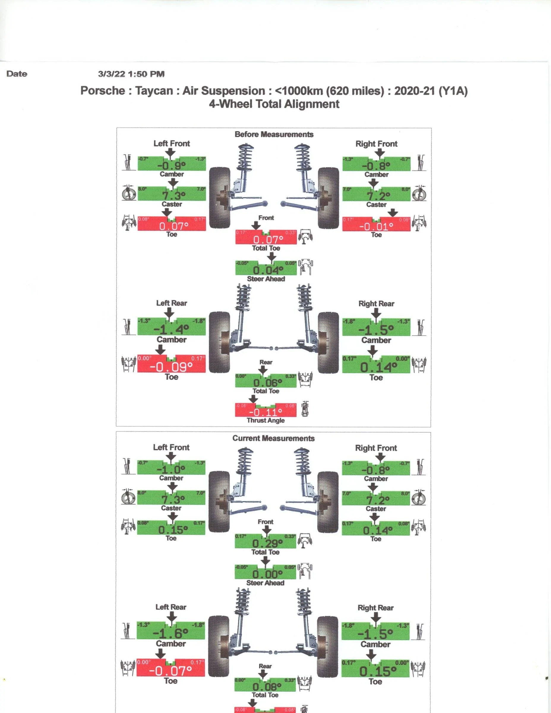

Just had alignment done on my 4 S with RAS. Toe was off slightly. Front tires worn out at 12,000 miles. $146 at local alignment shop.
Porsche Taycan Need an alignment. Anything special about the Taycan's alignment / suspension to know about? Taycan 4 S alignment 3 3 22001
Did you have to provide them with any guides or special instructions, or just assume they'd figure it out?
r553
Apr 26, 2019
602
318
Rockledge FL
No I didn't. This shop I've been using for many years. They just did the alignment with no drama. Unlike the dealer where I have actually had an aligned car put out of alignment. My theory is that when the steering wheel is pointed straight ahead the RAS is inactive.
