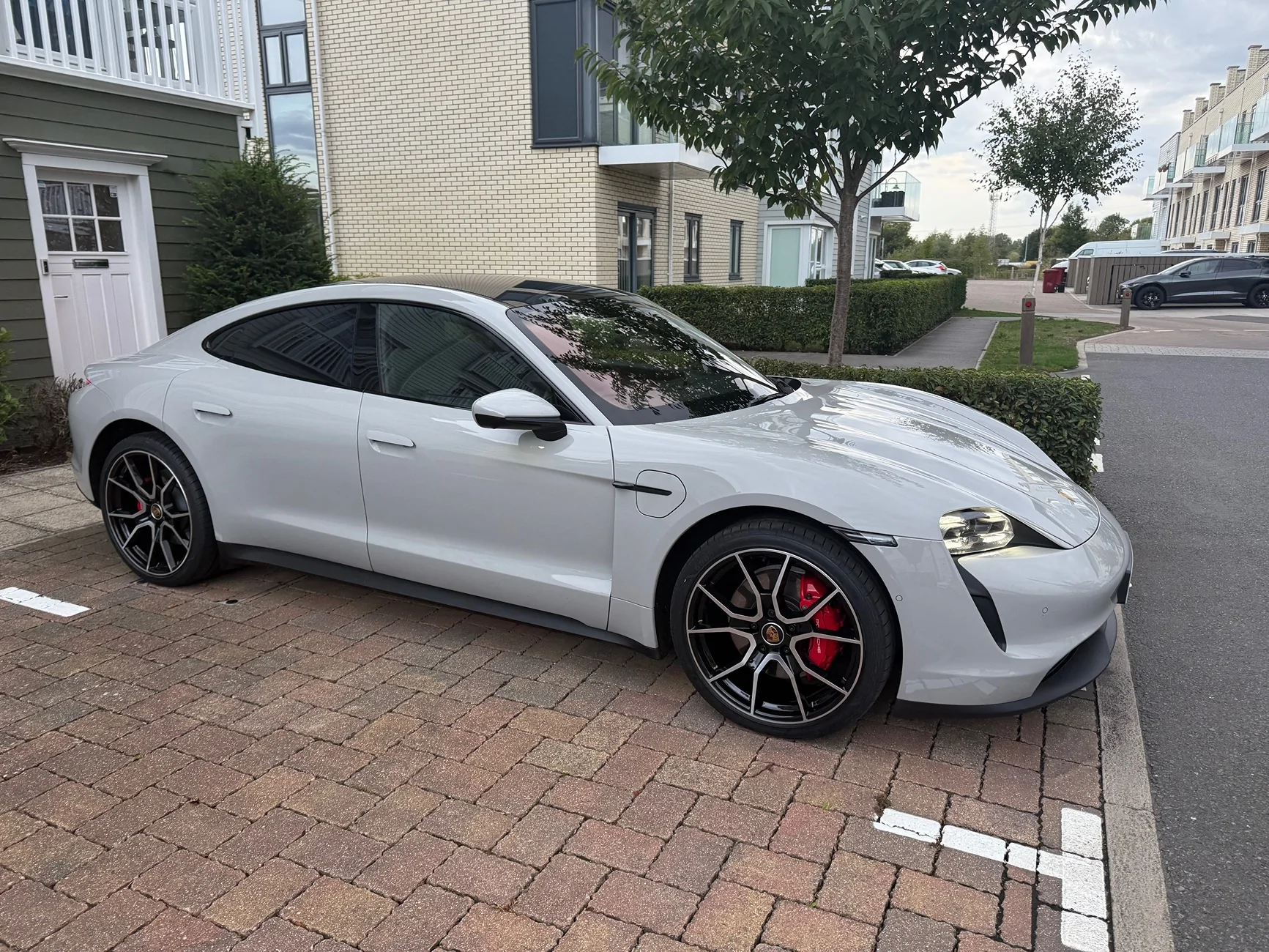

I would appreciate any recommendations or even any decent independent garage that can make a proper alignment diagnosis in Berkshire or nearby (I would never go again to kwik-fit due to past experience with my Bmw). Car looks great with the 21" Spyder. Thanks all.

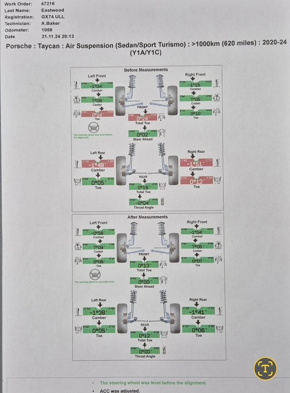

Price at OPC for alignment is outrageous. Porsche Mid-Sussex did mine for free at 1000m as one corner had already started to wear unevenly. It took the tech about 25 minutes to check and adjust toe and rear camber.
Take it to any good tyre shop with Hunter Engineering alignment equipment and they can check and adjust everything other than the front camber for around £100. I'm not sure if RWS complicates things but no doubt they can advise.
If the front camber needs adjusting then the front bumper has to come off 🙈
My print attached
