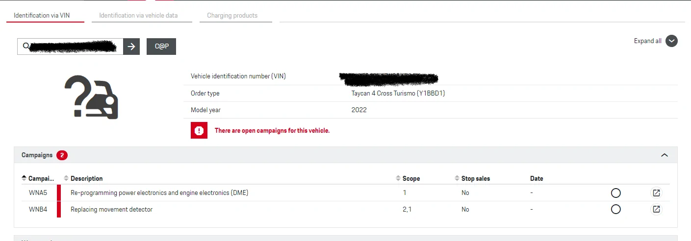

Mine goes in for the WNA5 update the end of March. WNB4 (interior movement detector) will have to wait for parts. Thanks to info from this forum, I asked my service dept directly if my car was on the list. I have heard nothing from Porsche NA .
Dave777 - Is this screenshot from a page you're able to access via your Porsche account? Or was this from your service rep? I'd love to see what mine looks like...
