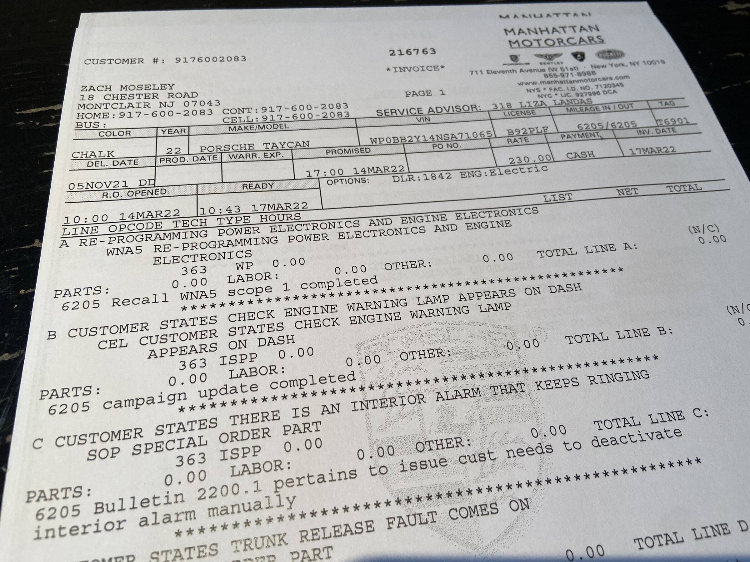

Got mine done today. Thought this was pretty funny:
“Customer states check engine warning lamp appears on dash”
firstl, I didn’t say that, but more importantly there is no engine! ?‍♂
Actually the definition of an 'engine' would include an electric motor and in the case of the Taycan it could have two 'engines' so they aren't wrong per se!
