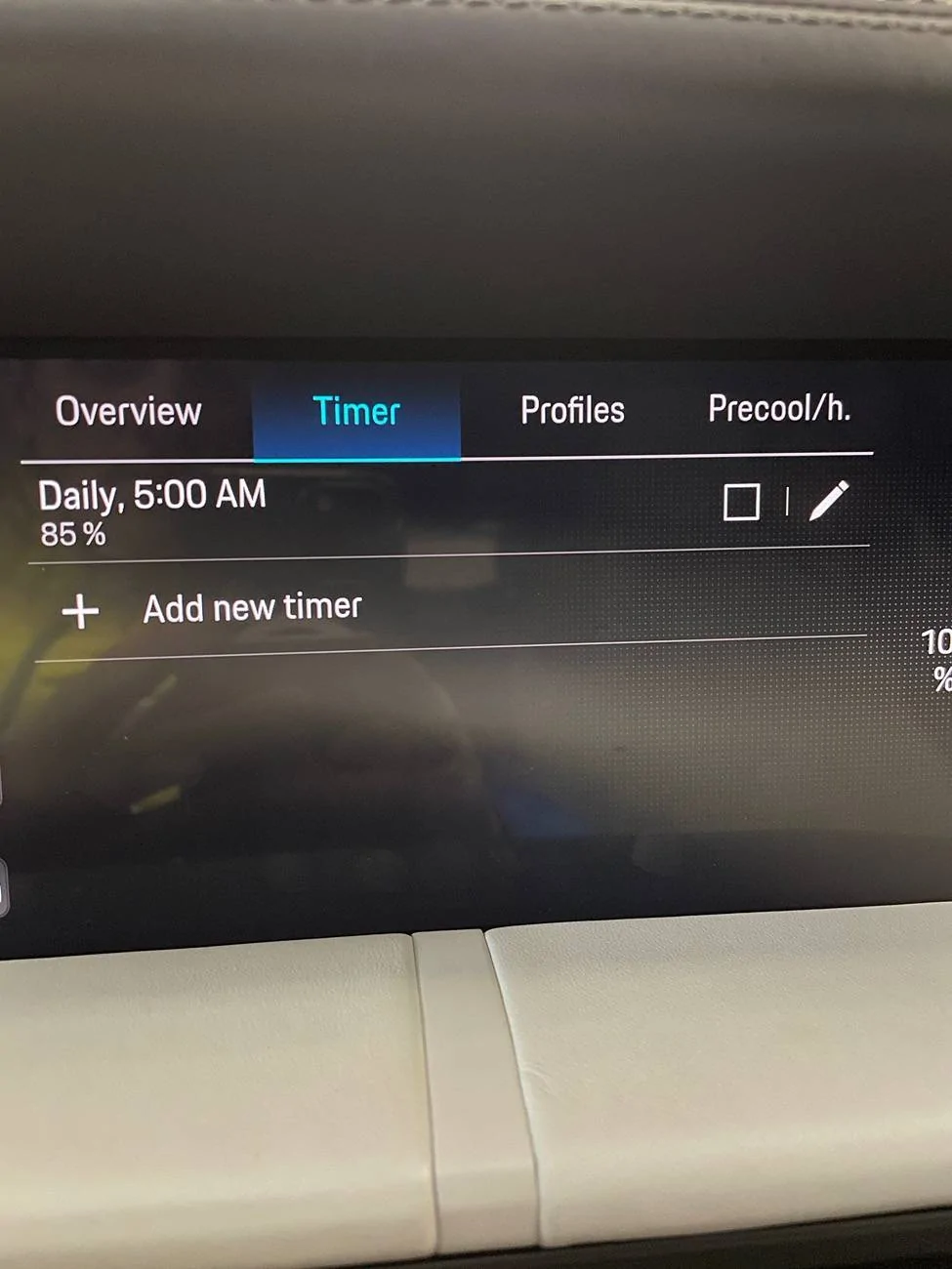

any EVSE (autel/tesla/chargepoint) that offers scheduling support only does so by simple disconnecting from the vehicle when they can not provide power - this will prevent the vehicle from charing during those hours, but for this to work oyu have to fore-go using the vehicle's onboard scheduling - since the EVSE can not force power into the vehilce and/or force it to charge - this only works if the vehicle is configured to charge when ever it's plugged in…
if your EVSE is programmed to allow charing between 11 pm and 7 am
and your Taycan is programed fro depature time charging at 6 am
your EVSE will be "offline" until 11 pm - will turn on at 11 pm - but the Taycan remain "waiting" until like 2 hours before 6 am and begin charging at 4 am to meet it's 6 am dead line
but it will fail to charge if you have a 9 am departure schedule in the Taycan
EVSE offline until 11 pm - online until 7 am
Taycan "knows" it has departure timer for 9 am - it also knows it only need 90 minute to charge - so internally the taycan schedule itself to begin charging at 7:30 am
11 pm comes around - EVSE pop's "online" - Taycan says great - I'm going to wait until 7:30 am to begin charging to reach my 9 am depature time
7 am comes around EVSE drops offline - Taycan see's "no power/no cord" -
your Taycan never charges because it's schedule required power to be available at 7:30 am - but your EVSE schedule drops it offline at 7 am…

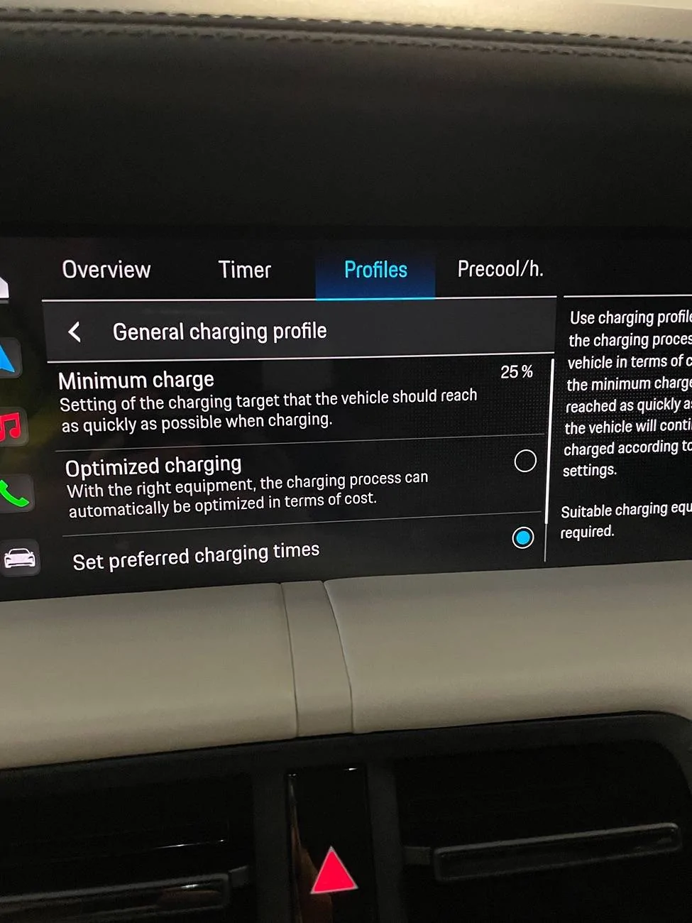

@Ducs, I just charged yesterday using my Grizzl-E Classic, which has no extra features or timers, and the Taycan charged exactly according to the schedule it used with my Porsche PMCC. Like @daveo4EV said, this is almost certainly an issue with either your Taycan or Chargepoint EVSE settings.
Double check that Direct Charging is not set on the car. This is a different tab than the timers or profiles and is easily missed.
Good luck with troubleshooting.
