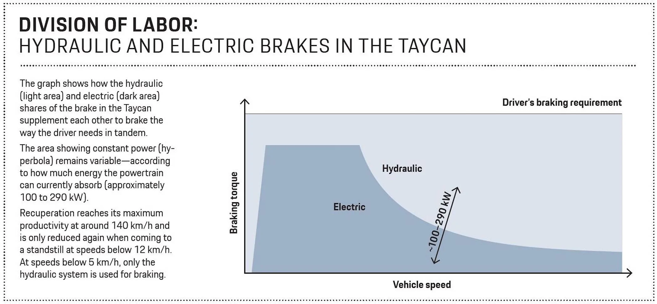

"The brakes are fine." on your car, and apparently many others (but do you really want any "quirks" in a brake system?). The brakes are not fine on my car for some as yet unknown reason. From the numerous posts on this forum a fair number of other cars suffer from varying levels of this problem. The brakes felt perfectly normal on several test drive cars and on mine upon delivery. The rather disconcerting feeling of losing the brakes slowly developed. When my car was in for the battery test/recall the tech felt the problem and updated the PSM software. This improved the brake feel and made the application of the brakes consistent from stop to stop and he pronounced them "normal". If there was no problem a software update would have done nothing to change the feel of the brakes. The inconsistency has slowly returned. The TSB for this problem (90/21) has been changed multiple times from replacing components to doing a brake flush to software. Seems like Porsche acknowledges a problem but doesn't quite know what is causing it and is thus at a loss as how to fix it.
My statement regarding 3 mph is from Porsche's News Room. "At speeds below 5km/h, only the hydraulic system is used for braking." and that is right where I lose braking and have to depress the pedal further. Regen braking stops there and for whatever reason the hydraulic brakes have not been blended in. Press the pedal further and hydraulic braking is engaged.
Porsche Taycan New owner questions…. 1713983766852-mo
I agree that the car will stop/slow just fine when it has to. High speed/emergency braking is impressive. It's the slow gradual stop that is an issue.

I literally said "I can understand that not everyone would willingly accept that brakes may have 'quirks' ". You also seem to agree that the car will stop, and it is the brake pedal feeling that is disconcerting. This being a 'new owner' thread, my intention was to add some color to your earlier statement "frequently (like almost every slow gradual stop) causes a loss of any braking that requires additional pedal travel." You could see how "loss of any braking" might be interpreted to mean "the brakes don't".
Regen cuts off at 12km/h; that's the 8mph I alluded to earlier, and where (in my case) I feel the transition from regenerative to hydraulic braking. (I rarely engage recuperation, which indeed would be yet another 'step' .) Hope you can get the issue afflicting your car fixed soon.
