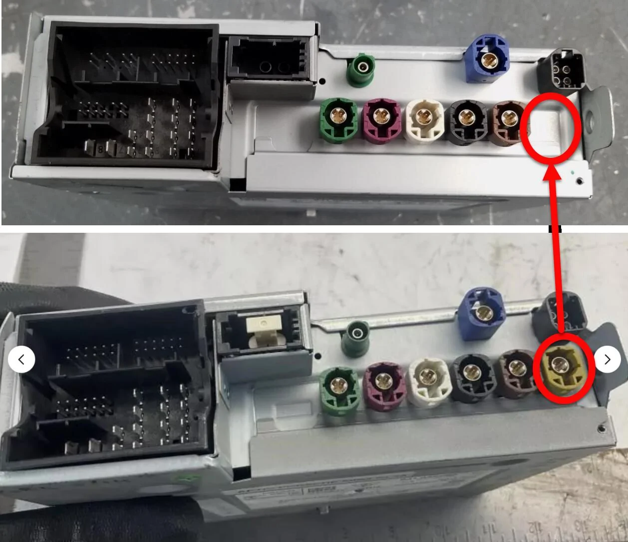

That's right, it's easy to install — takes about 30 minutes. The overall performance is very fast, even faster than the PCM :rock:
With SIM card support, there's no need to use a mobile hotspot.
Can you install this in a Taycan with no existing passenger screen?
