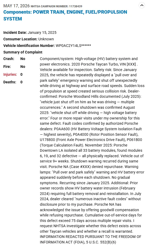

NHTSA Complaint: "Pull over and park safely" and shutdown while driving - May 17, 2026

Thank you, really dangerous potentially.

CT14 has reported that isolation faults are very common, and almost all the batteries he opens have some water damage.
I would suspect the battery is compromised due to water damage, and porsche should have replaced it whole, but they arent’t, because porsche is a “premium” German brand.
