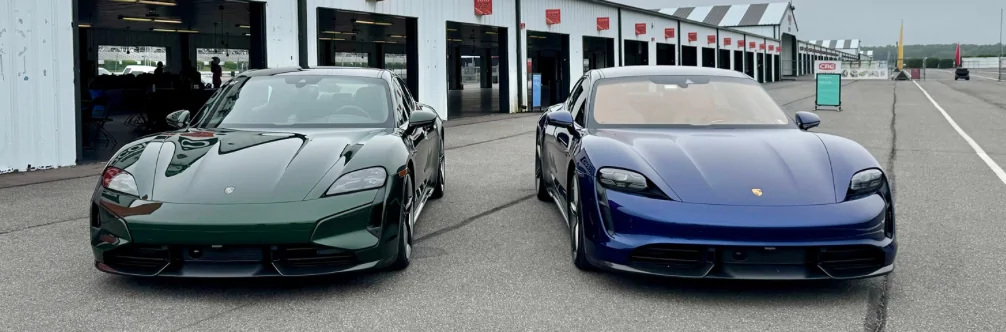

ETA: How can I find out if the car is J1.1 or J1.2?
By looking at it! 😏

Model Year 2025 onwards saw the facelifted J1.2 on sale.
How old is your car?
Visual cue are the headlights as mentioned.
