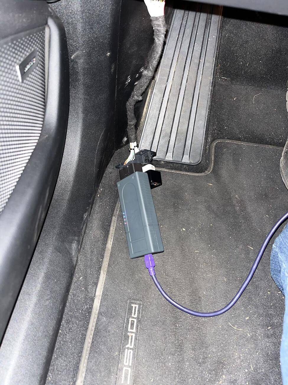

yes, but I recommend sitting in the car! :D
I prefer to have the laptop(s) and any sniffers on the roof of the car (on some soft padding not to scratch the roof), with only 1 OBD cable going into the car - kind of like a "standing desk" setup. I do that in the garage of course, so no weather issues.

this would not work, as many of these sessions shown above took several hours, so you need power cables as well as a seat (in my age :D)
88
8,361
7,372
I do run power cables to the laptop(s) on the roof. Still easier for me on the roof than getting in and out of the tight car with equipment connected (actually managed to kick the OBD connector off a couple of times when doing that). I even considered using the wifi feature of the OBD to just sit comfortably in my office while playing with it, but I like seeing what the car does when I’m connected.
