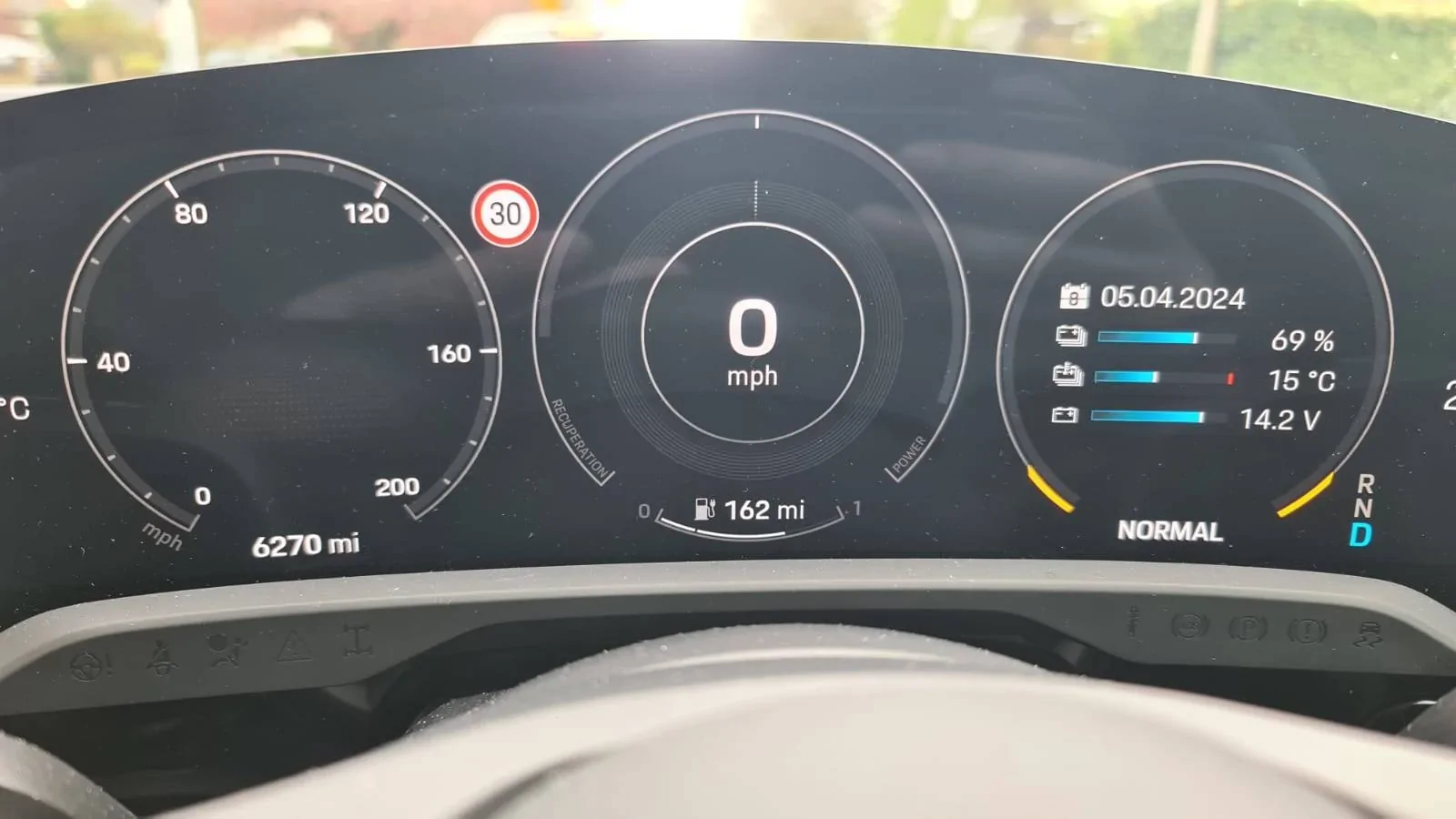

I am still searching where to find the SOC of the 12V battery!
On the dash screen, it's on the right hand side section where you can see the battery SOC, and other car info, you can also see the 12V SOC.
See below image (found off Google search, not my car):
Porsche Taycan Official Porsche documented guidance for the 12v battery 1776405940131-u6

lol. I actually saw that one a few days ago but didn’t connect the dots!!
sooooo much info to digest…. Thanks!
