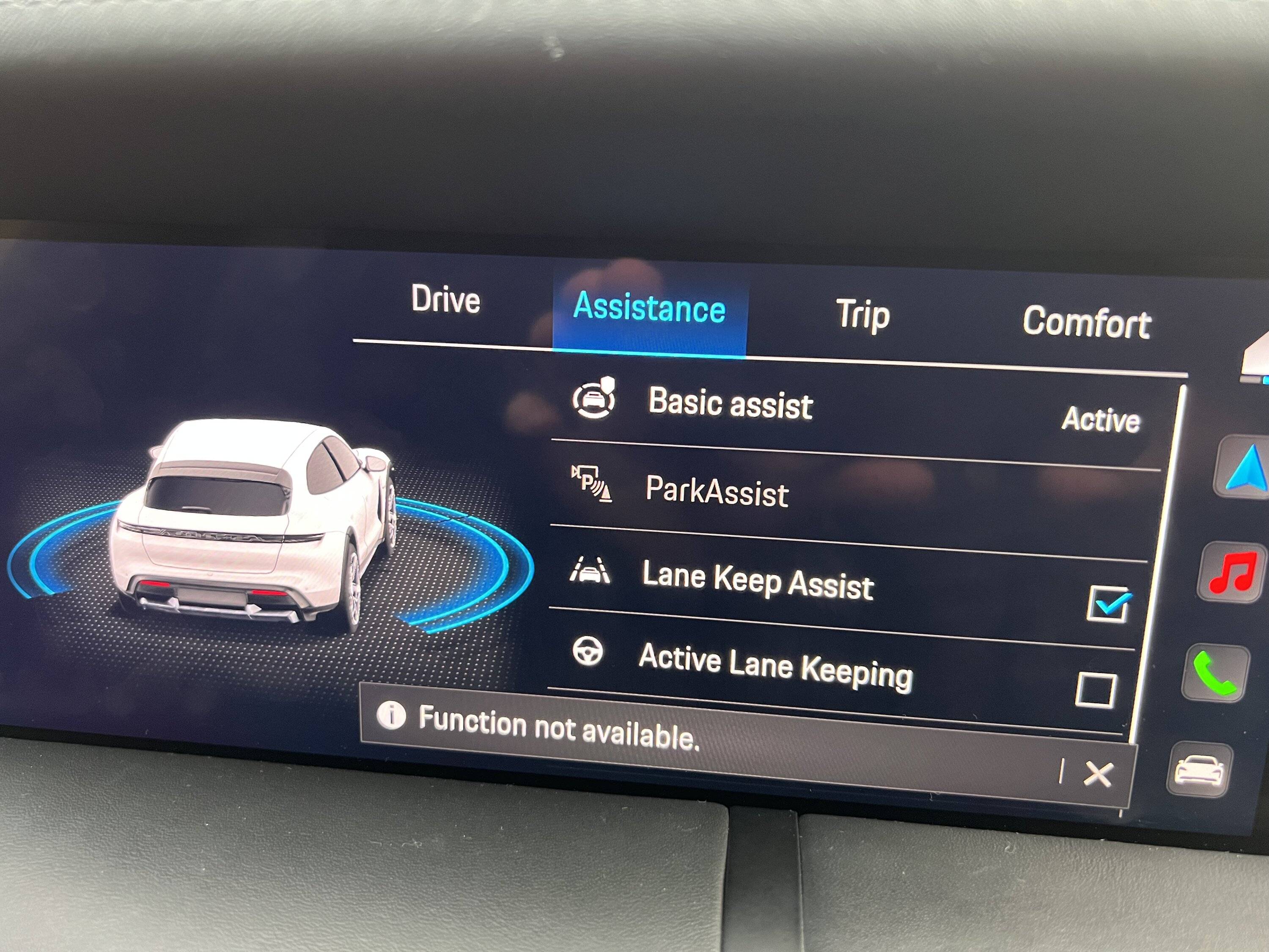

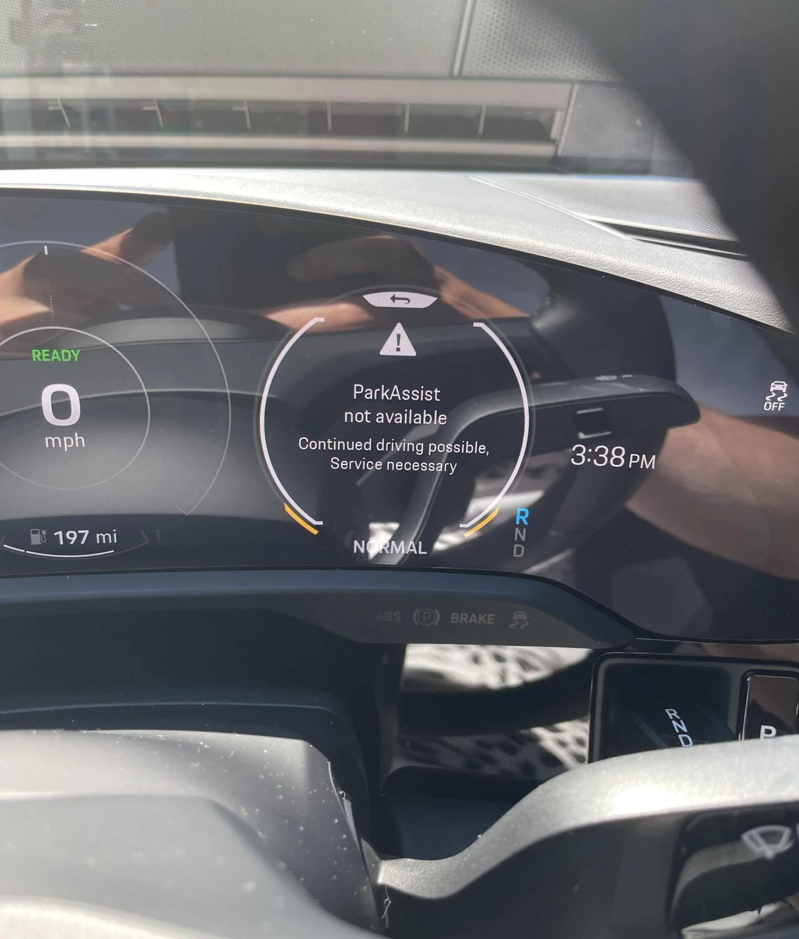

I have had several occurrences of ParkAssist unavailable error. A few before WMA5 and a few after. I have photos from all which I shared with the dealer in two separate service visits and they were not able to diagnose or fix it. Even though the warning says "service required" it does not record any error codes for the dealer to debug and there is no related TSB with instructions from the motherland.
I personally filed an NHTSA complaint for ParkAssist (and couple of other safety systems) failing sporadically. I also don't like the attitude that this is ok, just restart the car and it will go away. I expect safety systems to work every time as they did in all other cars I owned, and when I get a error message that says "service required" then I expect the service to be able to fix the issue. If you live in the US and experience the same issue I suggest that you also file a complaint. I don't see any other way for Porsche to take these bugs seriously.

I agree. I have this error 1 hour ago, was working without any problems for 7k miles before that. I Will fill the complaint for sure.

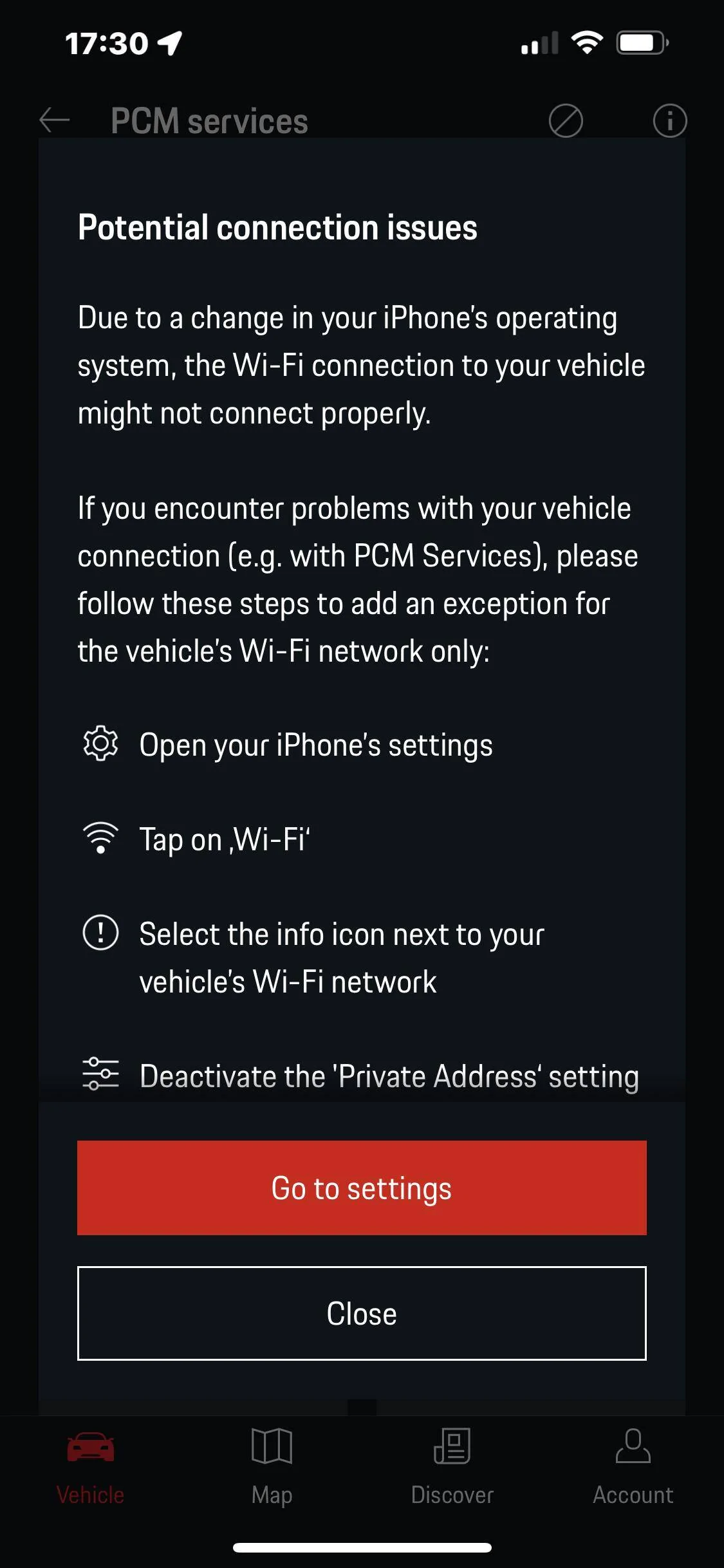

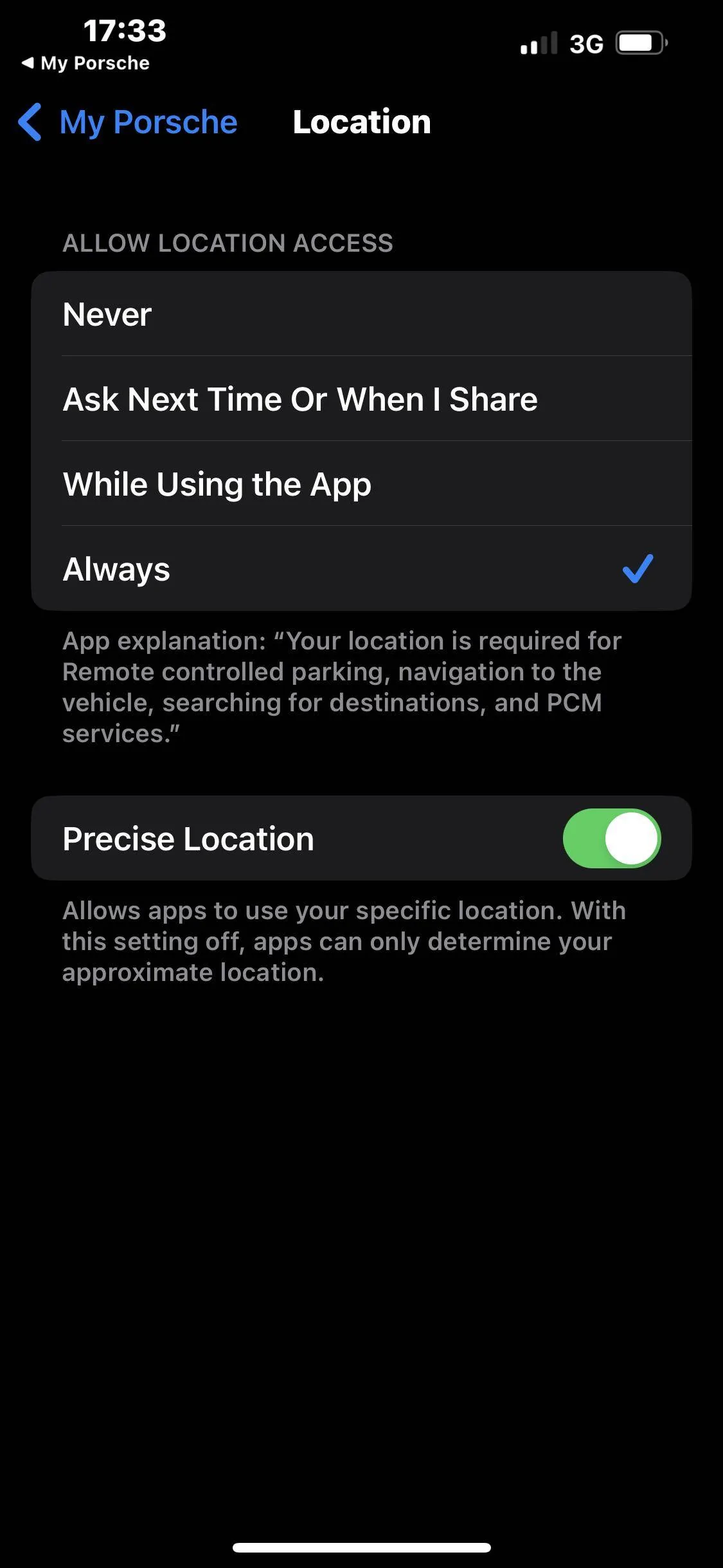

I've just had this in my 2023 CT4.
I found a solution with the My Porsche app and my iPhone settings, as per the screenshots below.
2 things to check on the phone settings with iOS.
Far easier to park the beast when you have rear cameras that work!!
