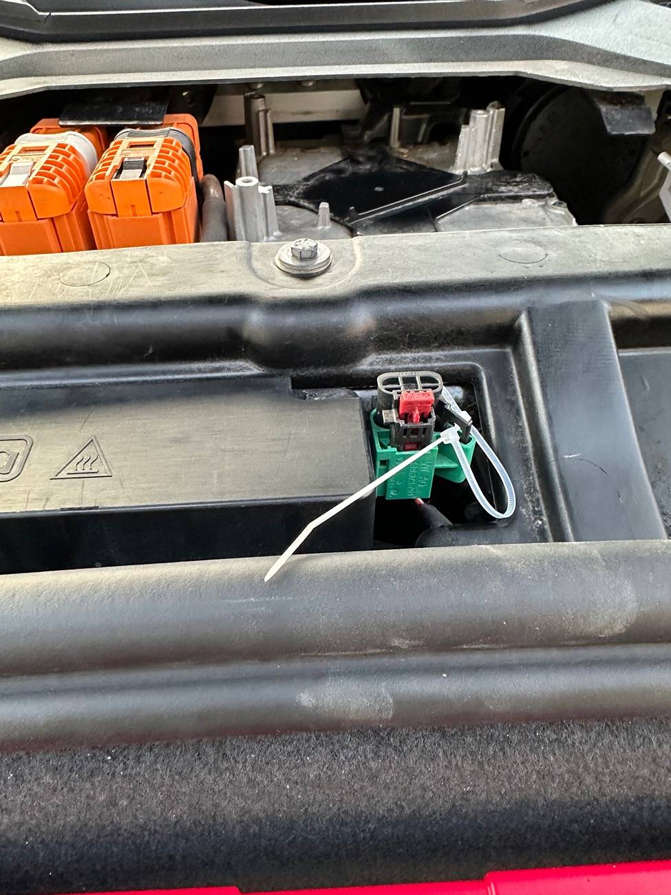

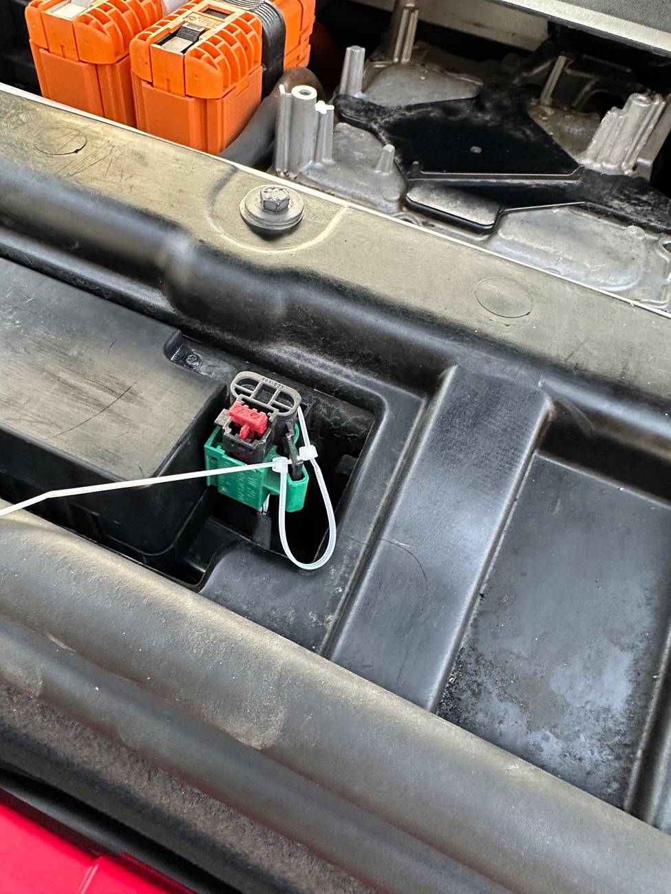

Shun, I am very grateful to you - everything is fine at the moment, as a precaution, as you can see in the photos, I put some tightening straps in case someone simply puts the switch on! In the morning I will start checking the fuses at the back of the trunk and the fuses at the front!!!on the 12 V battery I wrapped a cloth underneath and above the negative pole so as not to make contact with anything around it

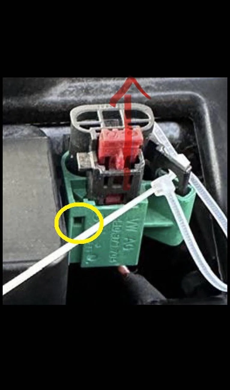

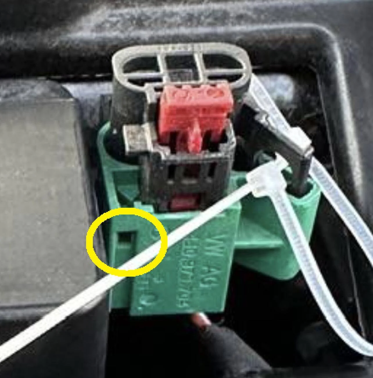

As you will find out, it is almost impossible to put the 800V back on by accident.
You need to insert a small screwdriver through the yellow hole to move a tab out of the way.
The red tab can then be pushed towards the rear of the car and pushed down along with the black tab.

but it is no longer disconnected correctly??? that is, if I understood correctly, you advise me to put a small screwdriver in the hole marked in yellow so that no one can return or connect...? Or did you mean that for completely disconnected tech 800 v I have to put small screwdriver in the hole marked put the red clip towards the rear and pull up the black connector and remove it completely from the green one ……is that???

but it is no longer connected correctly??? that is, if I understood correctly, you advise me to put a small screwdriver in the hole marked in yellow so that no one can return or connect...? Or did you mean that to put the switch back on it is necessary to put a small screwdriver in the hole marked to tie it, put the red clip down and put everything back down again...?!!!!
So I have to remove the black tab from the green piece to completely disconnect it???… is that it…??

The 800V is fully disconnected on your car.
You are reading too much into what I said.

?? now I understand, when later it is necessary to reconnect the switch in, I simply have to insert a small screwdriver in the hole marked in yellow by you, push the red and black connector towards and pull down, it is connected again! I apologize for my initial confusion?
yes definitely this way it is not easy for someone to re-enable the high voltage system?

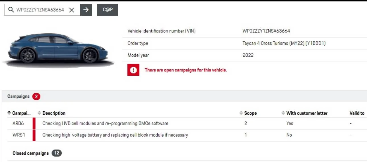

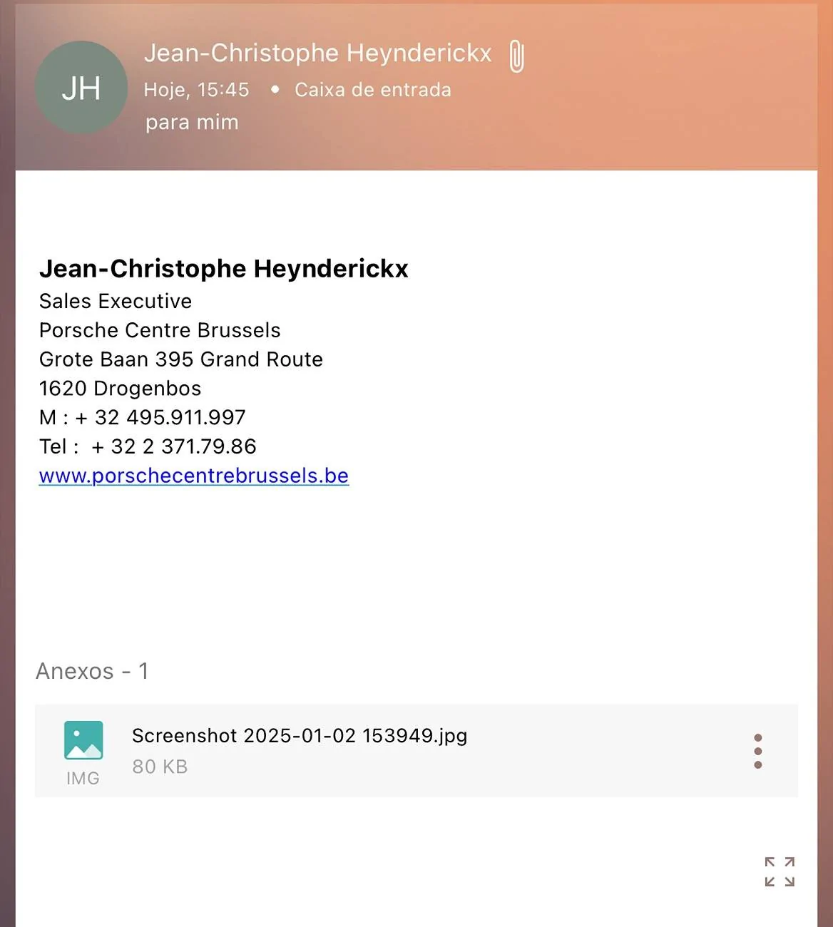

Today I contacted the porche center in belgium in brussels where my car was purchased by the previous owner, this was just because it didn't sit well with the fact that the porche center in poland commented that the car had no service history at porche, in fact I didn't want to get the story straight! So I come here to report this situation, which is still worrying
I contacted the Porsche center in Brussels, where I was assisted by Mr. Jean Christophe, Sales Executive. I explained what happened at the Porsche center in Poland, where I was informed that the vehicle had no maintenance history at official Porsche centers. This information surprised me, as I expected transparency about the car's history.
After explaining the situation, Mr. Jean Christophe promptly checked the system and confirmed that the vehicle, in fact, has a maintenance history at Porsche in Brussels. Additionally, he has identified that there are outstanding services that must be completed at no cost to me, even if the vehicle is no longer covered under warranty. These pending services may even be related to the warning lights that appeared on the instrument panel.
And he informed me that the last service done on the car was the high voltage dc/dc converter…..!
However, I was informed that I could not obtain the full service history without permission from the previous owner, which is understandable. To resolve this issue, I was suggested to contact the previous owner to try to obtain this authorization so that they could then give me access to the car's service history.
I would also like to point out that, according to Mr. Jean Christophe, outstanding services can and should be completed at any authorized Porsche center, whether in Belgium, Poland or any other country. Therefore, if the center in Poland refuses to carry out the work, I was suggested to contact another official Porsche representative in Poland and also mentioned that the attitude and procedure of the proche center in Poland is very strange.
Furthermore, Mr Jeab also cannot understand why the Porsche center in Poland did not identify the vehicle's history in the system immediately! And he assured me that any official Porsche center is obliged to complete outstanding services to be carried out at the in the vehicle where the vehicle is currently located, as confirmed by the representative in Brussels.
Otherwise this official porche center refuses again to carry out these unfinished services, they in Brussels will give me guidance on how to proceed to transfer the service to another authorized center, ensuring that the problem is resolved as quickly as possible.

If you register for the Porsche app, you will be required to provide proof of ownership of your car, in the UK that is by providing a copy of the registration document details in your name.
After that there should be no requirement to involve the previous owner.
The screenshot of the Battery service will be available to you in the PPN account when it is approved.
The battery service should have been flagged by the dealer you took your car to, it is also accompanied by a letter to you once Porshe know you are the car owner.
There are several levels of outcome from the battery recall including a software update to the battery management system due in the first 1/4 2025.
The battery check is free, all you have to do is book the car in at the local dealer. Be aware that there are significant delays in getting battery modules replaced since they have toremove the 800V battery to modify it if that is required.
