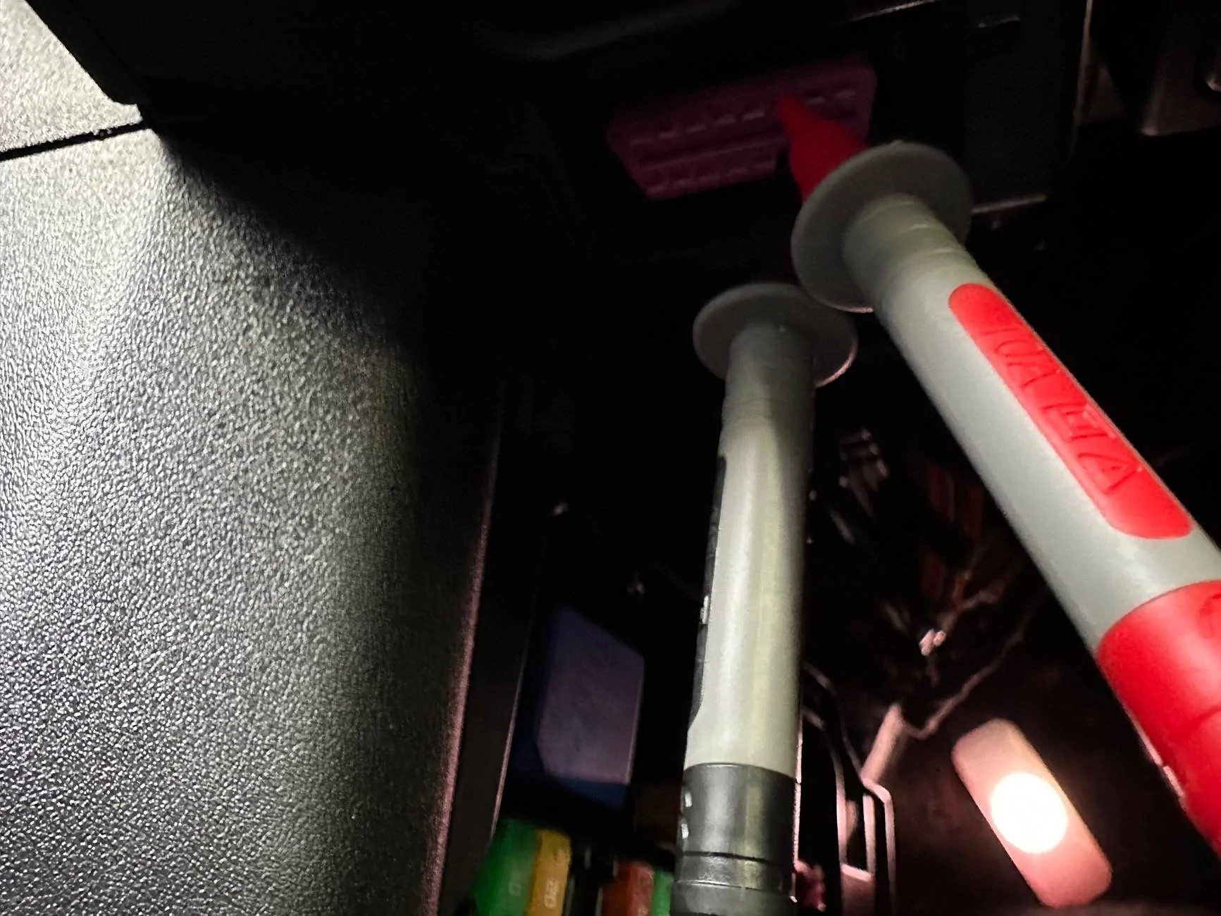

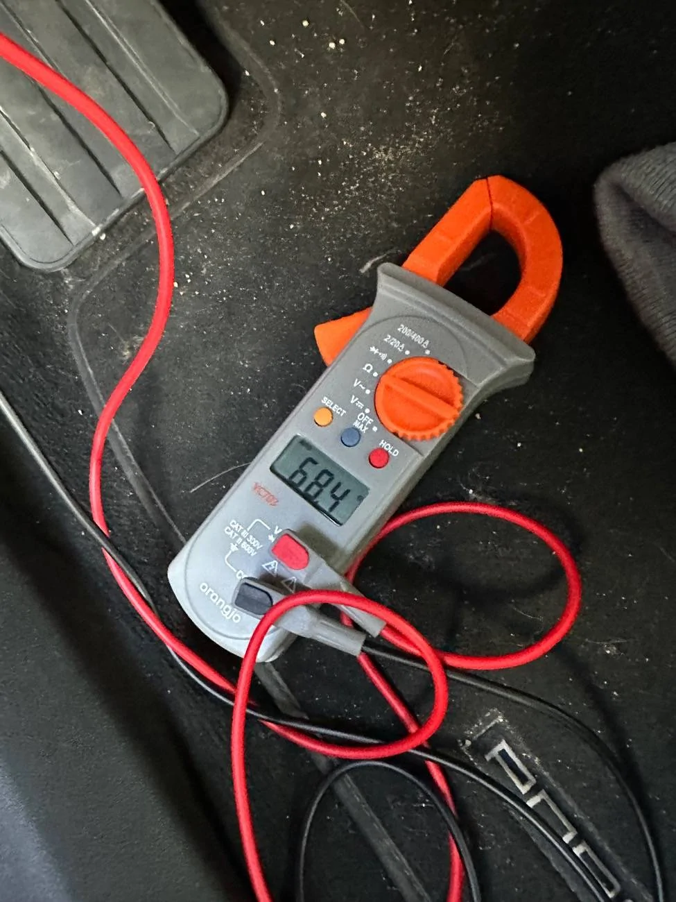

Today I was doing some tests on the car's OBD port. I started by checking the resistance of pin 6 can bus high and pin 14 Can bus low. My value is within the values 68.4 oms. I leave a photo below.
Porsche Taycan Piwi diagnostic program for Porche Taykan IMG_9003
Porsche Taycan Piwi diagnostic program for Porche Taykan IMG_9004

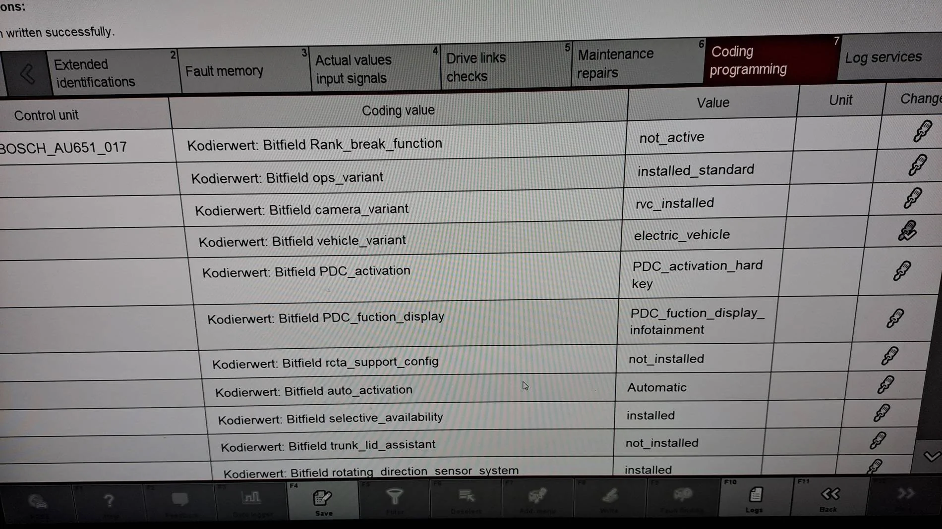

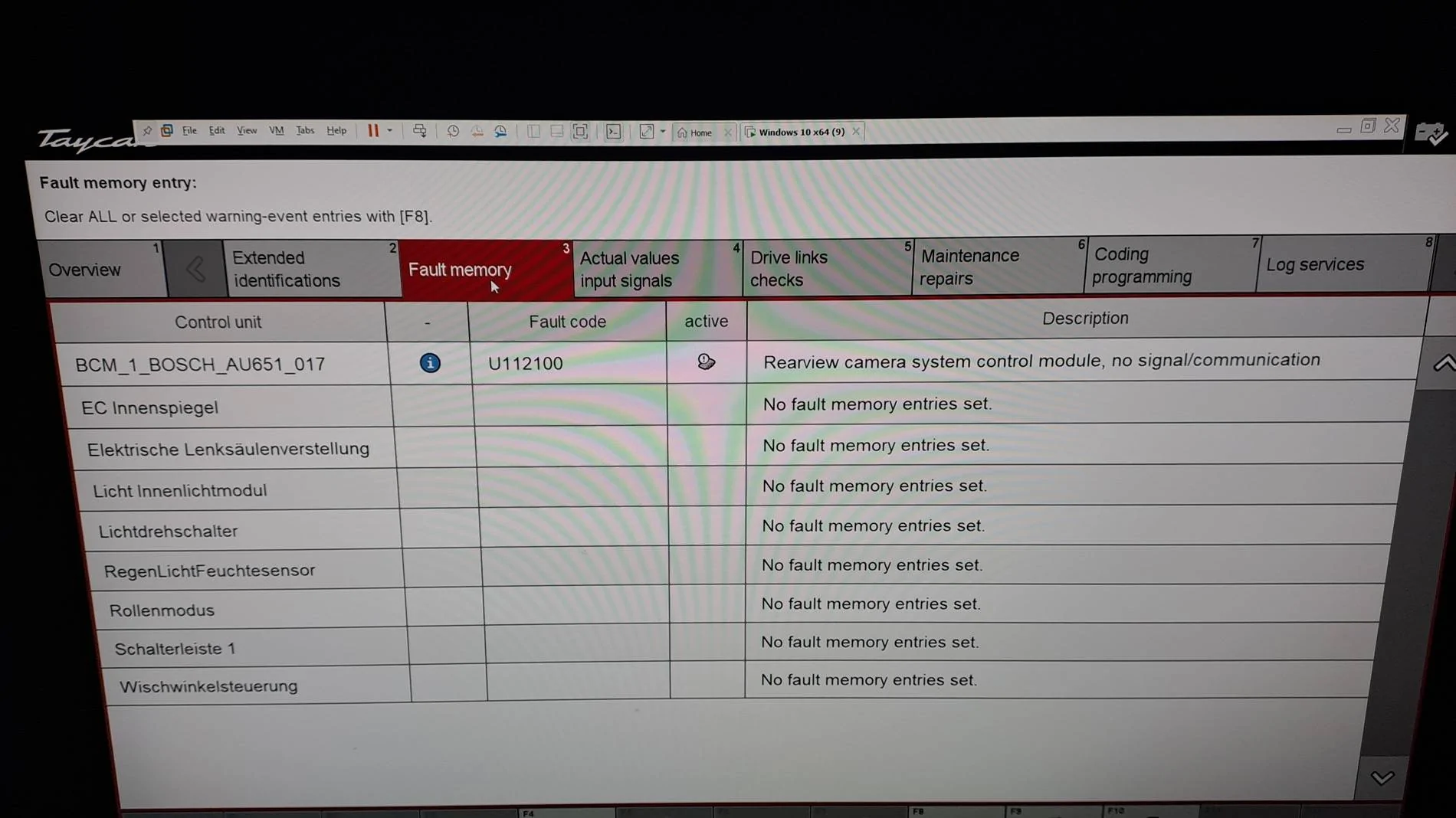

anybody familiar with coding for a reverse camera?
I have some aftermarket camera that suddenly stopped working, only getting the sensors overlay.
Car went through some PCM updates at the dealer, thinking maybe codes have been restored to factory defaults.
It seems like I only found something camera related in the BCM1 module? Seems strange because that's the module for the front electronics, thought BCM2 handles everything in the back?
When I select rvc_installed, I instantly get an error code
Been changing coding, save it, then jump in the car to see if the camera comes up when putting it in reverse ... not sure if changes show up instantly or that the car needs to be locked/sit for 5 minutes for everything to restart.
Wanted to ask if it's indeed only that one setting in BCM1 that needs to be toggled to rvc_installed, or if there is also another module that needs some coding? (maybe "gateway", but couldn't find anything obvious there?)

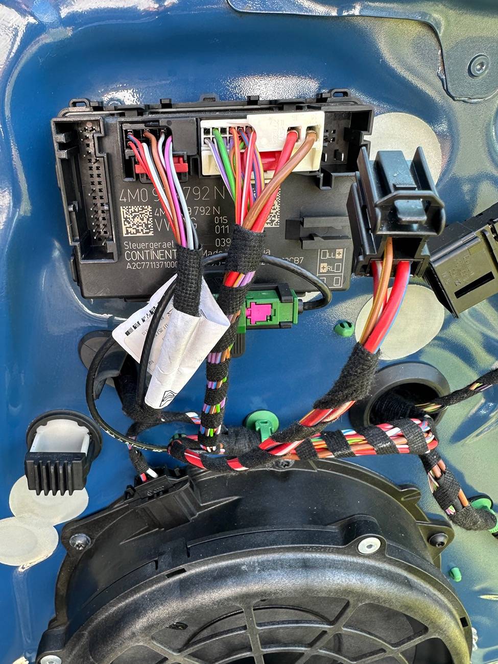

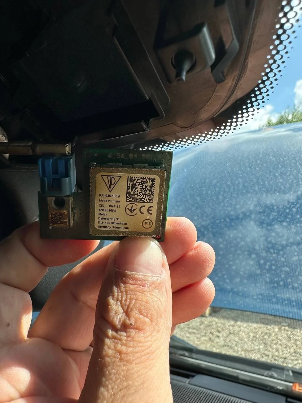

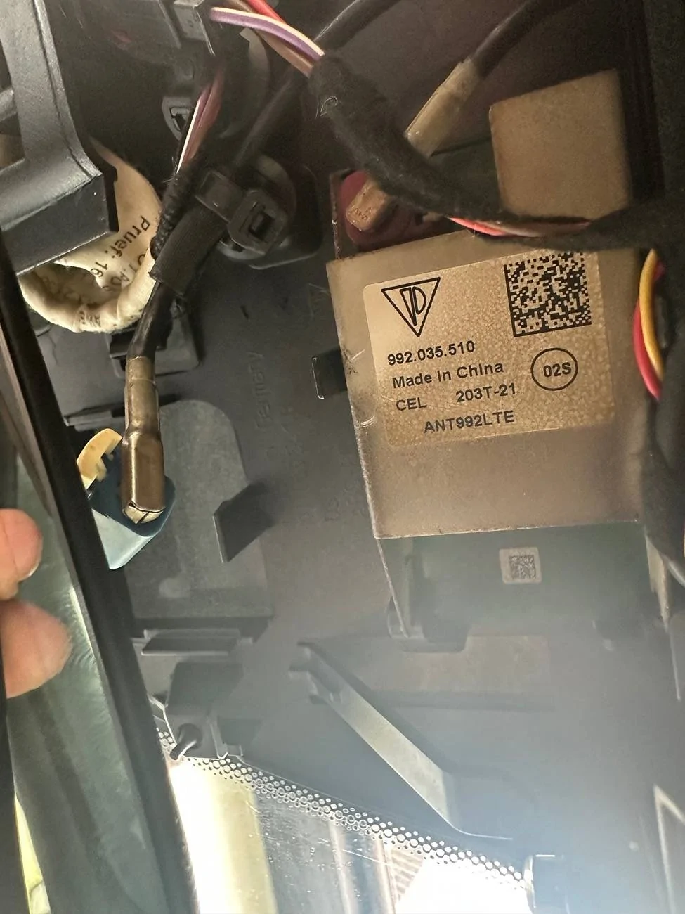

Good afternoon everyone, I just want to give an update here regarding my car, I changed the door module and the passenger door situation was definitively resolved, as well as changing the GPS antenna which solved my location problem and changing the cell antenna (LTE) which solved my access to the input of my access to my account in the PCM
I would like to extend my sincere thanks to all the members of the Porsche Taycan Forum.
After a lot of hard work, everything is finally sorted out with the car — it is legal, passed the inspection without any problems and is working perfectly. It was a long and demanding process, but in the end it was worth every effort.
I would like to thank from the bottom of my heart everyone who, in some way, supported me with advice and shared their experiences throughout this journey. A very special thanks to Whitex and Chung, for their patience, understanding and the lessons they taught me — they made all the difference.
Once again, my sincere thanks to the entire community. Without your support, it would not have been possible to get this far.
