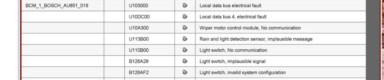

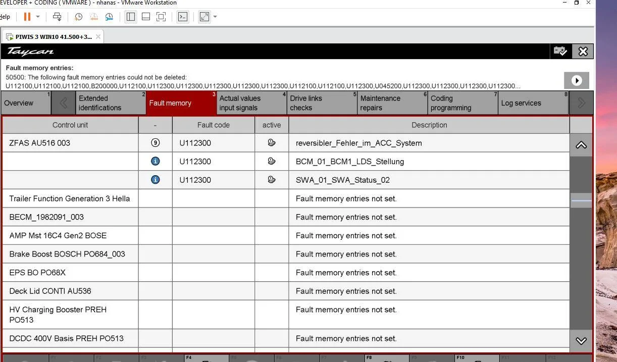

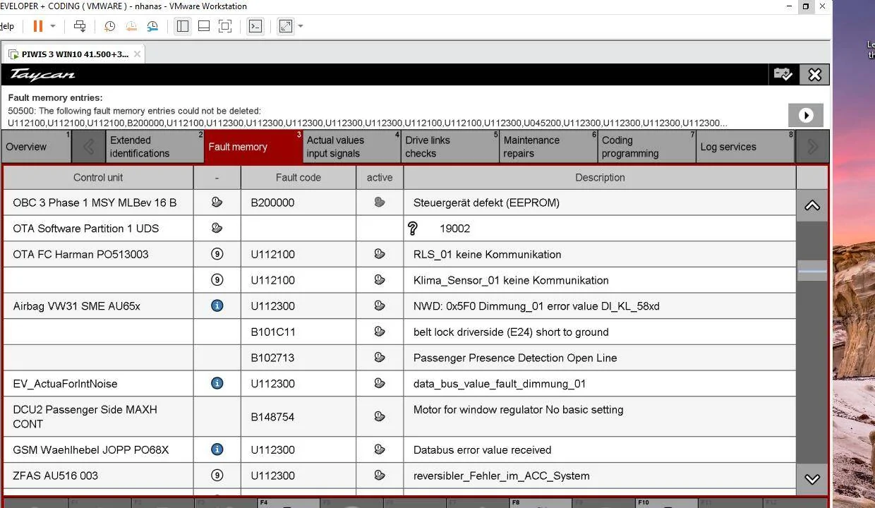

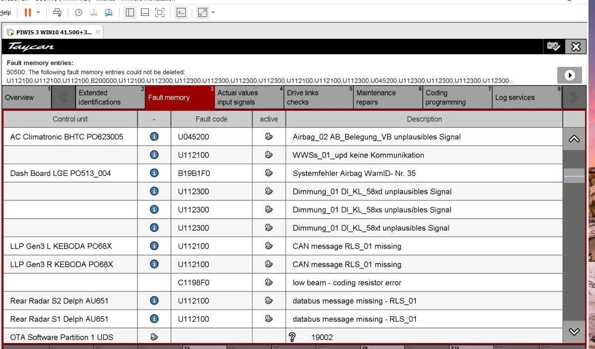

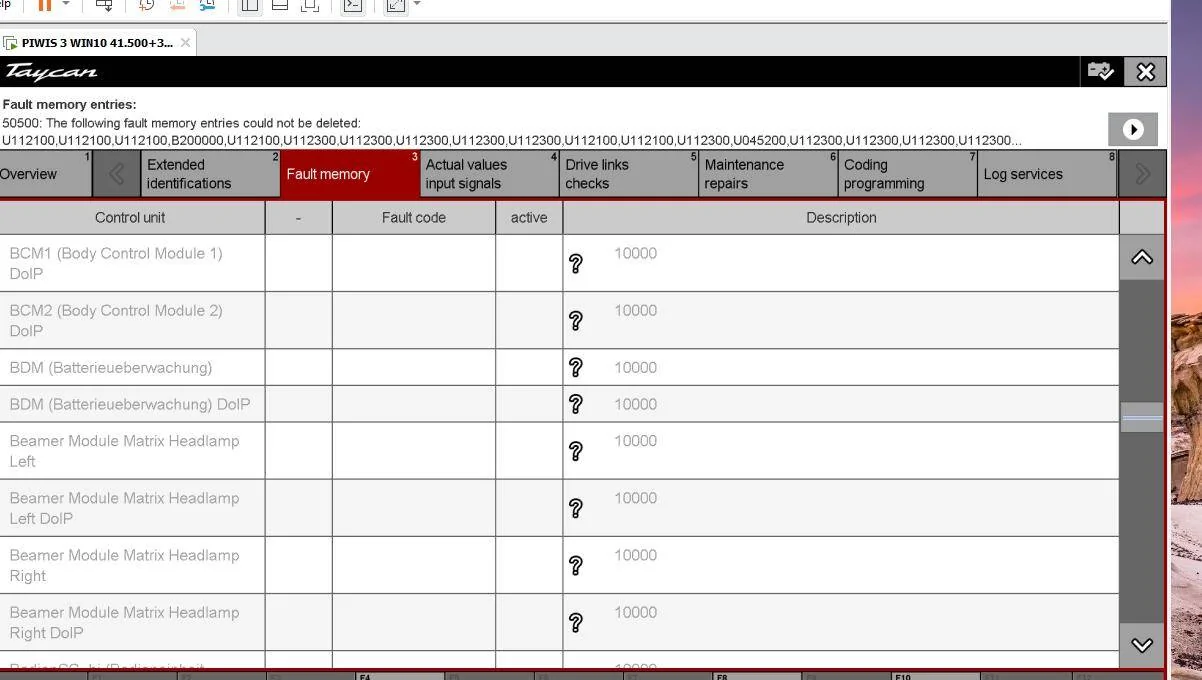

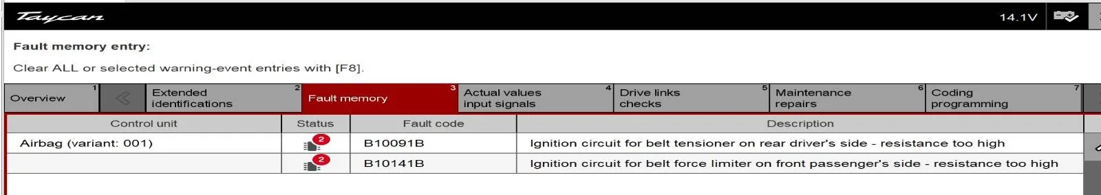

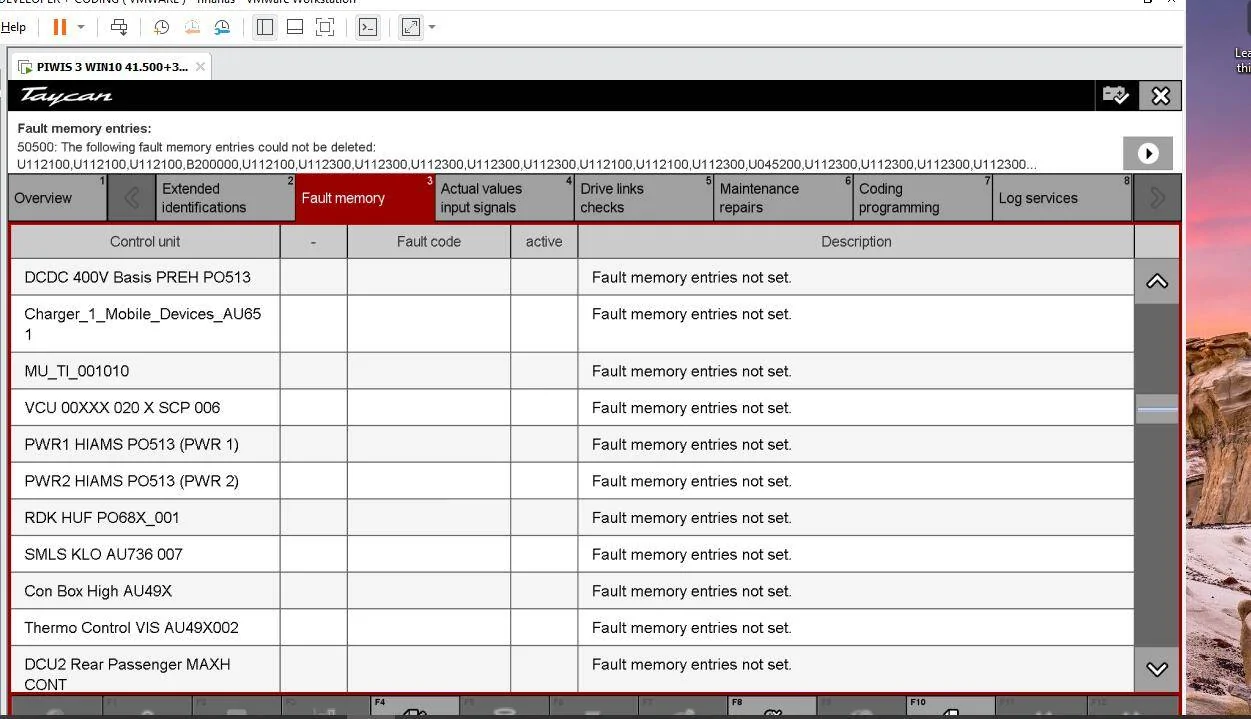

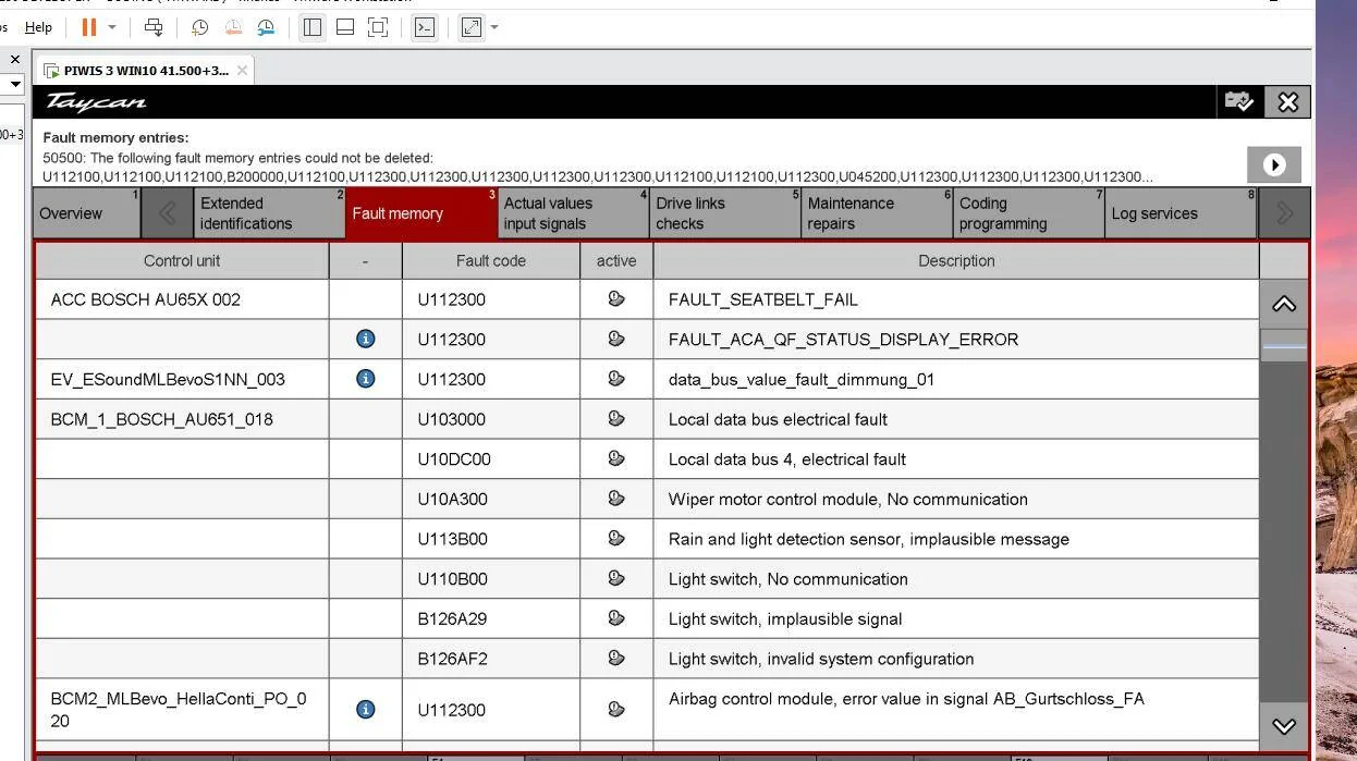

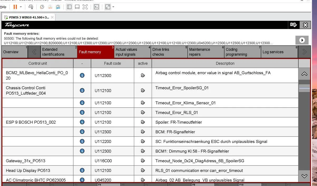

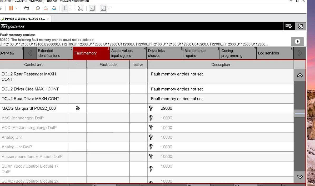

Hi Shug and white ,I apologize for not being able to publish the errors here today, because I previously missed a plane in Copenhagen which delayed the publication of the diagnosis a little….I think the images are good this way?,After deleting the errors, these were the entries that remained!!!

Carlos,
There seems to be only one Gateway error, the error code U116C00 isn't telling me much when I google it.
Porsche Taycan Piwi diagnostic program for Porche Taykan 1737561014761-7c
I would have a go at Automatic coding on that error if it will allow.
If that is an option check for errors again after the Automatic coding.
After that it would be the BCM errors to look at, unless of course you can see a higher error to try?

yes I also couldn't find anything related to this error...!! Ok can you give me instructions on how I can move forward with auromatic coding for this error... after finishing the automatic coding on this error I will do an error diagnosis again, to see if it resolved or not? if it continues! yes most of the errors here are associated with the BCM1 module

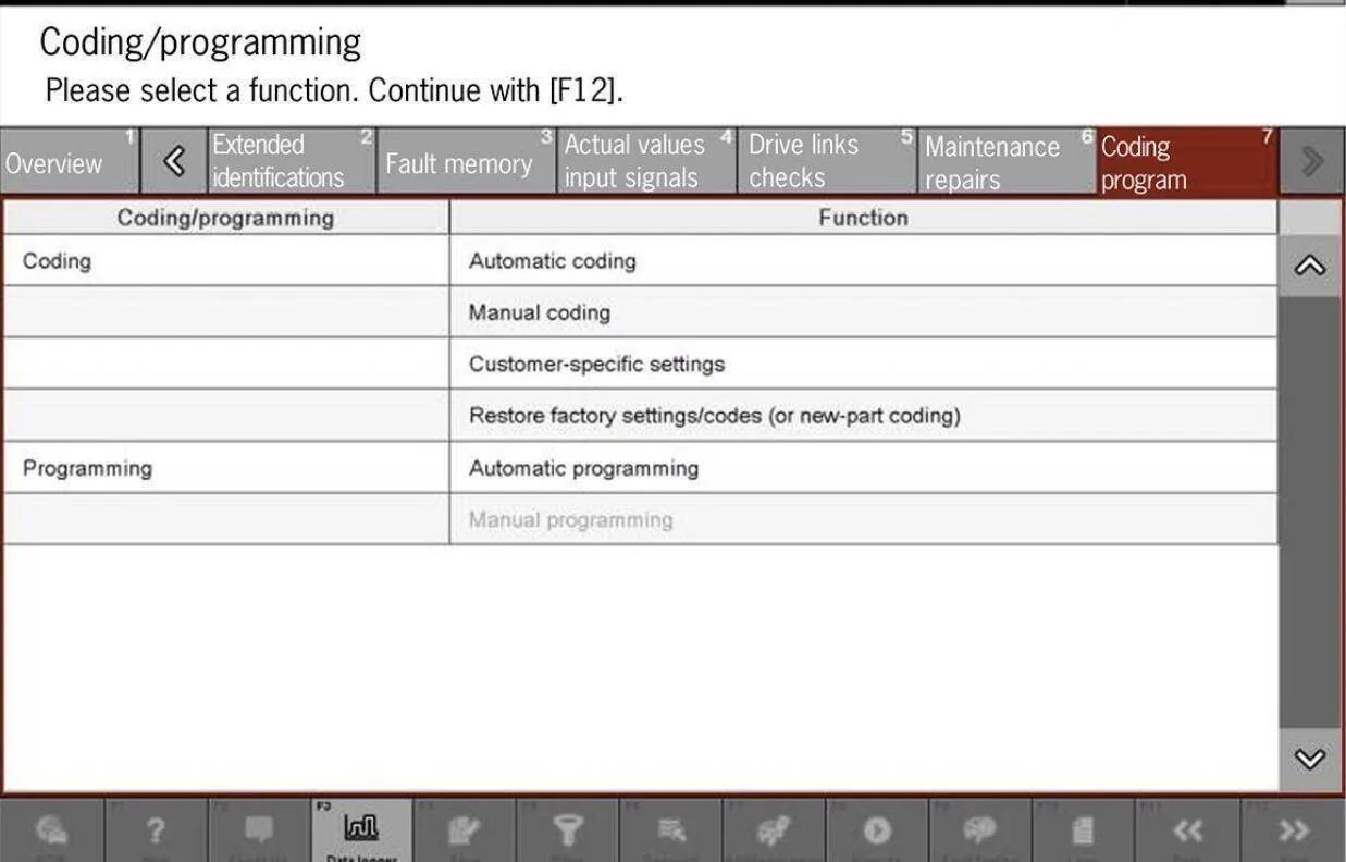

Highlight the error you want to work on, select the coding program tab, select Automatic coding then it will be F12 from memory

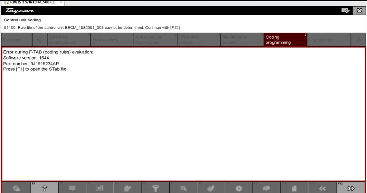

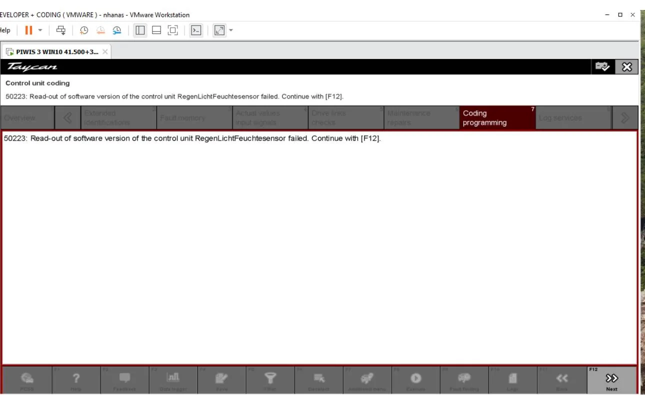

I did the error diagnosis again, deleted the errors and in the entries I selected the Gatweay error and clicked on program coding, selected automatic coding and then F12 from memory and the result it gave me was this one that I leave the screen shots, I couldn't continue with the automatic coding …. Could there be a way for this to not give an error?...probably by going straight to the gatweay module in the first one in extendent edentifications and selecting gatweay and automatically coding the module instead of just doing it on error...

Am guessing that is not the fault that needs corrected Carlos.
The message tells you that PIWIS could not read the Gateway.
Suggest you try the BMS faults until you find whatever is causing the issues.
Once the actual fault is found, the rest of the errors will hopefully disappear at the same time.

So you suggest I start with the BSM errors and do automatic coding one by one… is that it???
Porsche Taycan Piwi diagnostic program for Porche Taykan IMG_8749

Yup,
Just have to try whichever one looks like it might be more suspect.
Automatic coding just reprograms the units with the correct programme, so if it is not broken, you will see no differences.
Working your way through them should get you to the broken one and any linked errors will then disappear.

ok it seems interesting to me and it also seems like a good way to get to the error, so instead of going from error to error I could try to do automatic coding in the entire module….??? In this case BSM 1
