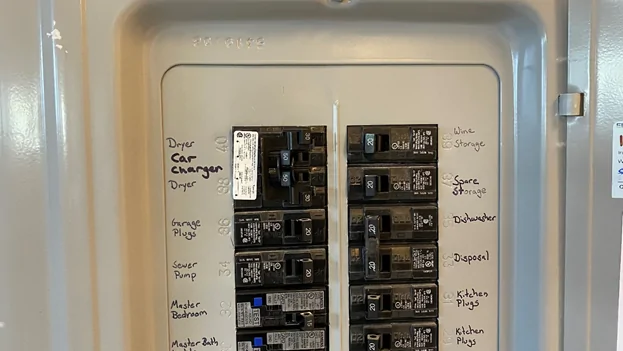

The charging circuit that follows is the solution for our garage. We have a 40-slot Siemens electrical panel with all slots filled. Thanks to Siemens, a 50A / 30A quad tandem circuit breaker was available that only used two slots. The two 30A slots for the dryer were replaced with the new breaker – two 30A breakers on the outside (for the existing dryer) and two 50A breakers in the middle (for the car charger). As a bonus, the electrician only had to add “car charger” between the previous “dryer” labels to relabel the panel.

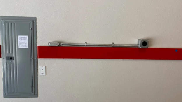

Wire from the panel to the receptacle is 3 ea. #6-gauge THHN wires inside ¾” metallic conduit. THHN wire is rated for 90C temperature and for damp or dry applications. Metallic conduit lowers the temperature of the enclosed wire (compared to a sheath) and protects the surroundings from heat and potential electrical interference. Our circuit wire run is 8 feet of flexible metal conduit inside the walls plus 4 feet of rigid metal conduit. You can run up to 4 ea. #6-gauge THHN wires in ¾” metal conduit (3 for NEMA 6-50R and 4 for NEMA 14-50R receptacles). If your run is greater than 50 feet, strongly consider using #4-gauge THHN wire in 1” metal conduit (3 or 4 #4-gauge wires are ok in 1” metal conduit). 50A circuit breakers and receptacles will not accept larger than #4-gauge wire.

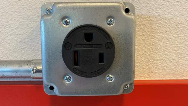

Hubbell 6-50R
Hubbell is my favorite receptacle brand: typically, one-piece low-resistance construction, strong, and tight grip but easy to use (good material and exact dimensions). Our circuit use a Hubbell 6-50R receptacle, chosen because the three-wire circuit reduces heat inside a conduit and is more flexible outside a conduit. The Porsche default 14-50P plug needs a 14-50R receptacle (which needs a four-wire circuit). Determine where you want your charger before you locate your receptacle. And most importantly, where do you want the ground pin: top or bottom? Our electrician left enough wire at the Hubbell 6-50 receptacle to disassemble and rotate the receptacle. With the Porsche Charging Dock (optional, not the Porsche Mobile Charger that comes with the Taycan), the ground pin must be at the bottom – the opposite of a normal installation.

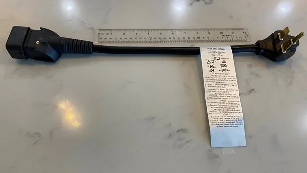

Porsche NEMA 6-30 supply cable (our spare for emergency road kit)
This 30A supply cable is rated for 24A continuous current, but, if you look carefully, the cable tag is only rated for 16A – it may be a tag error or a lower current specified to minimize heat. (Note the 300 mm specified length is measured between the stress release moldings and the ground pin is far right, away from the end the cable, the normal ground pin location):
