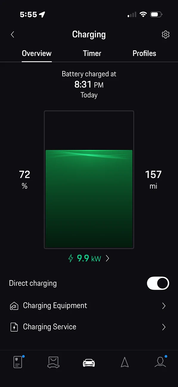

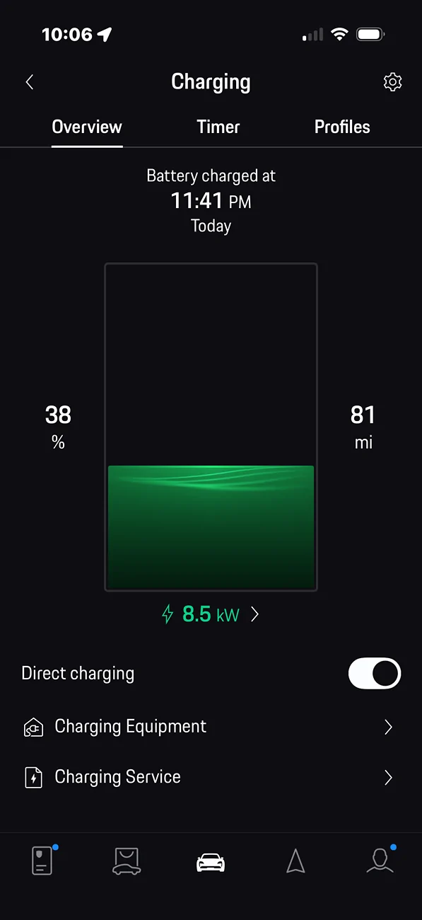

Update: I have been monitoring my charging rate since I joined this conversation. I noticed last night that my rate was a little lower this time.
So in the last 30ish days or so, I have gone from 10.5 to 9.9 and now 8.5 😳
Porsche if you are listening, we need to talk!!!!!!

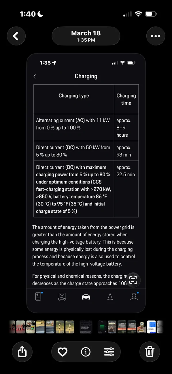

Not sure how many of you use the My Porsche App and know about the "garage" tab (upper right corner on my version of the app where you see an icon of a car in a garage) but I noticed today that Porsche has finally cleansed my car's charging specifications to eliminate the reference to the 11 kW OBC and replace it with the 9.6 kW OBC.
If you want to preserve that "evidence" and your app still tells you about that spec, screenshot it.
I am in litigation with Porsche Canada using the CAMVAP system and had flagged a whole series of places in the Canadian setting which established my car's 11 kW charging abilities. The litigation started 3 months ago or so. The Porsche Canadian inventory tools were also flagged by me and every 2025 and most 2026 Taycans had reference to "charging at home" at 11 kW from zero to a full charge within 11 hours, as well as vehicle specs that referenced the 11 kW OBC.
Cannot be sure it's because of my claim against them but at last this all appears to be cleaned up too.
Based on this suggestion previously, I did a screen shot on March 18th. See below. Now the specs are reformatted and only make reference to 9.6Kw.

after the update, car shows 8.5 kWs. Odd thing is, my Chargepoint show 9.2/9.3. (i'm on a 50/40 amp circuit). Guessing Chargepoint also shows the delivery speed.
87
8,255
7,271
Neh, the AC voltage is just lower, probably ~232V instead of 240V. Could be losses in the cable to the Chargepoint, or could me mains to your house are a bit lower when everyone is charging their vehicles, or running air conditioners, ovens, heaters, who knows. Some EVSE's will show you the voltage, not sure if Chargepoint does.
