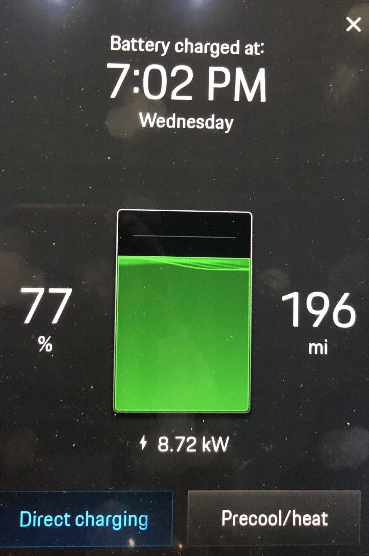

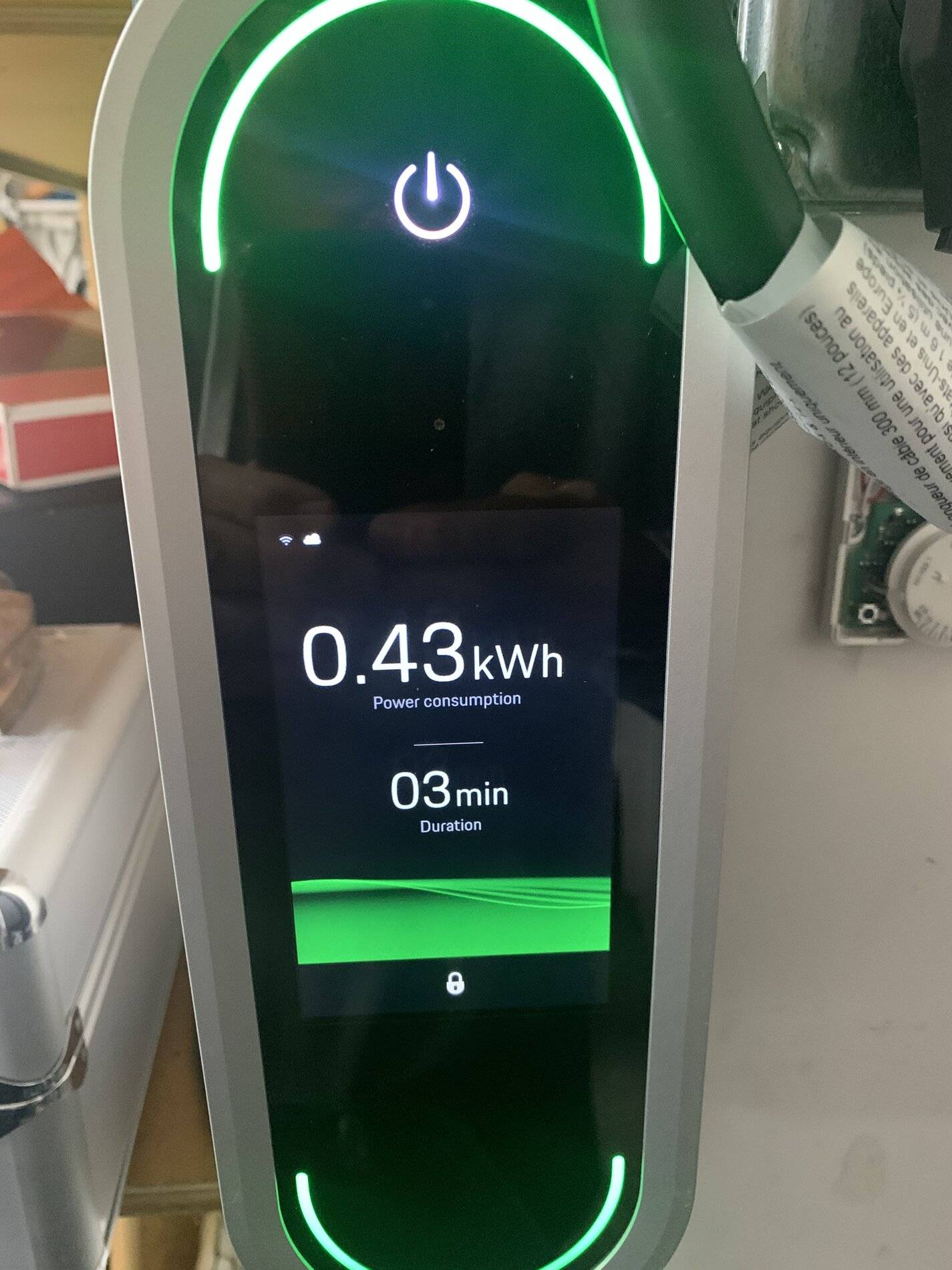

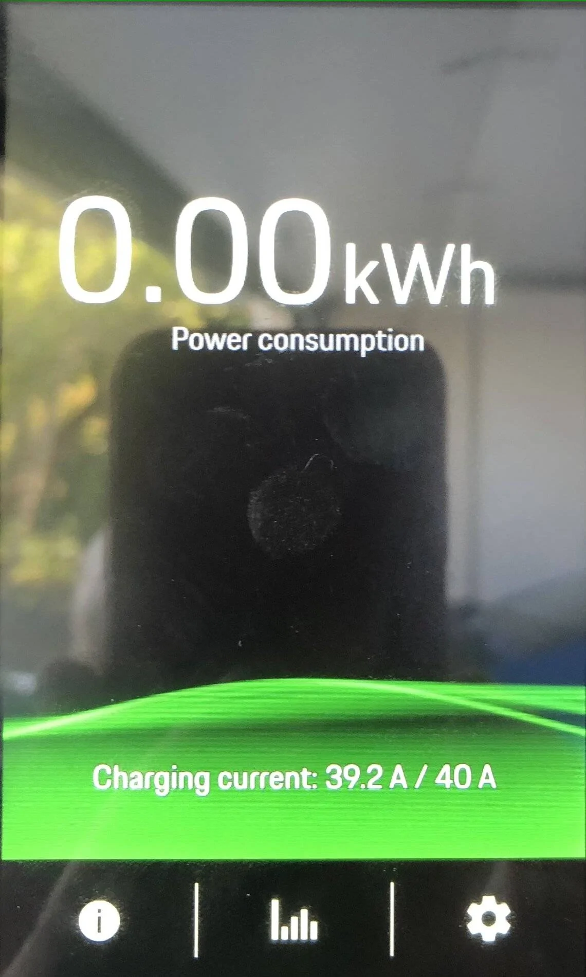

Thanks for the explanations, much more clear! I agree that the PMCC should say "power consumed", not "power consumption". I'm not totally clueless about this stuff, I'm actually developing my own power monitoring device. But the language in the Porsche docs had me totally confused. Very helpful also to be able to switch to the kW number from the "mi/min" number. I didn't know about that, thanks. So it's saying I'm burning 7.9 kw.

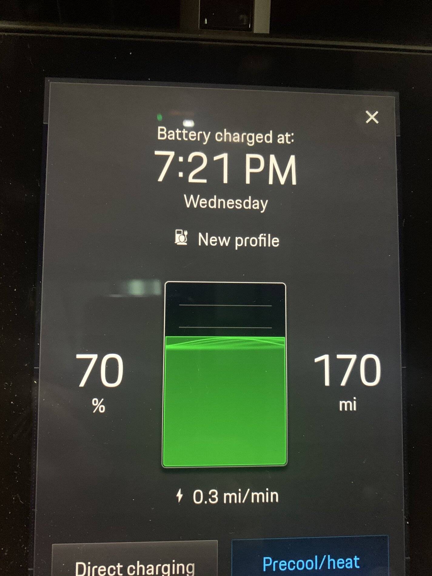

Part of my confusion is that I thought that you could fully charge the car from empty overnight. Not really, at .3 miles/minute. But I guess it charges a lot faster in the beginning.
193
7,033
10,519
7.9 kw is the charge rate you're seeing
so 83.4 kWh / 7.9 kW = 10.55 hours for a full charge from empty - call it 11 hours with overhead…

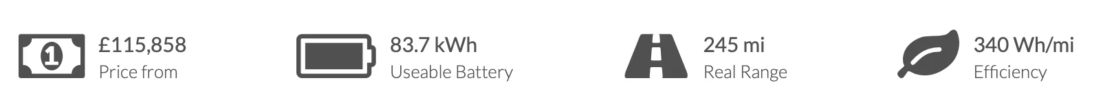

83.4? Don't you mean 93.4?
193
7,033
10,519
83.4 is what is "usable" the other is reserved by Porsche…0% battery is not really 0% - it's the lowest amount the Battery Management System (BMS) allows - so it's reasonable to assume that 0% represents 83.7 kWh "consumed" cause the rest is resevered for battery longevity and Porsche's own use - so all you can ever "replace" while charging is what you were allowed to consume - which is 83.7 kWh.

I also thinking a sub-optimal German to English translation isn't helping here…
the text is:
I'm going to humbly suggest the following text would be more precise
it's not consumption at this moment - it's how much power has been consumed so far…
