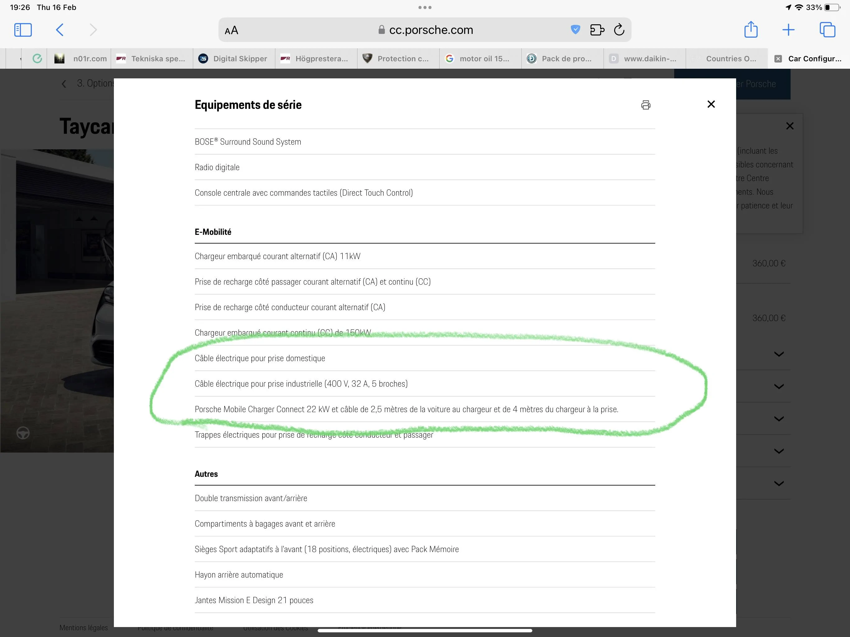

I'm getting ready for deivery of my Taycan. My electrician has install 5G10 cable and this is too big for a 16A 3 Phase socket. Numpty. So the question is can I buy a 32A 3 phase power lead. As you probably know 3 phase sockets come in 2 sizes. I thought I has seen a 16A and 32A power lead on the configurator but now only the 16A power lead is there. I'm in France.
I don't need 32A 3 Phase as I have no spec'd a 22 KW on board charger so I can only ever charge at 11 KW.

That is standard equipment here in France and the PMCC should come with both a domestic plug as well as the 32 amp 5 pin plug. See spec sheet!
That's what I thought but it is missing off the configurator. So I've left a message with Porsche Limoges to see if there are supply issues. I'm thinking I should just get the 32a lead and let them fit the bigger sockets.
