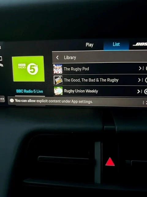

Attached is the error message displayed - despite having no restrictions on my AppleID and iPhone/iPad play fine - in the example it's "The Rugby Pod" that has the Explicit rating.

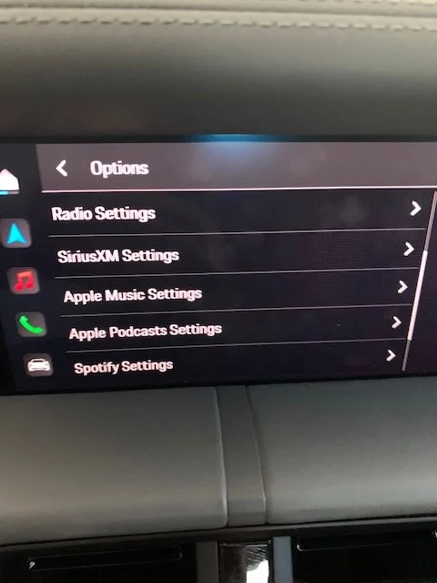

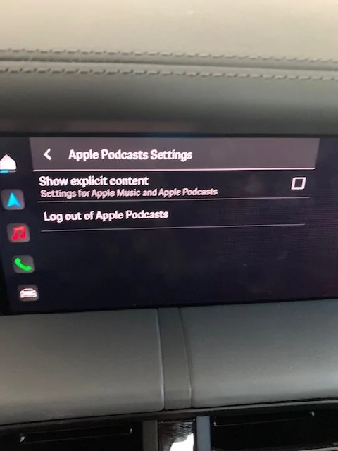

This is how it looks like in my US-spec Taycan (post-uPdate). The first picture shows the Settings menu when you click the three dots on the Podcasts screen. The second picture shows what you see when you click Apple Podcasts Settings, iincluding the explicit content box. Have you had the uPdate yet?

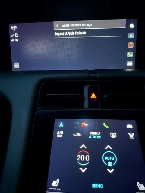

Sorry to dig up an old thread, but I am in the UK and have the same issue.
No option other than to log out shows in the settings.
Did you find a fix?

I've had this same problem for a year now and finally solved it. I had to log out of apple podcasts, re-authenticated; it still wouldn't show the option to allow explicit content. Then I signed in with Apple Music and finally it showed a combined option to allow explicit content for both Apple Music and podcasts.
Hope someone else finds this helpful.

Experiencing this exact problem. No option to untick!!
Can't play an "explicit" podcast and no tickbox to allow it either.
Don't have Apple Music to log in with....

Could you sign up for an Apple Music free trial? Or sign up for a month, then cancel? Crappy, but might work around it for you.

Tried that but I used to have it years ago so they aren't giving a free trial. Ho hum. Will just buy a month and sort it out but Porsche should fix it.
EDIT: phone offered a free trial. So did that. Linked PCM in the MyPorsche App. Went out to the car and hit the three dots and there it was. Ticked it and everything works now.
Just remember to cancel at the end of the free trial.
