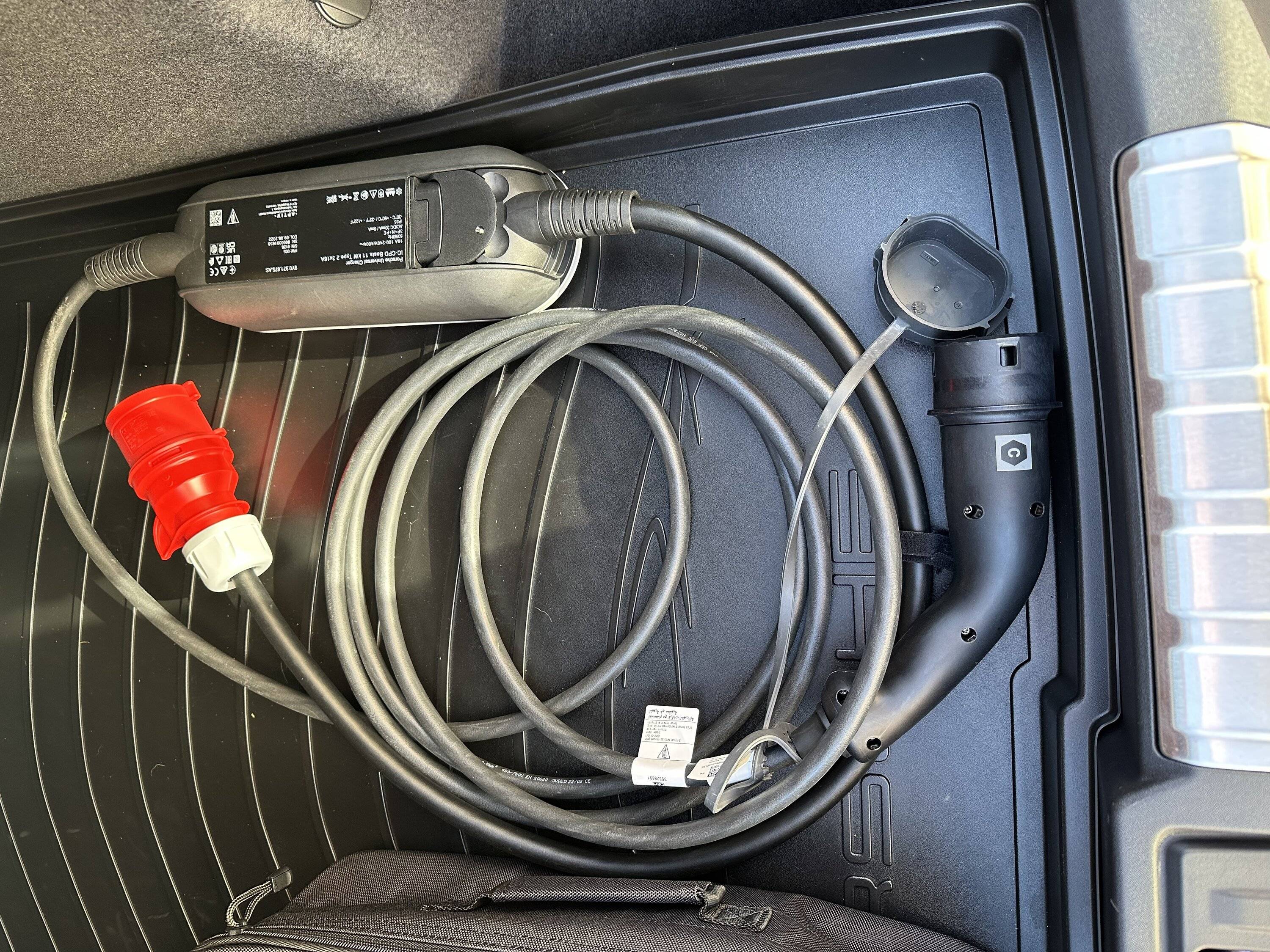

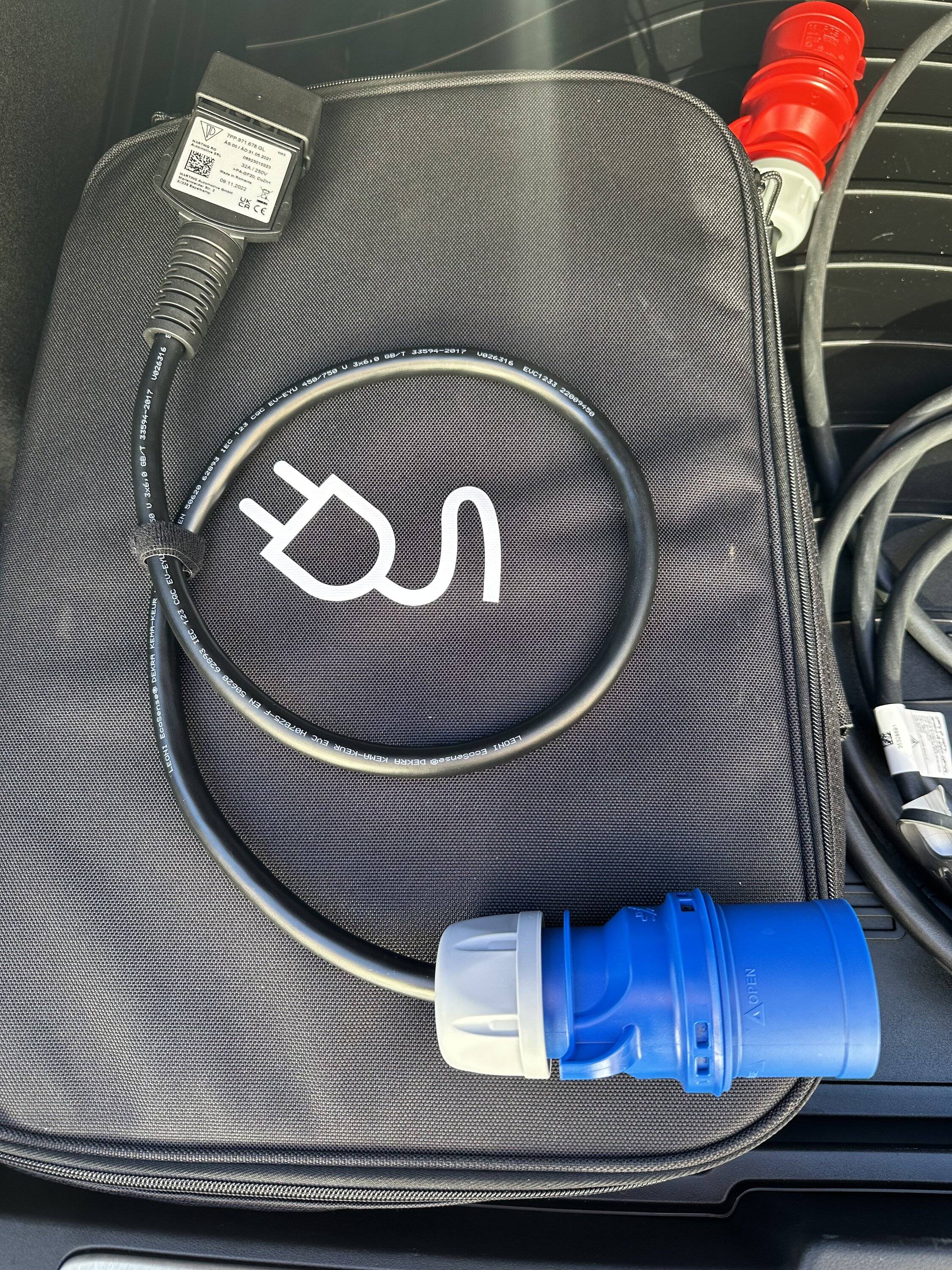

Hi Tom,
You could simply buy a 16a Porsche cable to plug into your EVSE charger, no problems to worry about,
i just bought a 32a Blue single phase one to interchange with the 32a 3 phase one I spec’d with my car.
You simply need a 16a one…… just cost me £106 all in from dealers ??

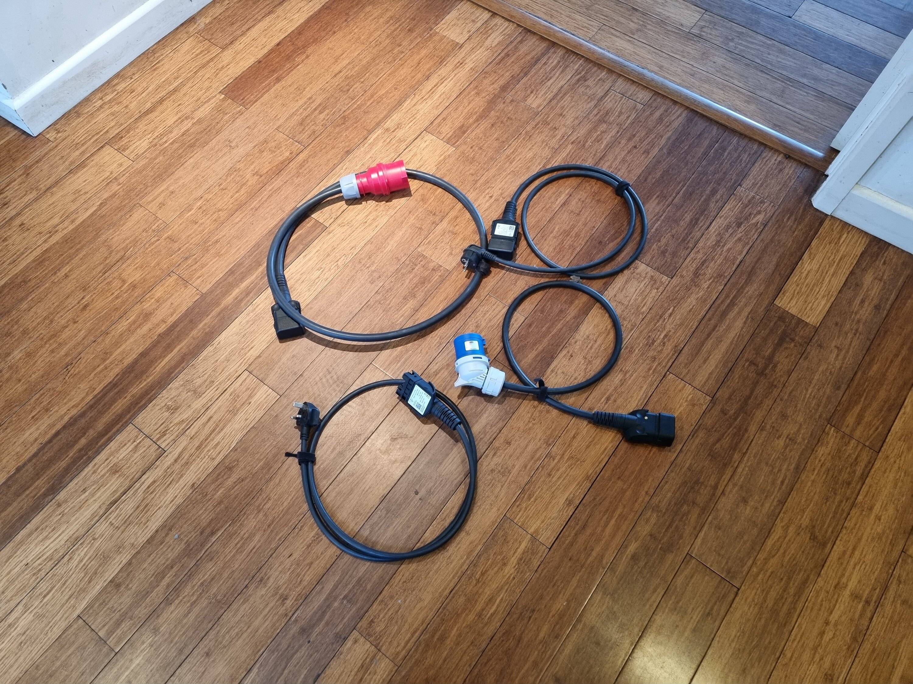

argh - I didn't realise it was that simple. I have been lost in a maze of German and Lativian VAG spares sites.
I will call them tomorrow.
I am building a nice collection of these adapters. It's like an adult game of collectables.

Adding a 16A socket will reduce the power from 7.4kW to around 3.6kW - it must be 32A end to end.
