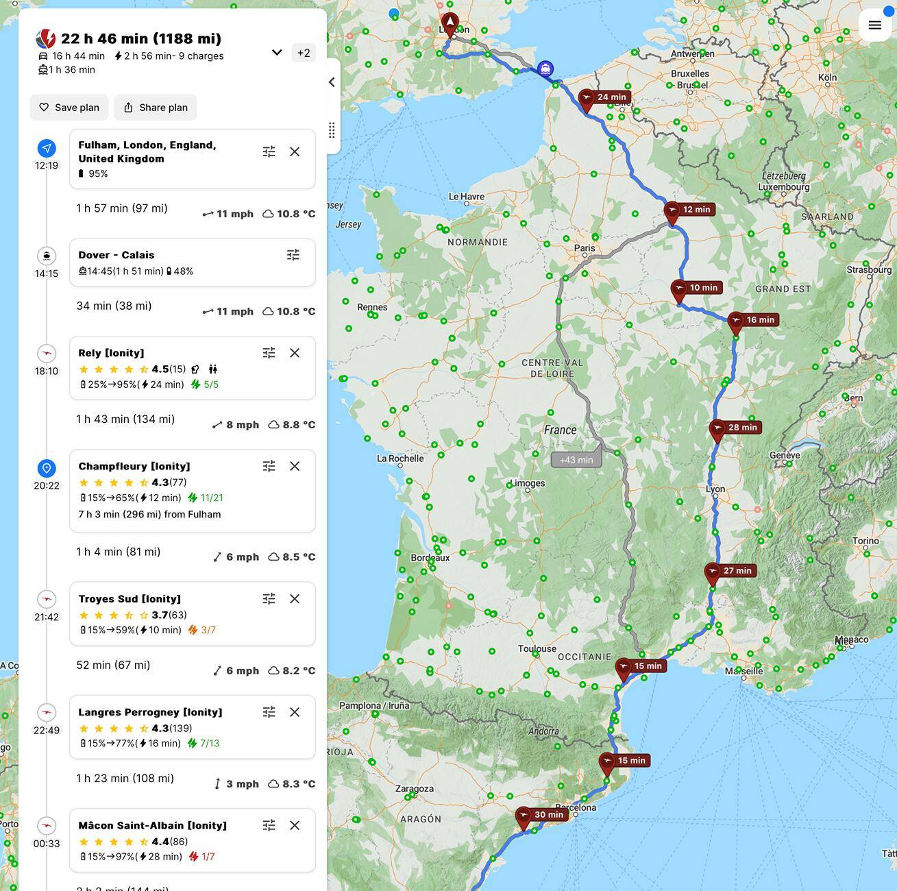

The built-in planner is OK, and fine for day-to-day driving, but I do all my European trips with A Better Route Planner. Much more sophisticated than the Porsche planner. Takes a little while to learn but it is very customisable - you can tell it how fast you typically go (eg 5% above or indeed below speed limit), how the car is loaded etc. It takes weather into account - in one extreme case of headwind, the Porsche planner was underestimating a journey by 30-40%! You can even make an online connection so it monitors your charge level. You can specify your favourite chargers eg mine is set to prefer Ionity and Fastned, with Tesla as an option (it will use all available networks as needed).
Then when I'm on the road I just pop the next stage from the ABRP plan into the satnav. If I stay longer, ABRP (on my phone) sees that I have a higher charge level and adjusts the plan.
ABRP will generate you a plan which by default optimises the travel time. You should almost never charge above 80-90%, and ABRP will run you down to about 20% so you get the fastest part of the charging curve.
A typical Euro trip will involve stopping for about 15 mins every 1.5-2 hours, or more frequently if you prefer. By coincidence this is what it says you should be doing as breaks, to keep safe, in the UK Highway Code. Ignore the range bores saying they need 500 miles of range - in practice I breeze across Europe with rarely more than 150 miles between stops, usually much less. Short breaks = safer driving (and empty bladders, full stomachs, stretched legs etc). And the Taycan has blindlngly fast charging if you get the right network at the right battery temp / charge level. In general - peak travel times and NL excepted - European highways have excellent charging infrastructure with plenty of 150kW+ chargers, and rarely at capacity.

Here is an illustration of an ABRP plan for London-Valencia -- not refined except to fix its violation of Rule 1 for Eurotrips, "don't go near Paris", by adding Ionity Champfleury as a stop. Overnight stops would of course give you a different plan.
For Spain of course there are other potential routes eg the Brittany ferries to Caen or Bilbao, depending on what your start point in the UK is. The slowest part of any Euro trip is the M25 :) although maybe when the EU fingerprinting checkpoint is installed the bottleneck might move to Folkestone...
