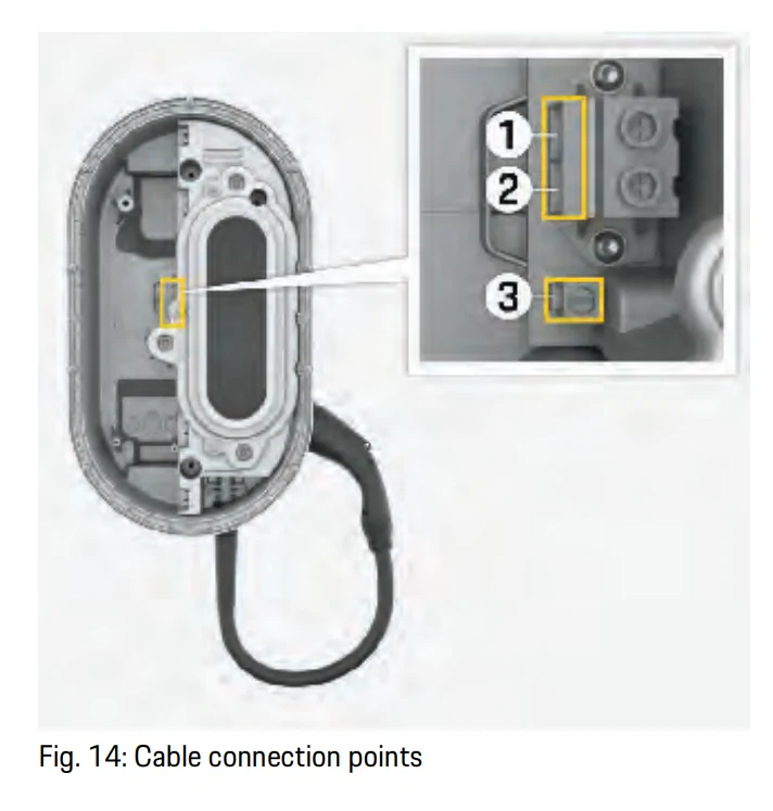

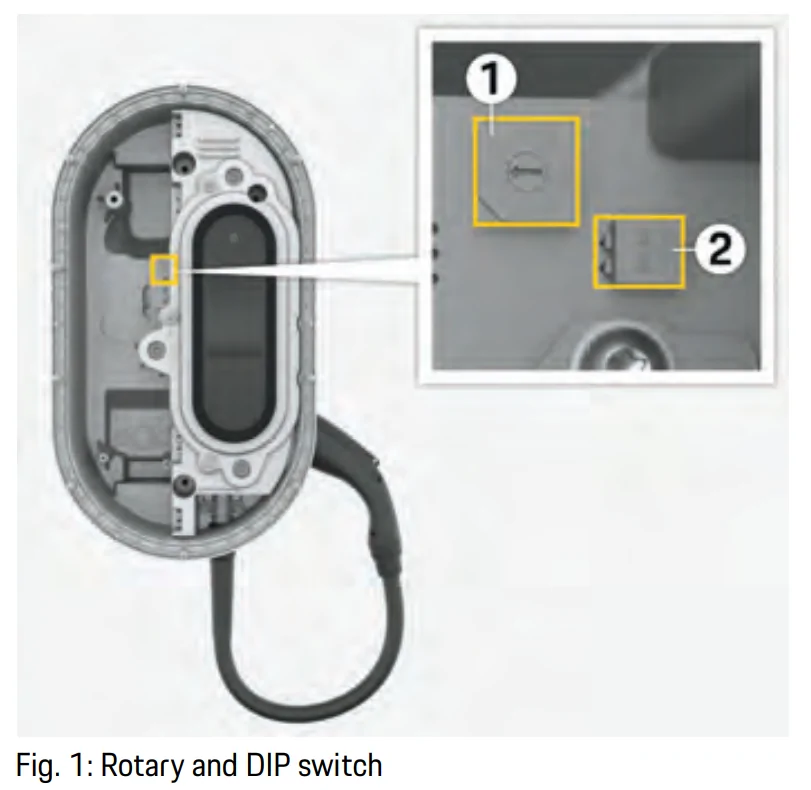

Looking at the manual for the wall charger, it uses 2 hots, and a ground wire (240 volt full phase), or one hot, one neutral and a ground (120 volt half phase).
There is a pair of DIP switches (labeled 2 in the photo) that configure the charger. First thing to check is to turn off the breaker to disconnect power, pop the cover and see if those switches are in the right configuration.
If 240 volt, switch 1 should be on, switch 2 should be off.
If 120 volt, both switches should be off.
Porsche Taycan Porsche Wall Charger Connect -- grounding error message 1687375654696
If you look at the wires coming in, in a 120 volt config, the black wire should be connected to the terminal marked 1, the white wire should be going to the terminal marked 2 and the green or bare copper wire should be going to the ground terminal 3.
If it's a 240 volt setup, you should see two black wires, or a black and red wire going to the 1 and 2 terminals. The ground 3 should still be green or bare copper. (It's possible that there's a wire with a white jacket connected to one of them but it should be marked as hot. That's done by marking the end of the insulating jacket with a black marker or wrapped with black electrical tape.)
Porsche Taycan Porsche Wall Charger Connect -- grounding error message 1687375564311
If the DIP switches are incorrect, or in a 120 volt system the hot and neutral are reversed, you'd potentially get the error message you've indicated.
The photos are from page 19 of the manual which can be found here:
