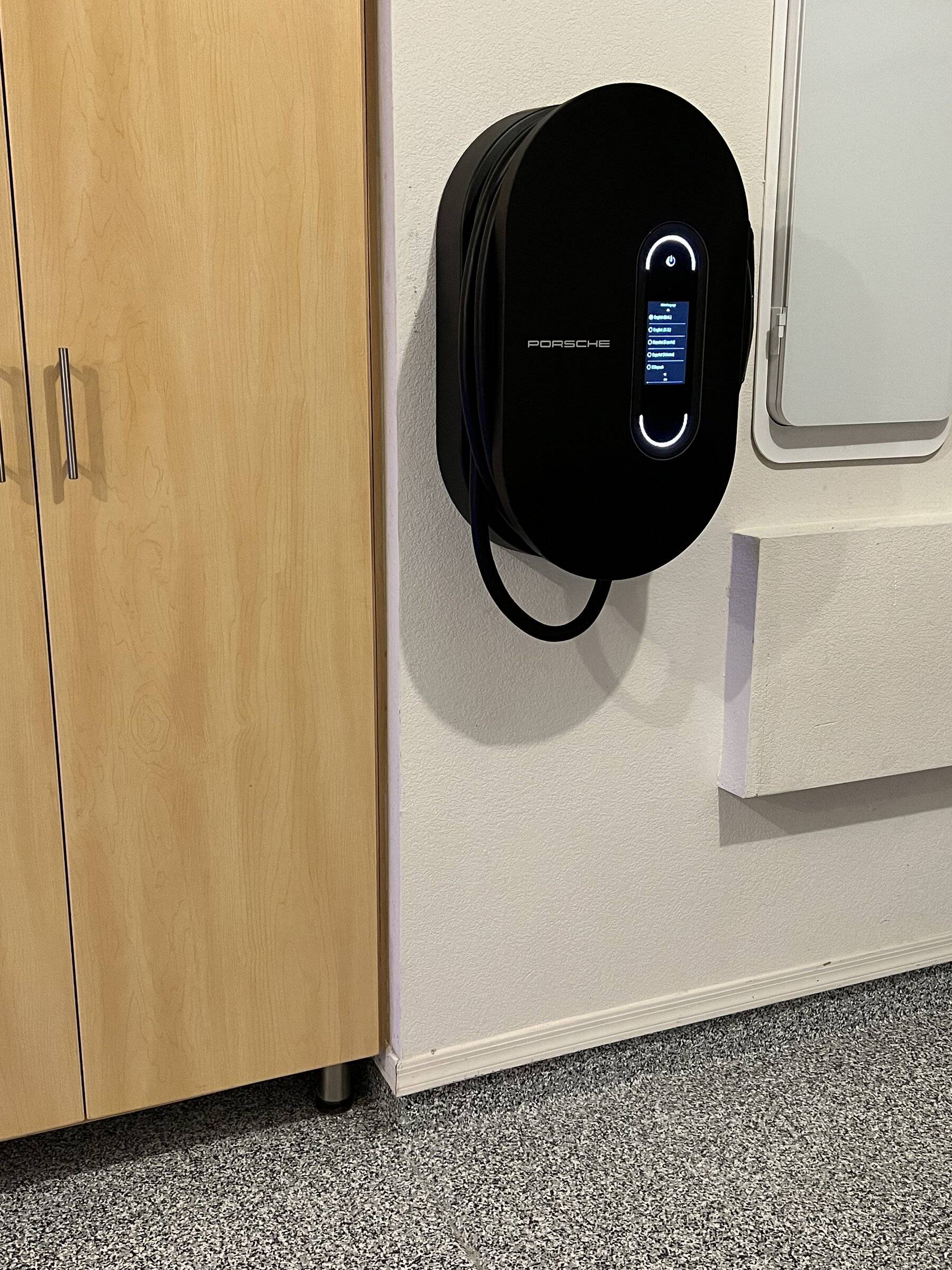

First off, great profile name…
Yes, you can have a clean install look with the power supply cable (outlet) hidden behind the actual cabinet on the wall. See a pic of my PWCC below.
The PWCC is Porsche’s newest and fastest EVSE at 80amp. (80A x 240V = 19.2kW max). According to US electrical code, an appliance utilizing >40 amps must be hardwired, which your electrician can do. That’s why this newest unit, unlike the prior versions, must be hardwired. My PWCC is located on drywall, so it was easy to run the wiring through the wall and exit right behind the cabinet.

That’s exactly what I was hoping to hear. Thanks for sharing!
I asked Porsche about this when planning my install and was told that it is technically possible, but to ensure that the unit remained watertight. I suppose that is to mitigate exposure to a household leak or stray water in the garage. You don’t want insects setting up camp in there either. Your installer can use the supplied sealing compound or some alternative to seal the point of entry.
I suggest you check to see if you have foam or fiber insulation in your wall cavity where you plan to mount the unit. If you have sprayed foam insulation it will be more difficult to pull the cable and you might find your electrician wants to change the plan on the fly.
In my case, because of the distance to the main panel, awkward access to the wall cavity, and the hefty 80A draw, I went with the external conduit so that a disconnect switch could be included. There was some debate as to whether code required the disconnect, but given the other factors I just went with it.
I agree that avoiding the external conduit is a much cleaner look. Good luck with the install!

What a beautiful set up!
Do you find overheating to be an issue with the unit enclosed in the (gorgeous) box?
In my case it hasn’t been an issue, but I only began using mine in the colder months (since November, North Eastern USA). Since it’s a fully integrated design (more so than the PMCC in a pedestal / enclosure) I would hope they got the thermals right.
