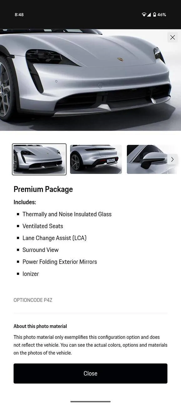

J1.1 premium package.
Porsche Taycan Premium Package Question Screenshot_20250507-204821
89
8,418
7,415
Oh. So only current 2025 got this option. Bummer. Not the end of the world but it's a nice option to have
Thanks ?
Whenever looking up the contents of a package, you must always match the model year, Taycan trim, and country/region. The contents of a package can change for different model years, and even for different trims, and for different regions. In this case, the soft-close-doors was not even a feature offered before 2025 model year. Another feature, such as motorized steering column adjustment was present in early cars with memory package, but later got moved to GTS and higher trim only.
