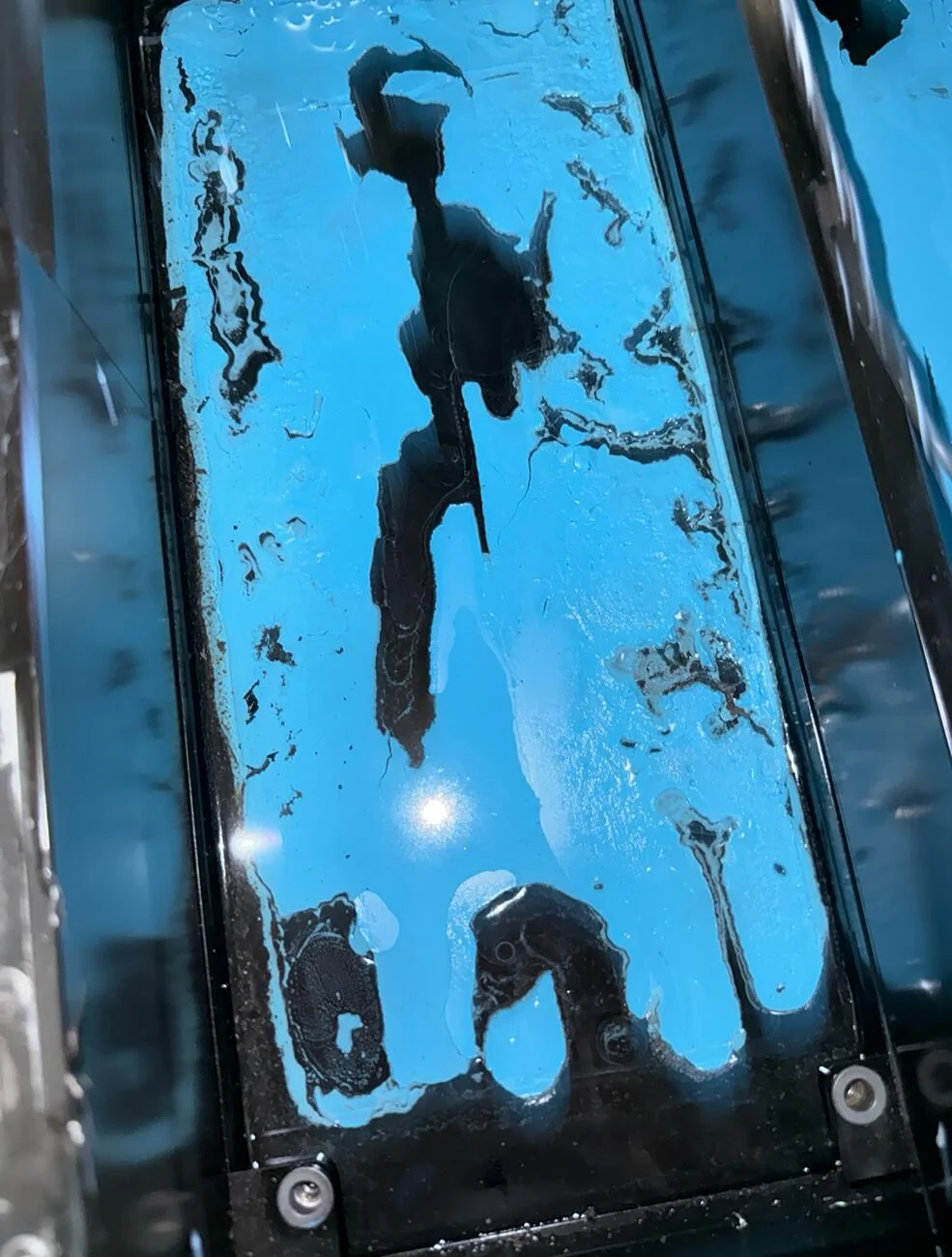

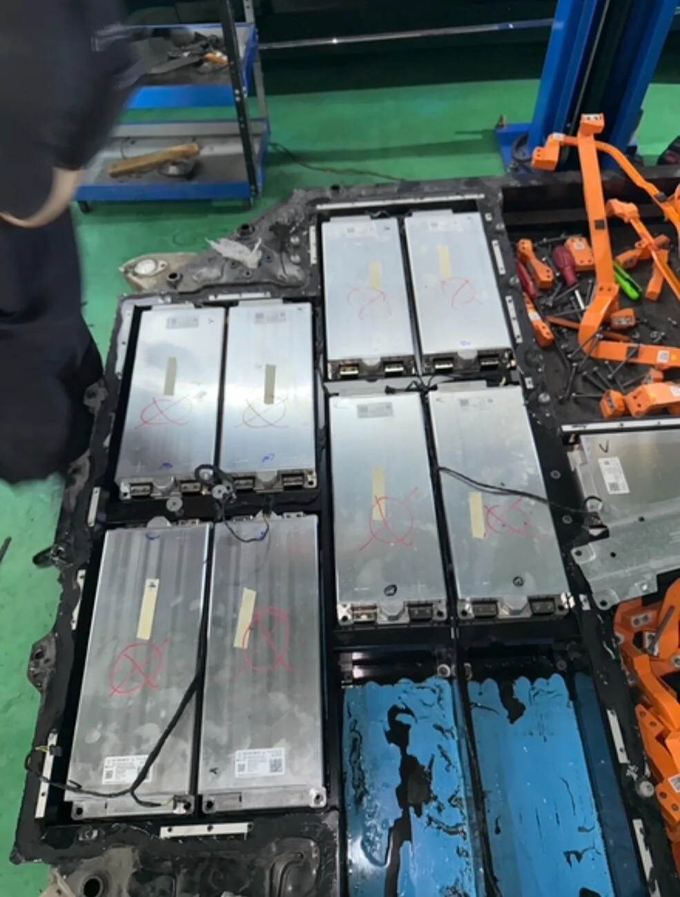

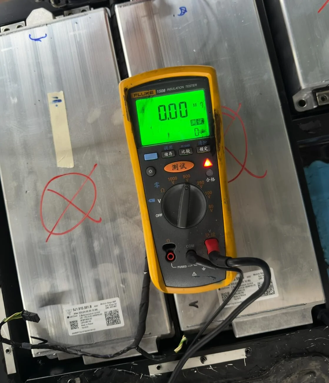

Another fire bomb on wheels at the shop. This car has the ARB6 update installed.
For the uninitiated among us, would you mind explaining a little about what we are looking at here? I get that it’s not good, but what is it - Is that corrosion? Heat damage? Leaking cells?

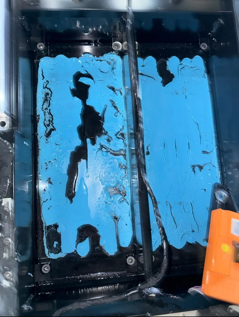

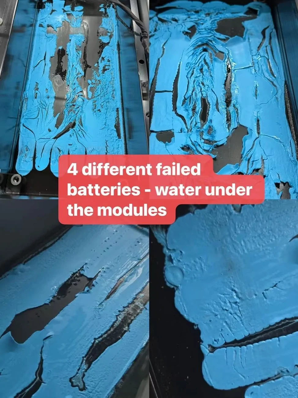

pools of water under the modules and fully dead short circuit cells

The HV battery compartment seal is pressure tested to prevent air and moisture ingress.
When it leaves the factory yes, but any seal deteriorates over time. And some even have defects on the sealant (there is an active recall for this)
Contradictoraly, the HV battery compartment has drain holes. These are not/cannot be one-way.There’s a servicing requirement to check & clean the drain plugs. And a service bulletin to remove the drain plug filter if it becomes blocked.
This means nothing, those drain hole are in the exposed center part of the battery, where it's not sealed and totally exposed, not even covered by the lids where the drain holes are.
those drain holes have nothing to do with the sealed inside of the battery

Is it only if the lid sealant has failed that water ingress via the drain holes into the module compartments could occur?
Is blocked drains therefore secondary rather than a cause of water entry?

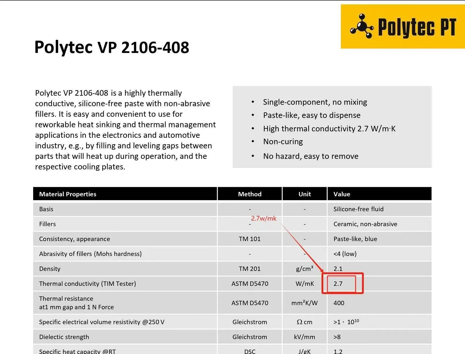

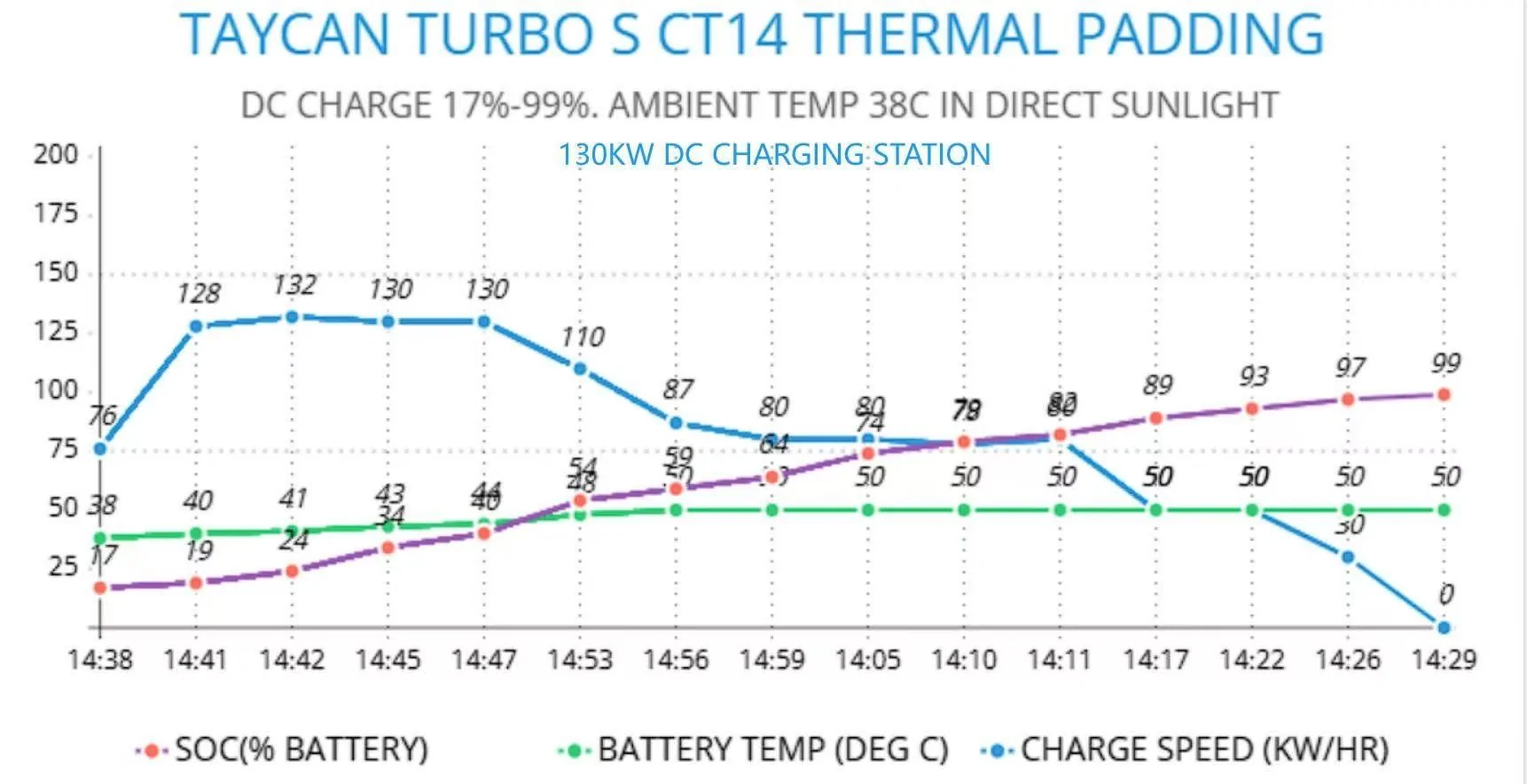

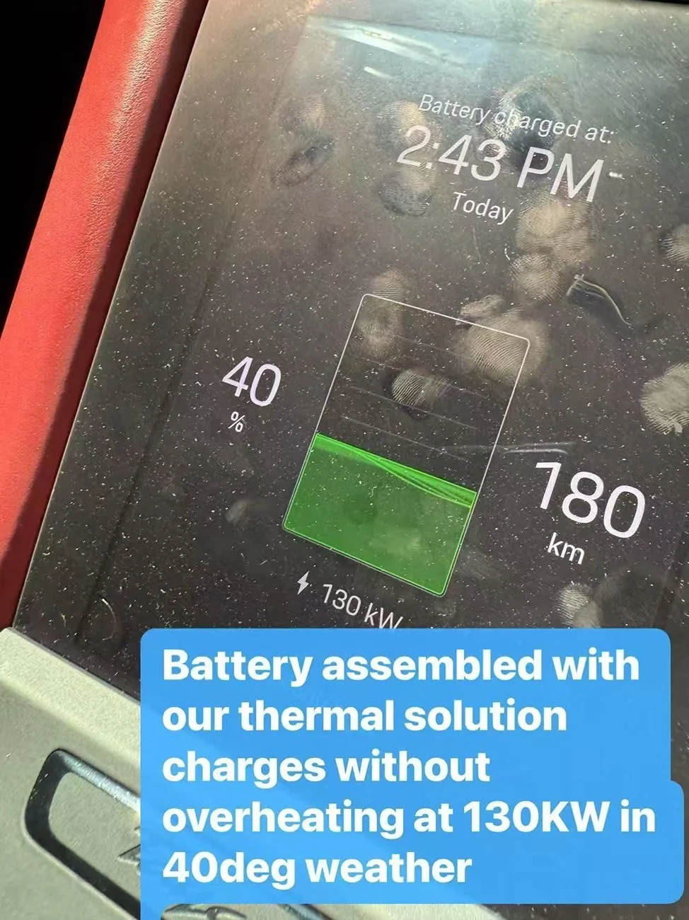

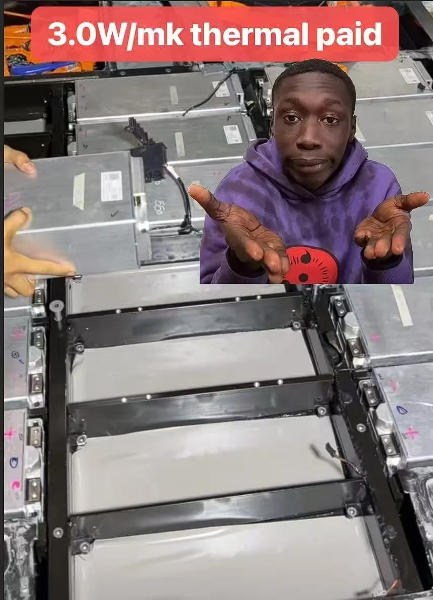

- the quantity of thermal paste used is specific and variable in each module compartment.
Yes, hence why in the batteries I rebuild we don't use thermal paste and instead use thermal pads of equivalent w/mk that don't need specific measuring due to the slightly curved module beds....
I get why in an automated manufacturing process liquid TMI makes a lot of sense over thermal pads as a robot can very easily and accurately apply the liquid TMI. But for us it makes no sense whatsoever to measure the quantity of old TMI and apply exactly the same weight of the new one...
Also this liquid TMI Porsche uses Polytec VP2106 absorbs humidity so any water inside the battery will always end up in the thermal interface right under the modules... not good...

Polytec VP206-408 thermal conductivity: 2.7w/mk
CT14 pad thermal conductivity: 3.1w/mk
