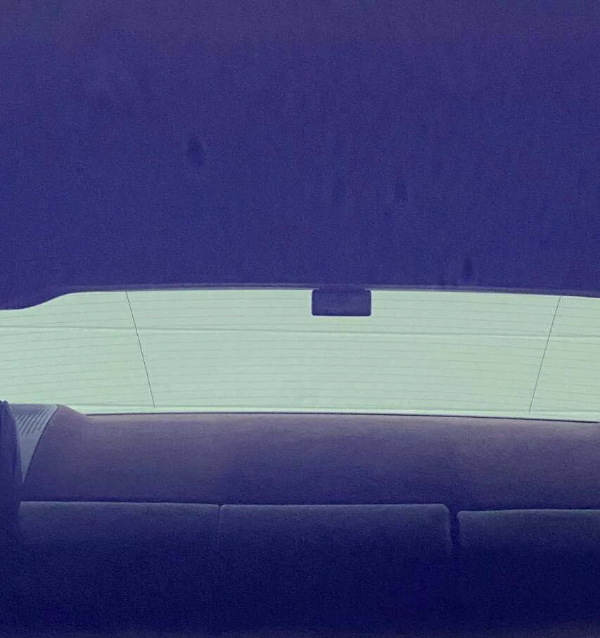

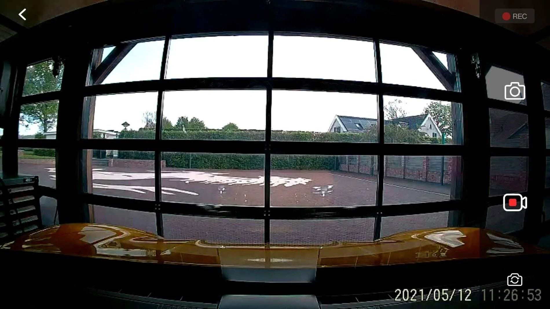

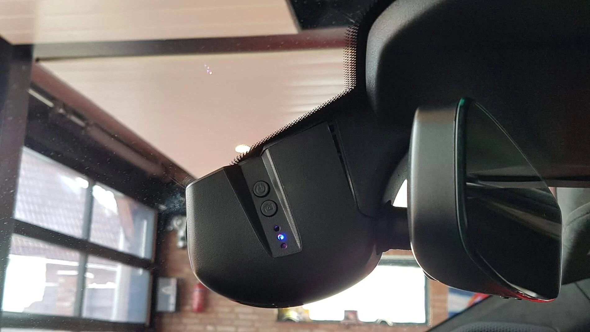

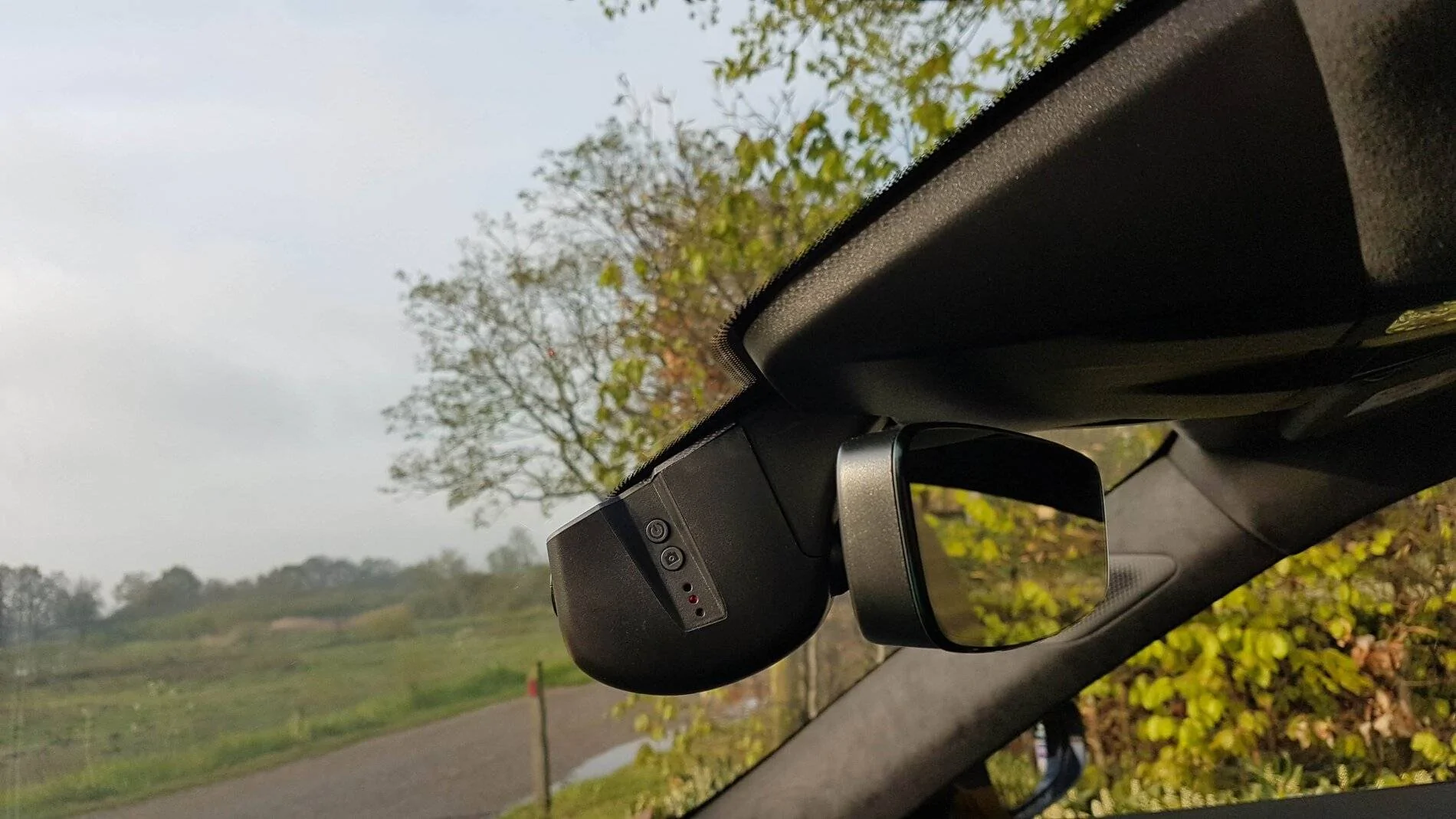

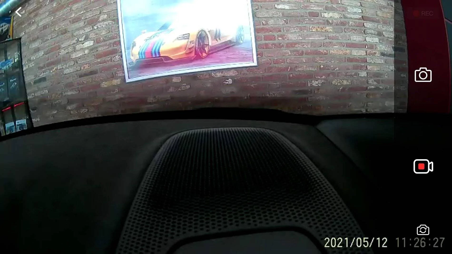

Dashcam in Porsche Taycan installed, dual = front and back.
For more information see:
https://www.carcam.nl/dashcam/porsche-quad-hd-dual-dashcam-binnenspiegel-voor-en-achter/
Price 399 Euro (incl. vat in NL/EU) plus SD-card 39 Euro = 438 Euro incl. VAT
Installation-service at home (in NL) 250 Euro makes a totall of 688 Euro incl. VAT
It is also possible to order the DashCam and then ask your local Porsche-dealer to install this Dual-Dashcam-system.

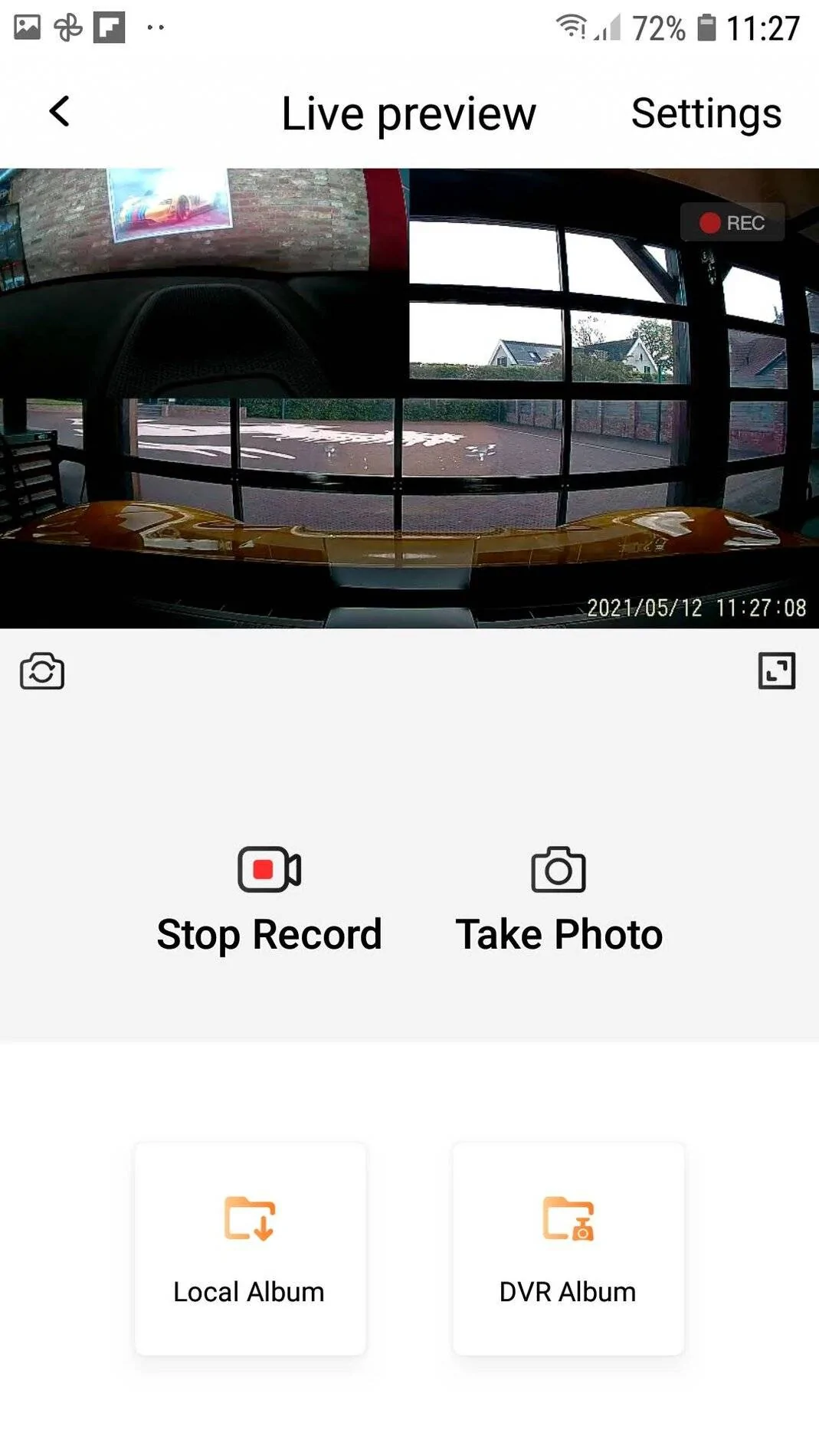

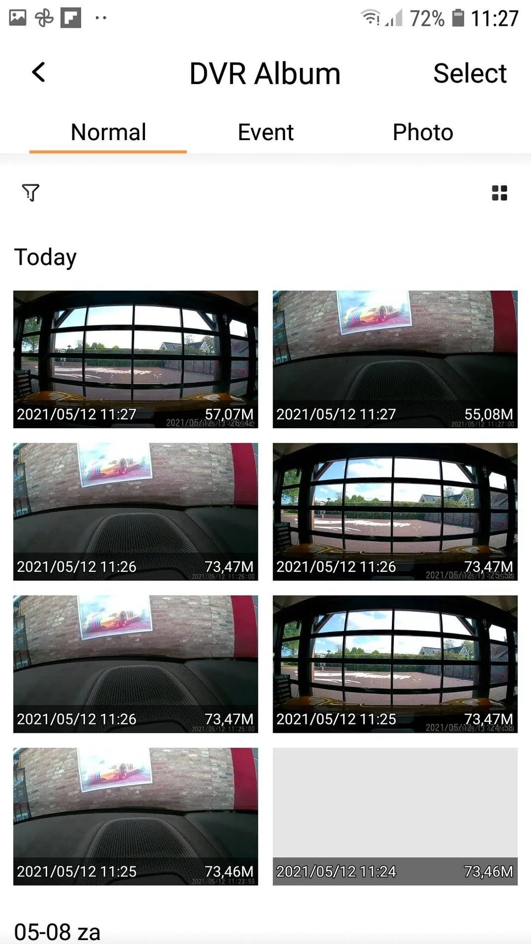

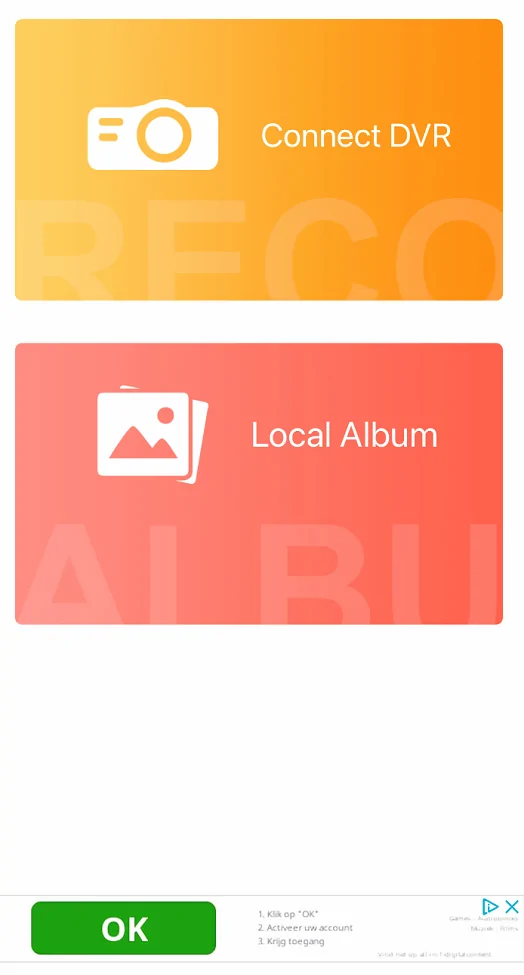

By using app TimaCAM its easy to see the real images and easy to download the video's

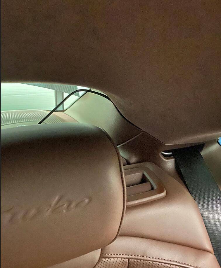

Looks Great! Any more pictures of the rear camera in terms of wires hidden etc?

Hello, Yes i'm happy with the camera's. No problems with battery, because the camera's stop recording after a minute when the car is turned off. The app is working great. You have to know that the recorded videos can be downloaded on your telephone when you are sitting in the car. communication works with wifi-signal between the camera-unit and your telephone. So with this system you can easy download the video's without taking out the SD-card. If you also want to see the camera-video's and pictures when you are on a distance of your car, then you also need a 4G-module in combination with videodata in the cloud. I think this will use more energy and you will need an abonnement (disadvantage). The company carcam.nl can also deliver this 4G-module. They told me that it is also possible to choose for this extra option in the future.

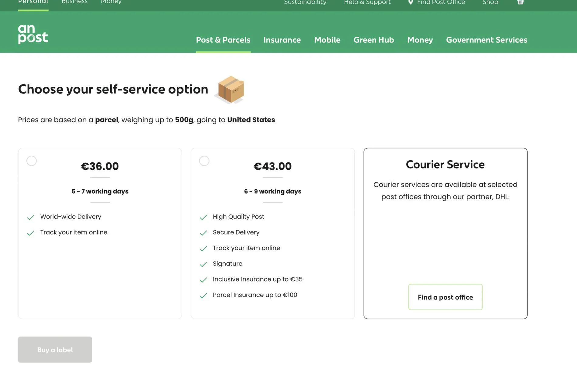

I think I've fixed DM permissions. Using regular postal service as opposed to UPS, etc I got these prices:

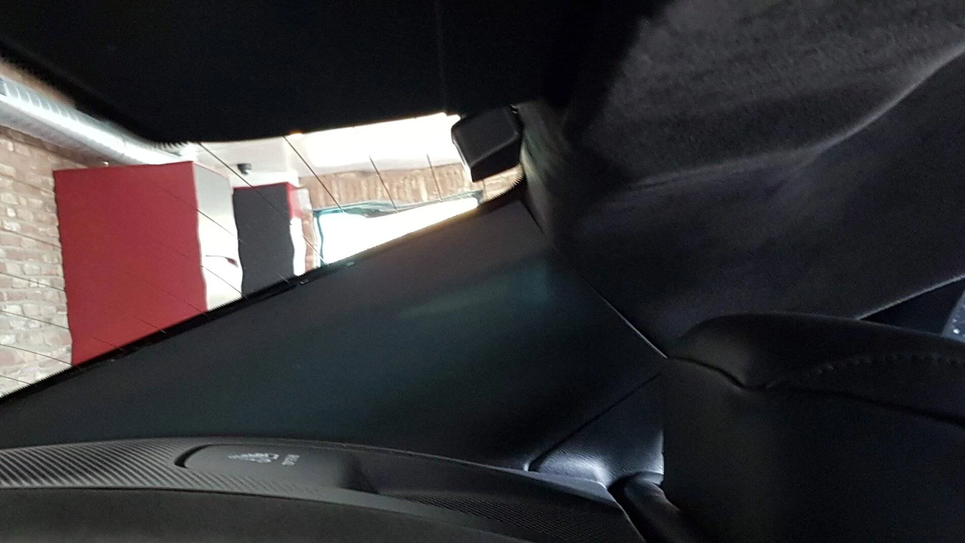

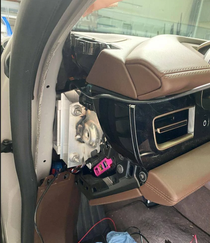

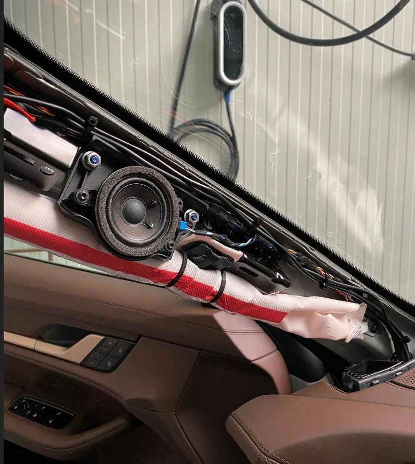

Installed mine last week. Image quality surprised me, because it's actually pretty good. You need to take some time to install it the correct way. Don't route your cables along the roof where the airbags are, but go over the floor then up again at the c-pillar again. The cable is long enough.
Porsche Taycan Quad HD Dual Dashcam front and back 1622218489819
Porsche Taycan Quad HD Dual Dashcam front and back 1622218516672
Porsche Taycan Quad HD Dual Dashcam front and back 1622218543029

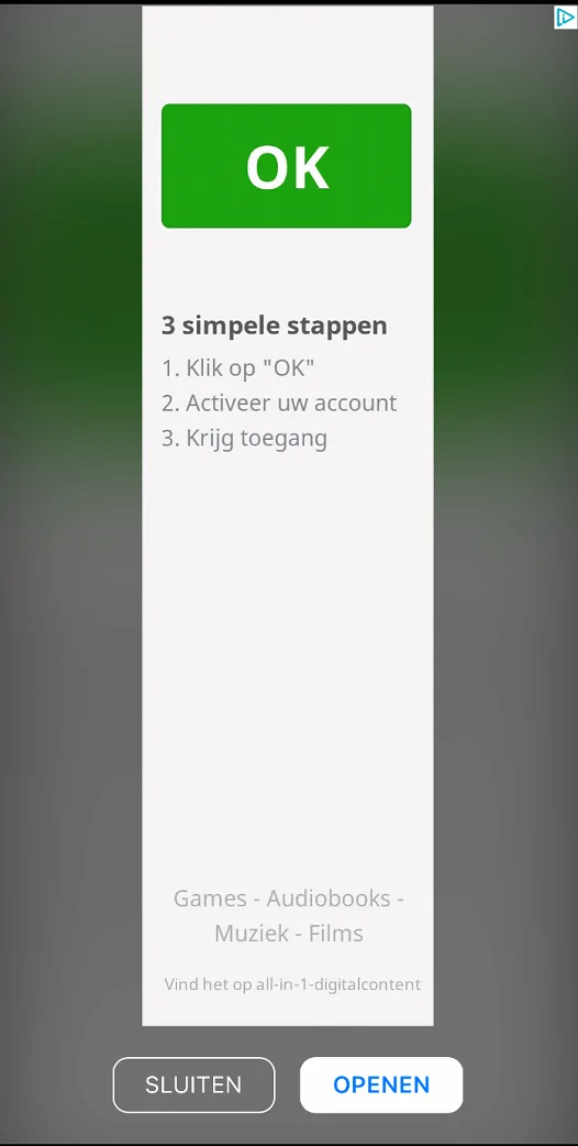

It works like you expect from a dashcam, but the only strange thing is that you get advertisements in the timacam app.
What I didn't get working for now is the parking collision function. I'll have to check what is wrong here. @TaycanTurboS-yellow, is this working in your car?

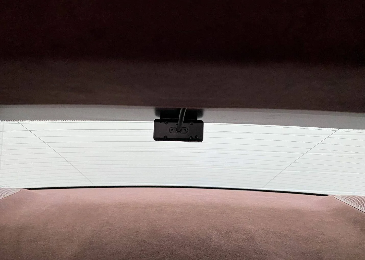

Does the rear camera hide behind the roofline of the rear window in your car as well? That is very appealing to not have it visible in the rearview mirror in rear window.

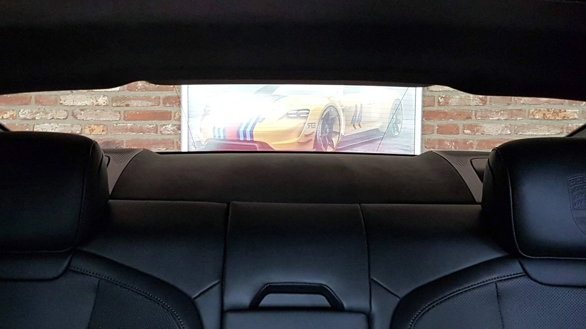

I tried several positions and ended up with using the tape to attach it to the bottom of the third brake light. You'll see a small piece of wiring, but although I like it when nothing is visible I wasn't planning on cutting into the oem Porsche pieces.
Porsche Taycan Quad HD Dual Dashcam front and back 1622280969812
From the rearview mirror

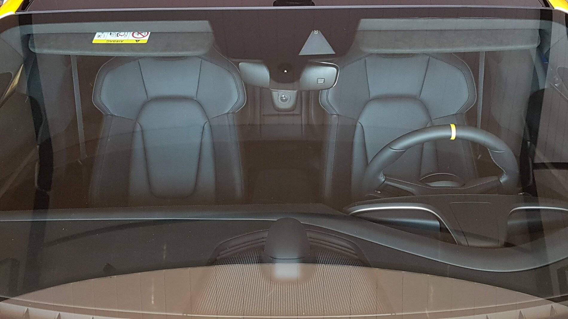

Is Timacam the only app that will work with this cam? Having advertisements in the dash cam app is enough to steer me to other options I'm afraid.
I'm not sure if other app's are available or even compatible with these cameras.
The advertisements are not really that annoying. There is one popup and you can clear it almost instant. Also you don't use the app that often, probably a few times a year if needed. The way the front camera is integrated in the mirror base is for me more important, because I look at it every day. The so called Audi/Porsche oem cam is much more present with its wiring and ugly glueing pad for the windscreen.
