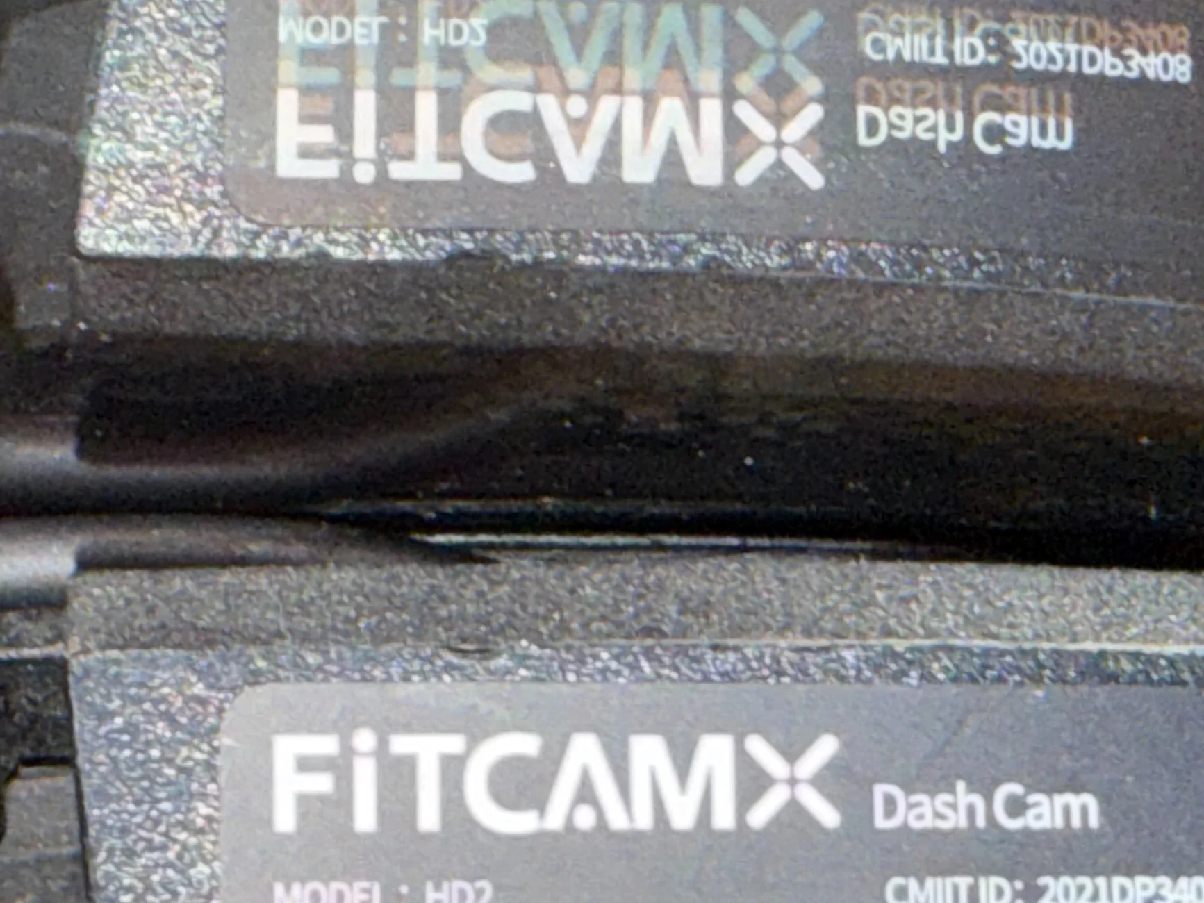

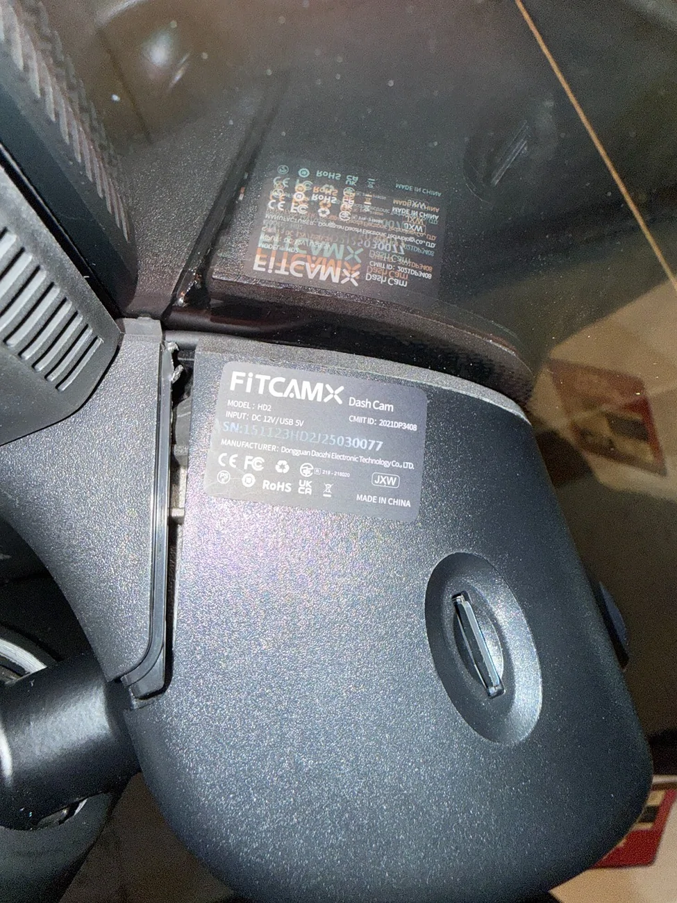

Thank you for all the blood, sweat, and tears shed in this thread as you all figured out the best way to install. Meant I only needed to shed both sweat and blood (literally) to get mine installed lol 😅 punctured the pad of my thumb getting the rear view mirror assembly back on, nothing crazy. Thankfully the entire install only took around 20 min -- again, thanks to all the trial and error details in this thread that I read cover-to-cover.
I ordered mine on amazon, which is why I must've gotten the weird "bulbus" casing batch shown off in this thread and earlier here as well, oh well, I'll live.

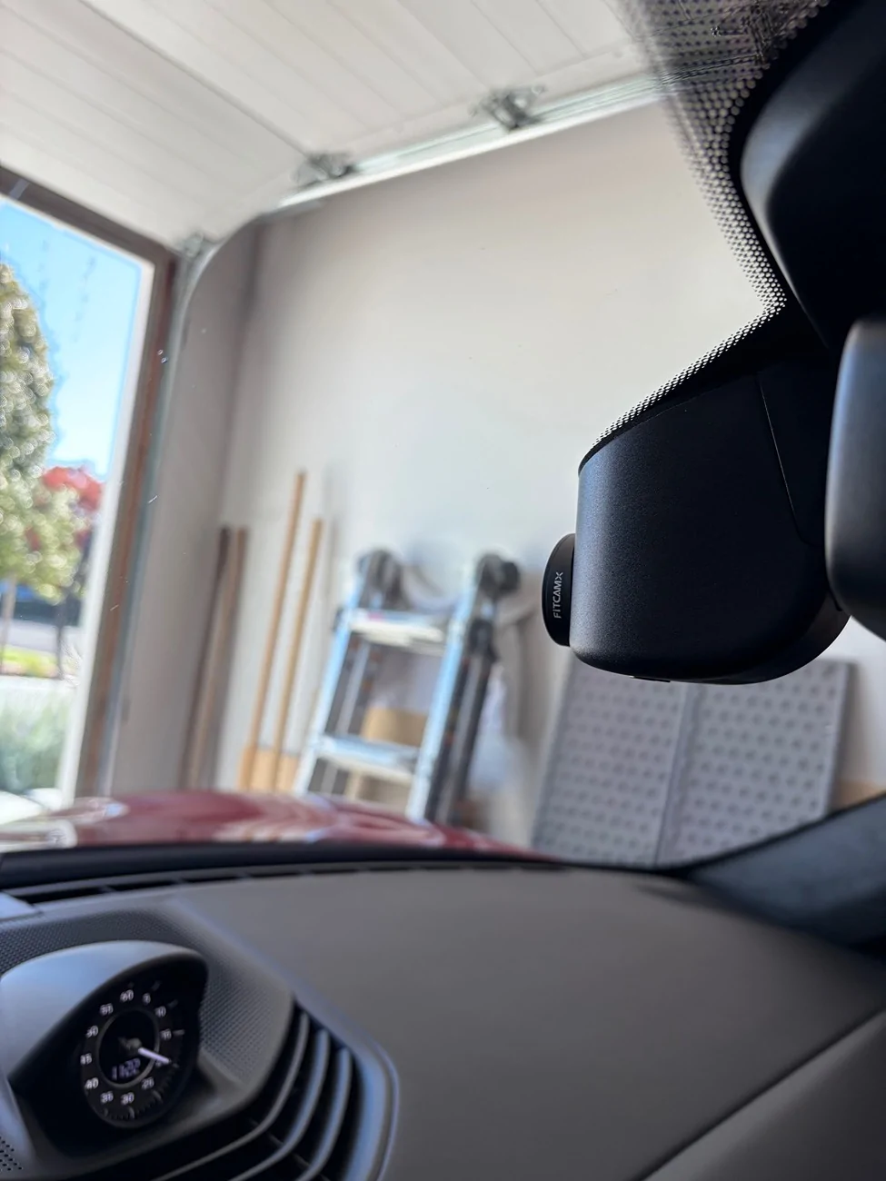

Porsche Taycan Fitcamx dashcam installation dash2
Porsche Taycan Fitcamx dashcam installation dash1

Just installed mine. The hardest part during during removing was the very from piece and hardest part putting things back was the middle piece.... Took sometime to make sit flush.
I used those 2 videos that were posted here.

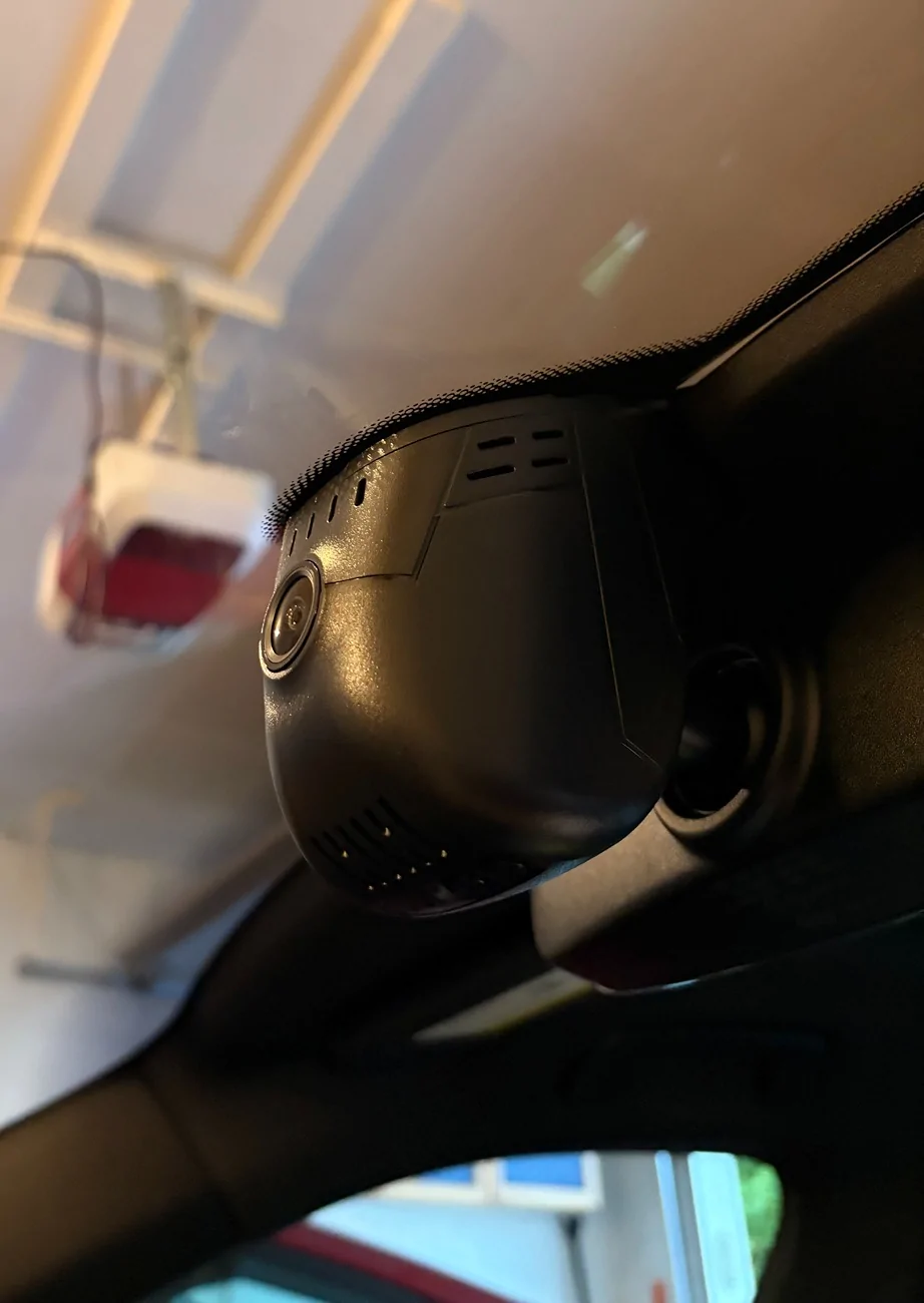

Read all 16 pages. Good advise on the thread. But I still have challenges.
I installed the camera, and can deal with all aspects, except one. I cannot get the camera itself it sit tightly against the glass. No matter how I push or wiggle.
The camera housing has two tracks that slide along the metal mirror base, those are engaged. But I can't push it the last 2mm and it does not click into place. I've tried different placement of the wires, etc.
The antenna, was unstuck and I ended up moving and resticking it where it doesnt seem to interfere with the install. I've moved the power wire to all kinds of different locations, end result is the same. (this picture shows it at the top, perhaps not the best location, but same results when it weas coming out other places.
Suggestions, others have similiar experience? (The middle was a PITA, but nothing compared to the camera!)
