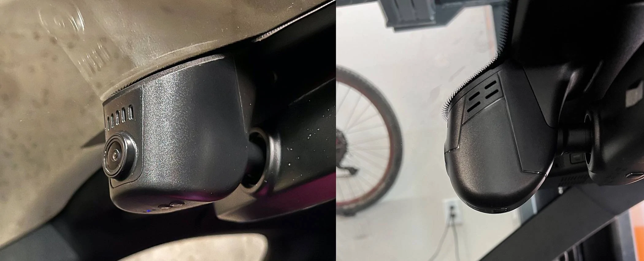

So I was looking for a discreet dashcam ... I liked the way the fitcamx was small and out of view so ordered one through amazon ... a bit more expensive then on their site but didnt want to get hit with import-duties/tax afterwards.
So it came in the mail today, I was expecting the one on the left (just like they advertise on their site/amazon) ... but instead got a bigger one, just like the one on the right.
Hate it when you order one thing based on how it looks and you get something else ... looks like I'll be returning this one.
So future buyers, be aware when you order a fitcamx. (unless you dont mind how it looks)

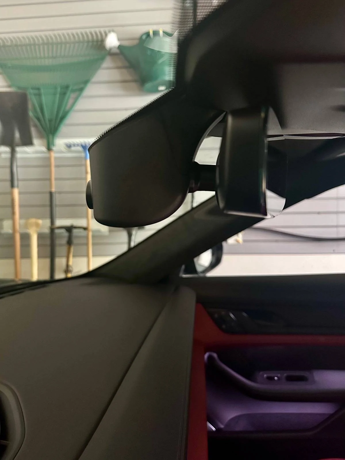

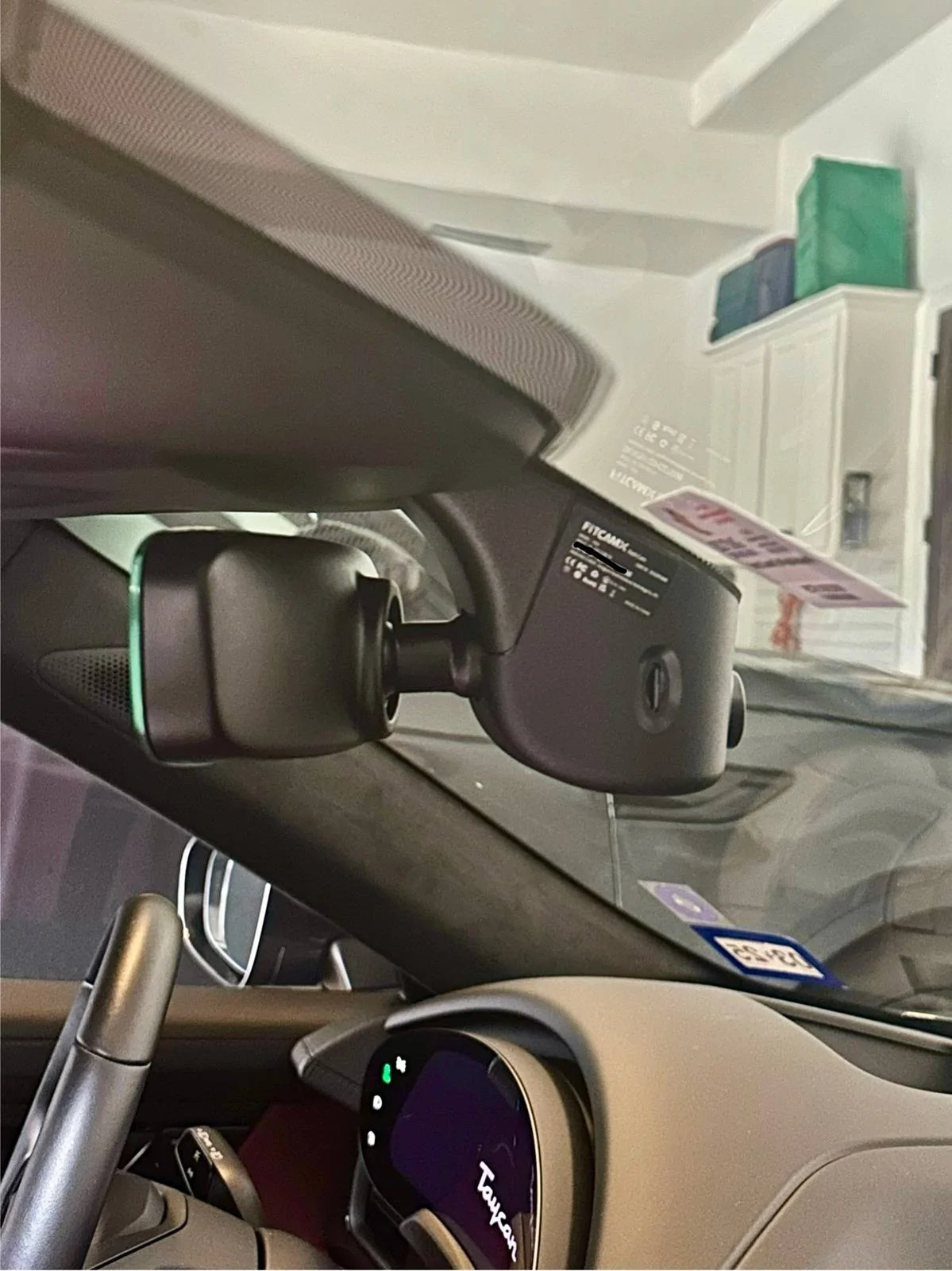

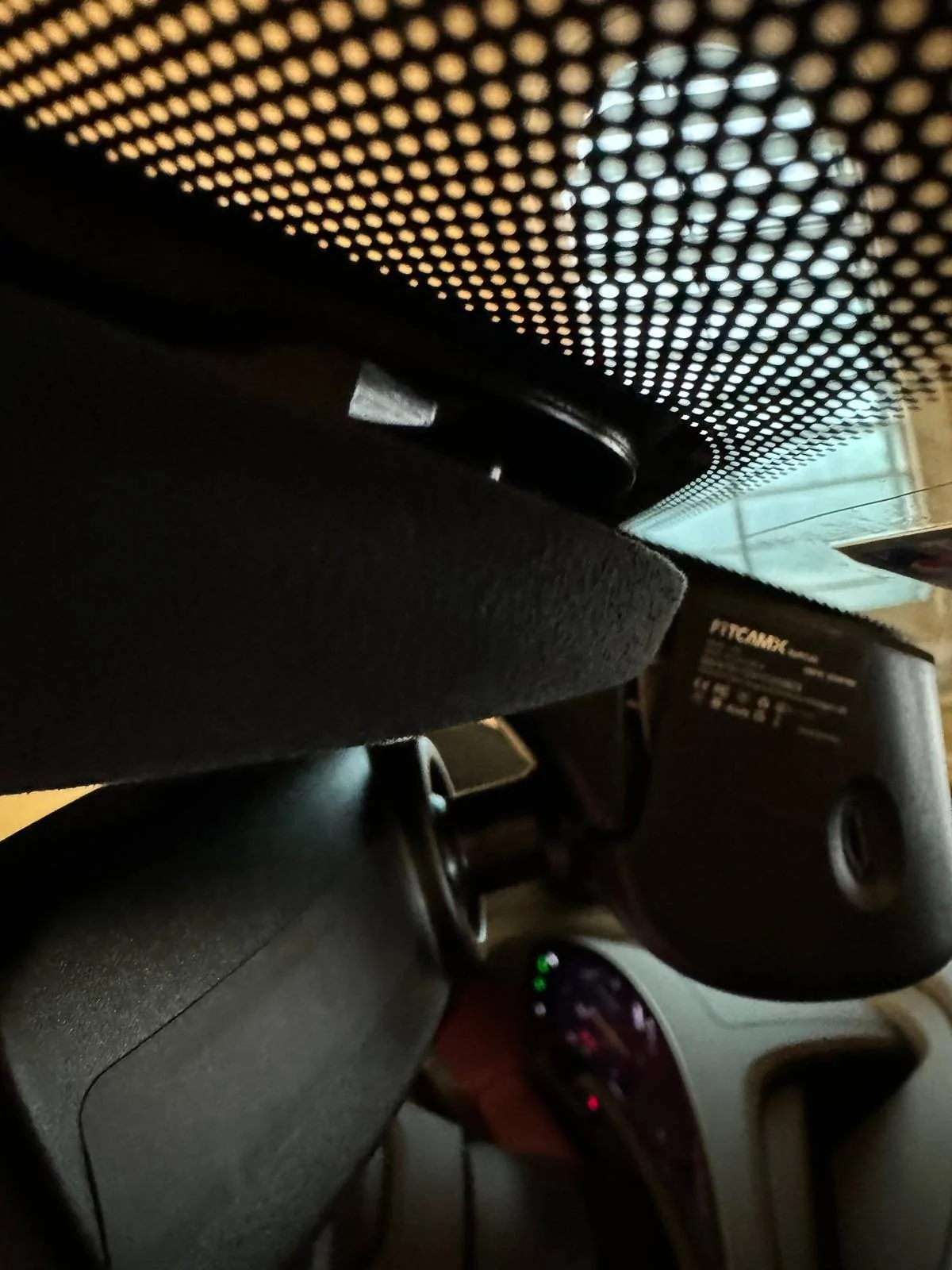

Bought the FitCamX pretty much immediately after buying my car. I was a little wary of the installation, but decided to give it a shot. I'm relatively handy, but not interested in a huge project or possibly messing up my new, expensive car. I watched the installation video before beginning and used my iPad so I could see the video easily during installation.
Installation went well, though it took several trips back and forth from passenger seat to driver's seat. There were one or two spots where my human-sized fingers couldn't quite reach one bit or another, but with a little push, shove, and stretch I made it work. From start to finish it took maybe 45 minutes, but time wasn't a factor - I'd rather take is slow and get it right than the alternative.
The end result is the cleanest dashcam install I've ever seen. @truthlesshunter is right, Porsche really should buy this design and use it as the OEM camera system. Images and video in the highest "4K" mode are very good and obviously 100% centered, which makes my OCD happy. I did get a little reflection from the dash-mounted clock, but turned the brightness down via the touchscreen. The app is functional, and downloading videos to my phone is fine. Slower than I'd prefer, but that's OK. One little niggle is that I have to disconnect Apple CarPlay in order to connect to the camera wifi network, but it's not hard (temporarily turn off Bluetooth). The included SD card gives me about 1 week of video before it loops/deletes.
FitCamX, you get 5 stars!

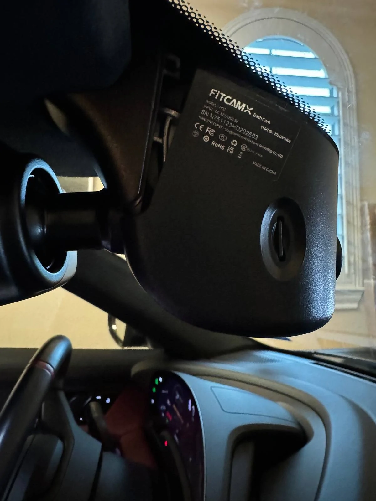

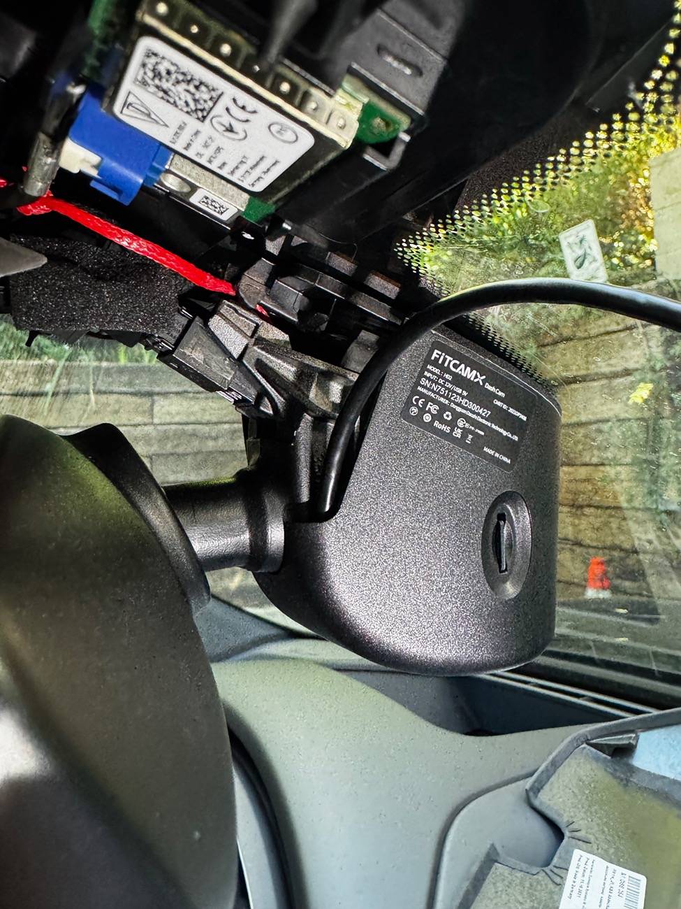

Installing my Fitcamx today. Got to part of reassembling everything and I cannot get the middle piece to line up. The fitcamx is snapped into place. I’ve attached a couple pics for reference. Any advice getting the middle piece to line up, I’m assuming this will also fix the alignment issue with the main large piece.
I just installed mine. I put one in the other car too, which was the practice for the porsche (not that the install was in anyway similar!)
The bit you've struggled with is definitely the hardest bit to get back in. Initially i'd struggled to get the camera to line up centrally with the mirror stalk, but solved that by moving the power cable to the other side and lots of wiggling.
The top bit you mention was a real pain, as there is not really any angle for you to see in properly / get your fingers in. The problem is the size of the socket on the piggy-back cable. If you can find a space for that, then it will clip together 'easily'. But you do need to get it to the side of the clip on the middle of that bit of trim (where the red string was hooked through) or it just won't go back. Definitely spent as long doing that bit as the whole of the rest of job put together.
The problem with their install videos is a) the dreadful music and b) it's too heavily edited and some crucial (aka the most fiddly) bits are missing. I queried this with them (their web chat is good) for my range rover install. They sent me a link to a much longer video made by a nice chap (i'd say in the cotswolds looking at his house) who walked you through it properly. 20 min video vs a 4 minute one.
Maybe fitcamx have a better one to help you if you've not managed to solve it.

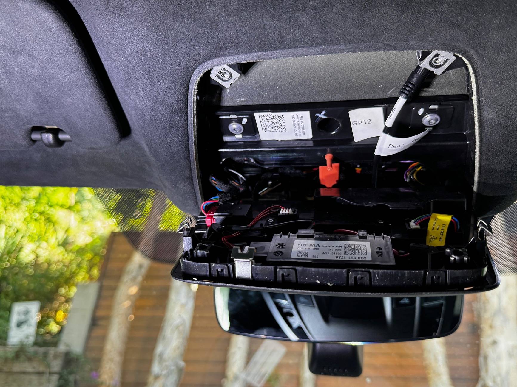

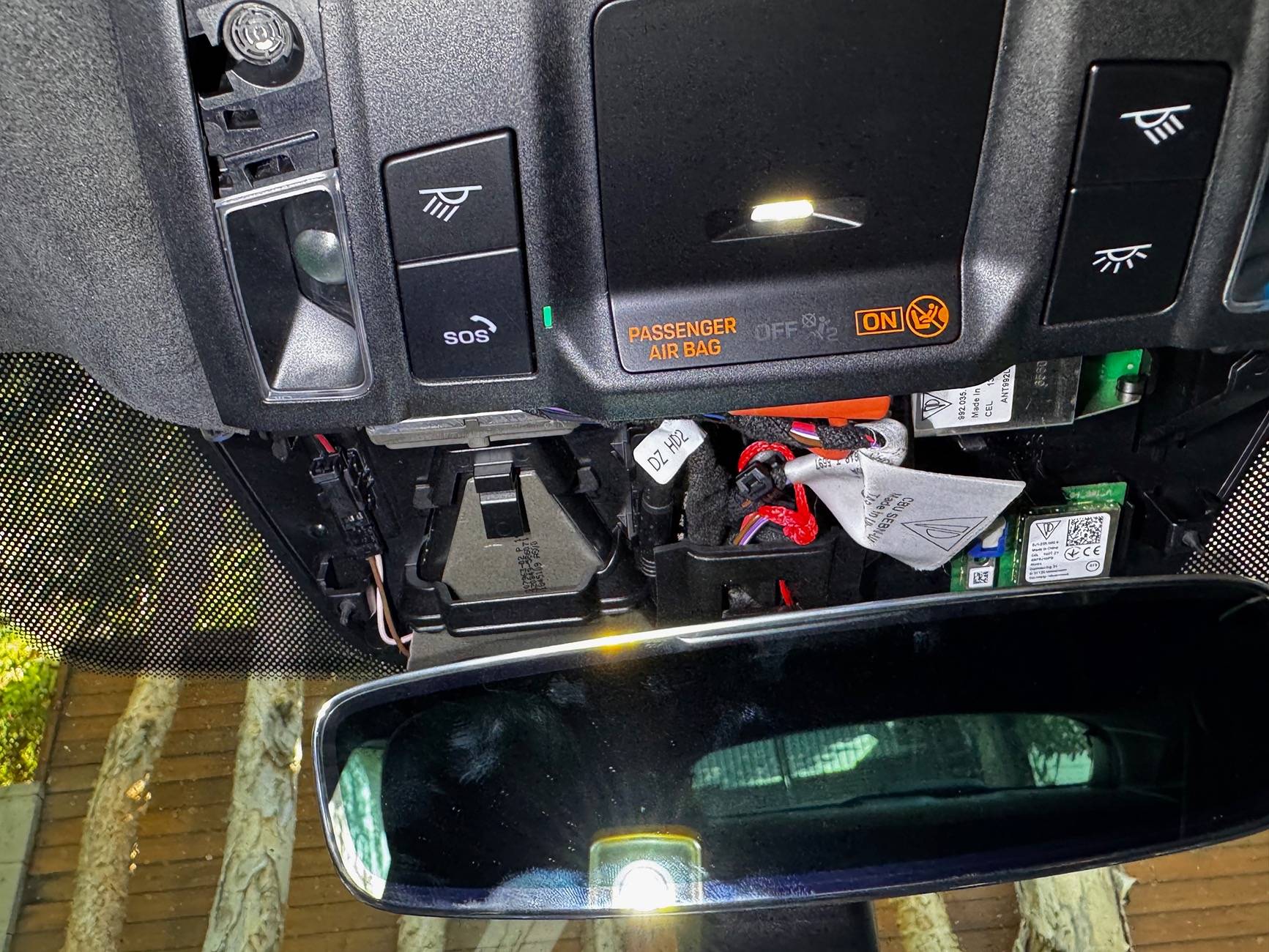

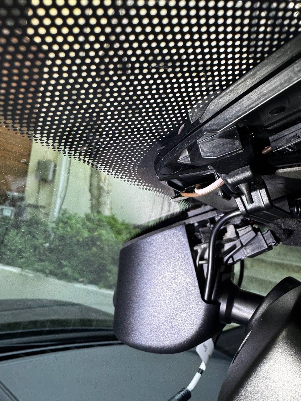

I installed my front camera and left the line to my rear camera up inside of the headliner for next time. I took some photos that may be helpful for some people.
The units now use these chunky wires for power and for the rear camera run, the only way i could make them work was to have them folllow the curve of the cover and shoot straight up the front. i went reverse camera on the right side but i don't think it matters.
Porsche Taycan Fitcamx dashcam installation 1721089769438-25
Porsche Taycan Fitcamx dashcam installation 1721089790836-vs
It also means that it gets pretty cramped under the middle cover piece since there are those wires plus the connector to the power splitter, and then excess. I flattened them out and moved them into whatever space was available and it pinched down under the second cover. It all sits flush and isnt pressing anything out of place anywhere. getting the second cover to snap to the camera cover took some effort. wouldnt want to try to remove this later..
Porsche Taycan Fitcamx dashcam installation 1721089916368-4m
i dropped the front roof console off so that i could leave the rear camera line in there and access it later without having to touch any of the other stuff

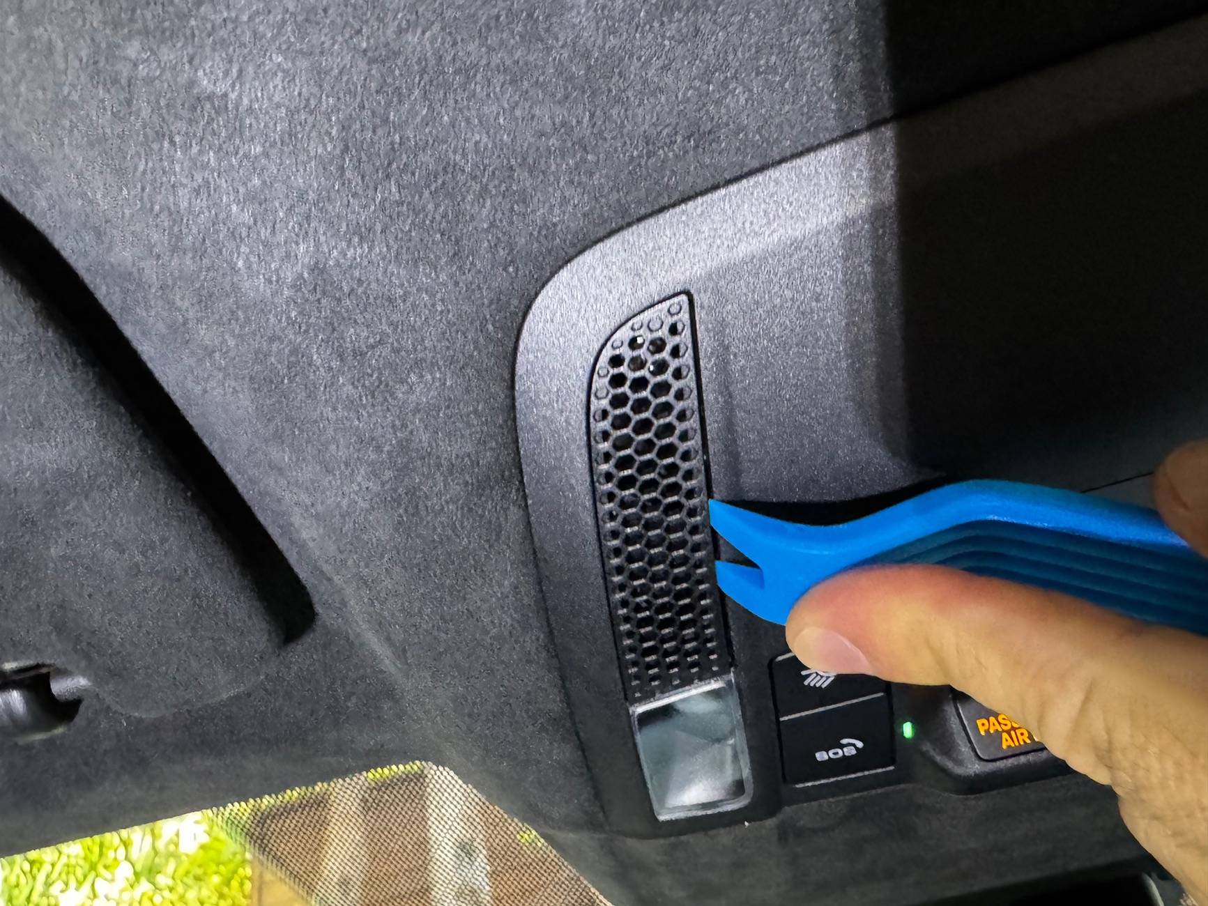

somewhere back in the thread someone was trying to remove this and having problems. there are 2 T20 hex screws under the grills. the grills come out very easily if you push in the right place
