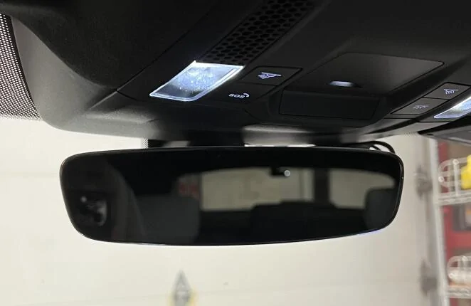

blocking another 1/2" of your window when you're driving. It kind of sucks. The blocking of the view is more annoying to me than the filter issue.
Given that, I would suggest a Blackvue dashcam as it can be hidden completely behind the mirror. It looks like this from the driver's position on my Taycan:
Porsche Taycan FitcamX - did they sell me the wrong thing? 1723452688517-jh
Minimal obstruction, and it uses Taycan pre-wire intended for a dashcam (4K front camera plus you can also install 2 channel version with a rear camera using using the same pre-wire, like I did - see this thread for details). If I wanted to be pedantic, I could even hide the two wires slightly visible above the top right of the rear view mirror, by tucking them behind the mirror.
