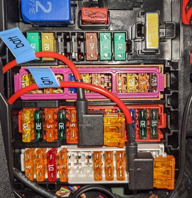

I have the V1 Gen 2 with a mirror tap and then I ran my Blackvue to the fuse box in the passenger footwell. It was a pretty easy job and I did not take off the A Pillar to do so (some parts by the dash I did for access) and the only wires visible are on the end of the dashcam where they plug in.
