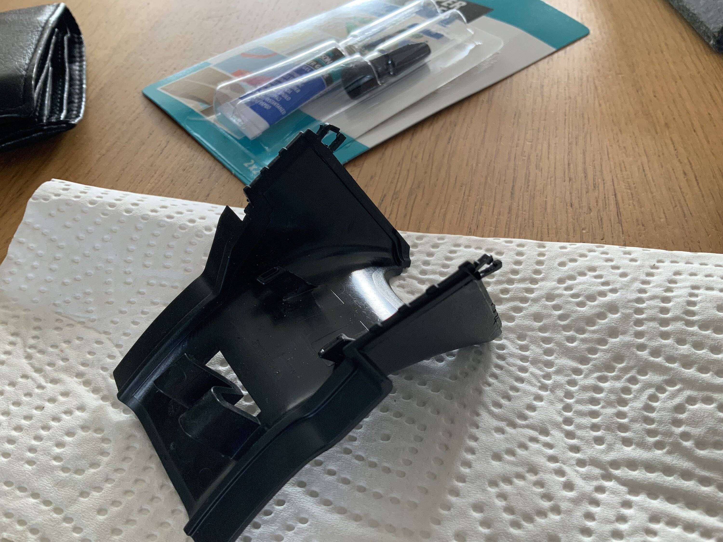

walked away for a bit, the front is now connected snug. The middle part, slips in on the bottom but is just a bit less wide on the top, near the window and because of that it doesn’t hold the lock And recesses a few mm
any thoughts on how to fix that?
in hindsight:
big panel off > easy
turn mirror, middle panel drops lose > easy
middle panel out of the way
slide front from mirror socket. > now very easy
connect cable
put mirror back > a bit finicky
route cable above middle cover and put middle cover sort of in position
slide on cam cap on mirror socket > this is a bitch before it sits right.
once snug, slide middle part towards it, it should click (mine clicks and jumps back)
but big plate back.

So the previous owner already removed the cover and broke the pins
the evidence is in the breaking marks.
long story short I need to order a new middle panel and Porsche wants €48!!! Euro for it.
but now I’ve seen the breaking mark I cannot unsee it, even if it’s out of sight.
but then all should be good.

But I removed the front cap by removing the mirror, after that it was very simple just to squeeze the middle panel part between thumb and index finger and they are separated. The locking hooks left and right were already torn and then I did see the forcing mark on the side.
but the cam is working well, the app is working fine. So just swallow another 50 bucks to have it pristine.

So I’m really happy. Today I’ll try to glue the broken hooks from the previous owner, otherwise I order a new middle panel. It’s indeed the cable that causes the tension. For me it’s the reason why with the empty socket cap the middle cap stayed in place but with the filled cam and cable it’s a bit more under tension and the torn hooks don’t hold and it recesses. The backup plan is burning the extra 50€

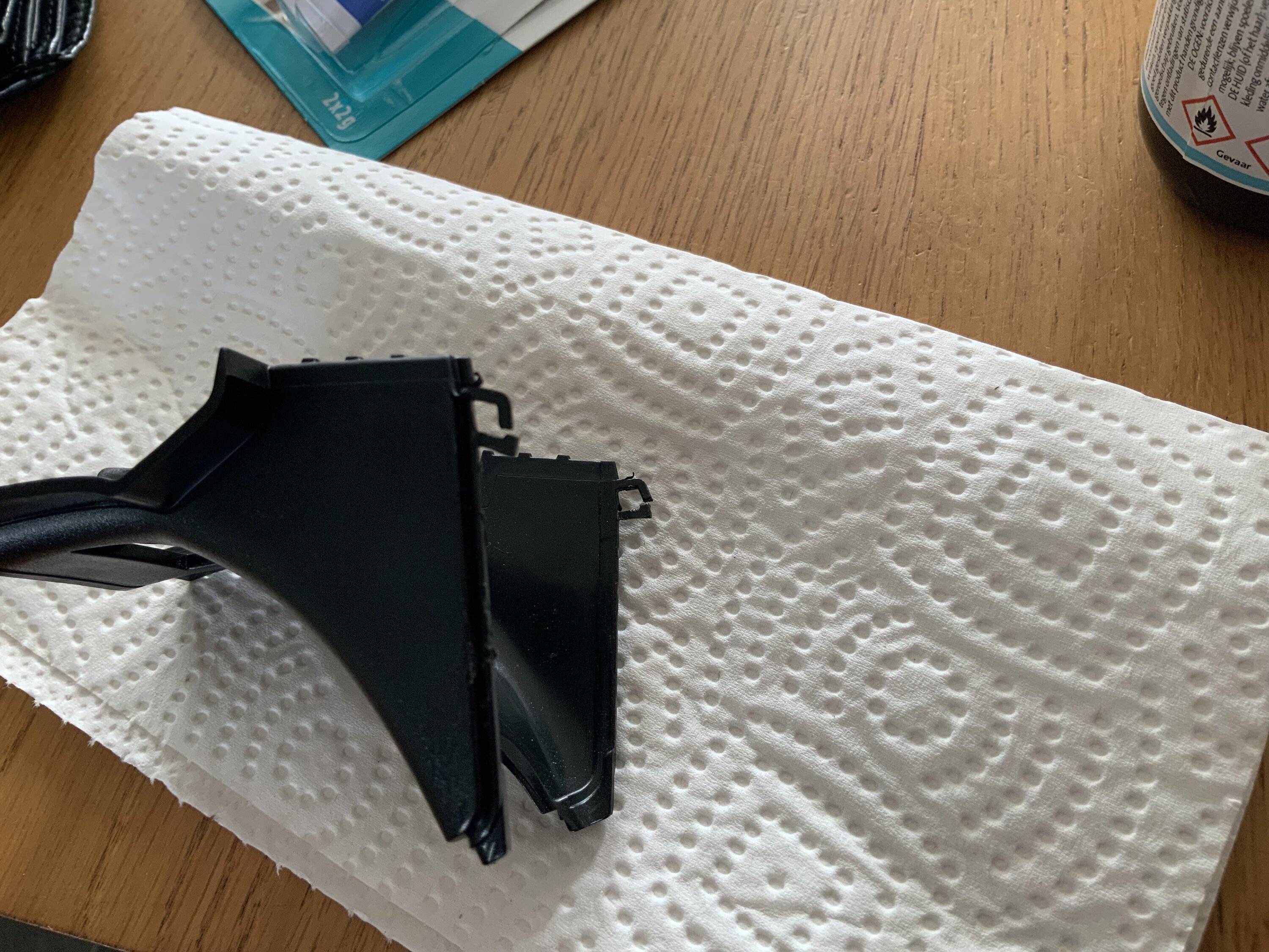

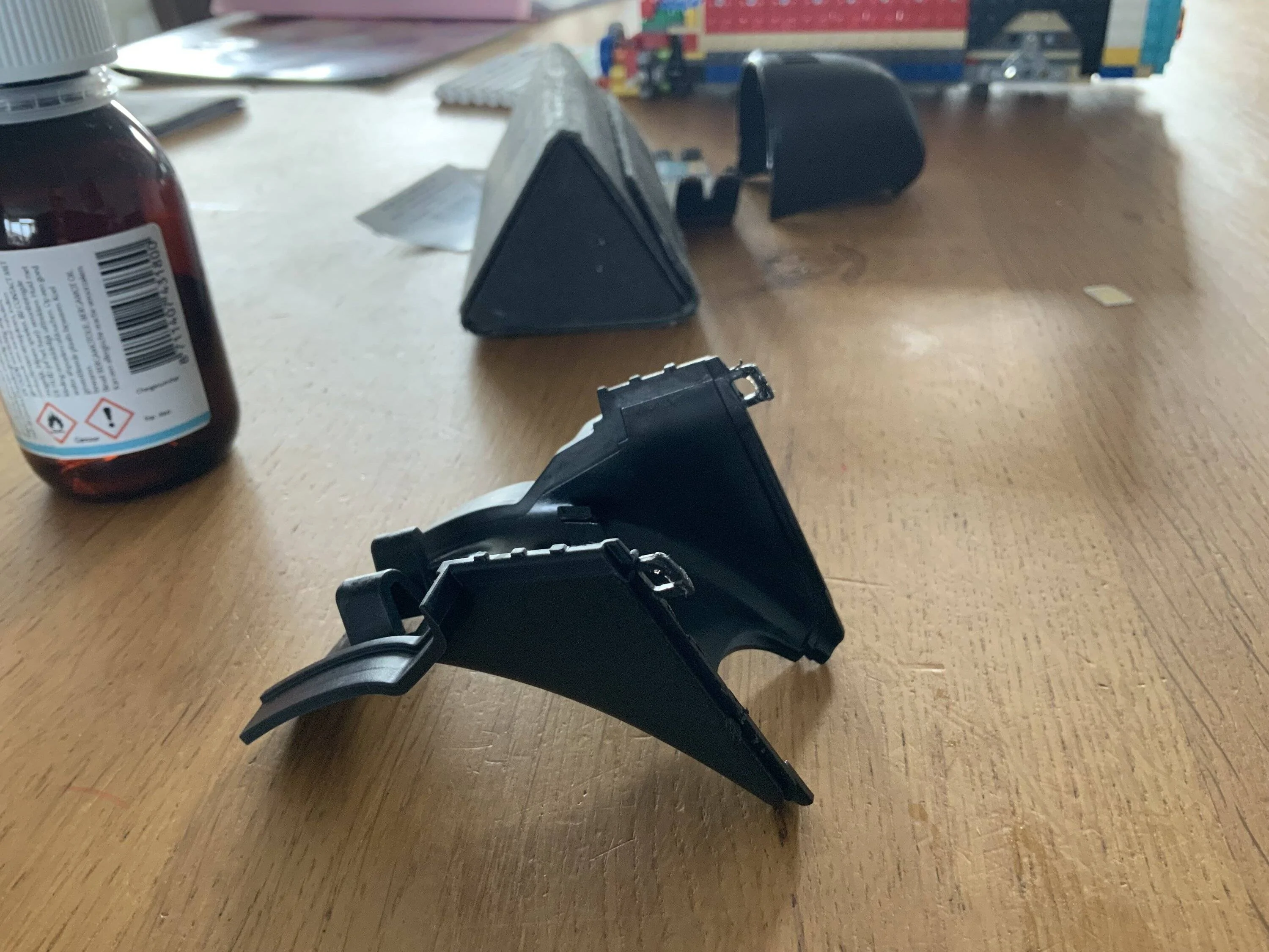

Let’s see if we can repair the middle panel, pulled before, by someone else. If not it’s 48€ for a replacement.

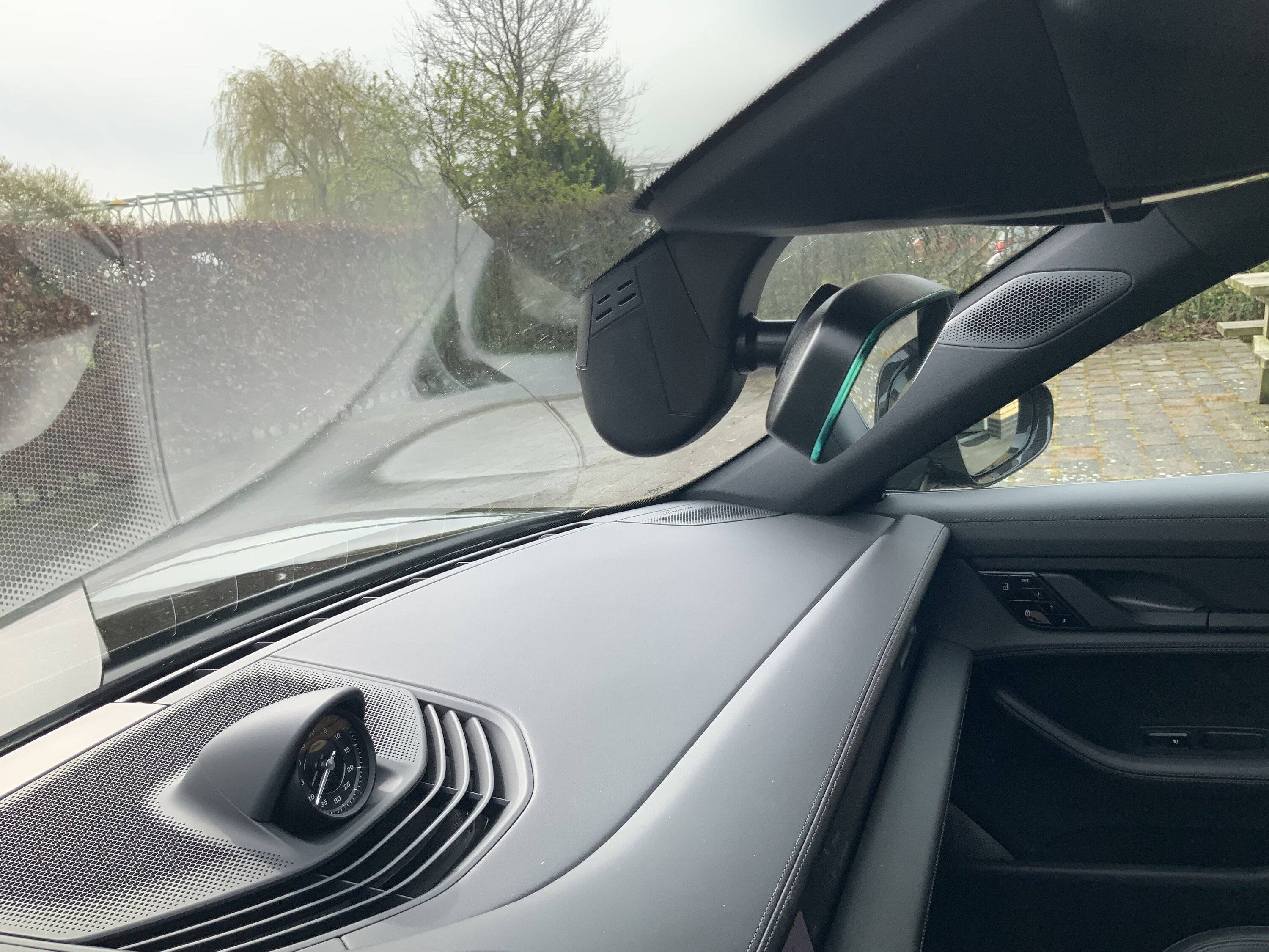

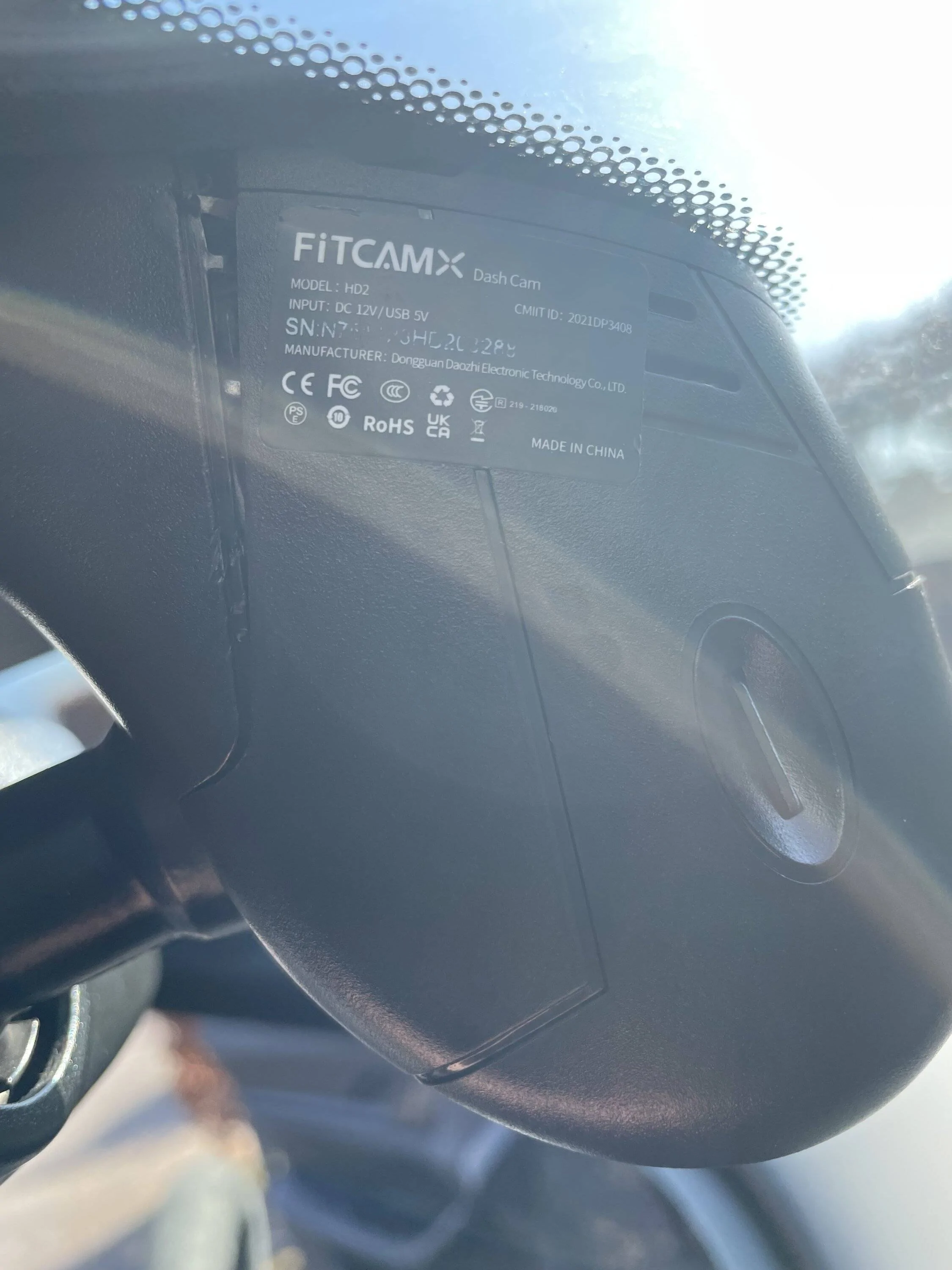

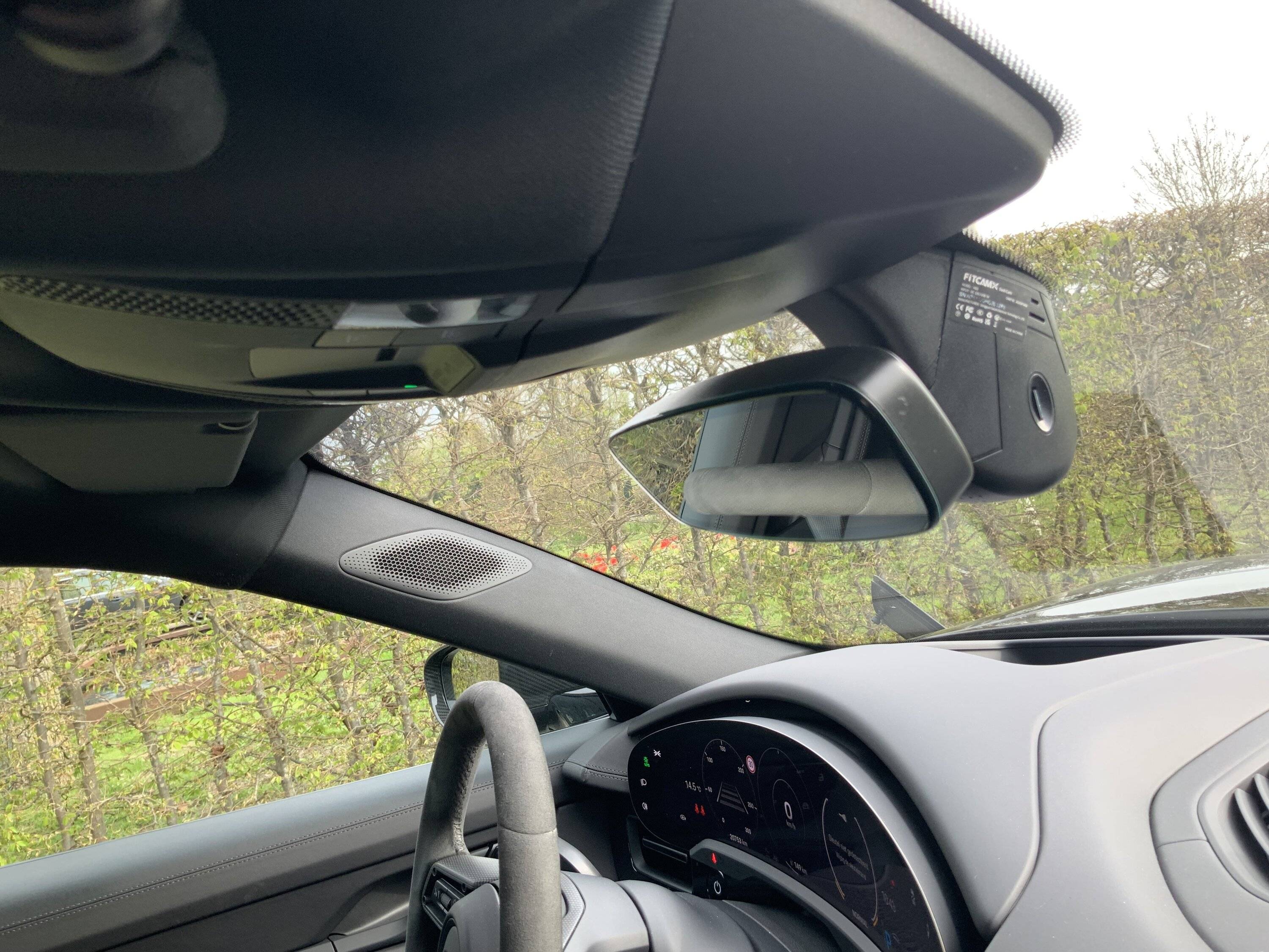

Profit… :)
the passenger side is not 100% to my liking because of the previous scruffs, but good enough for now.

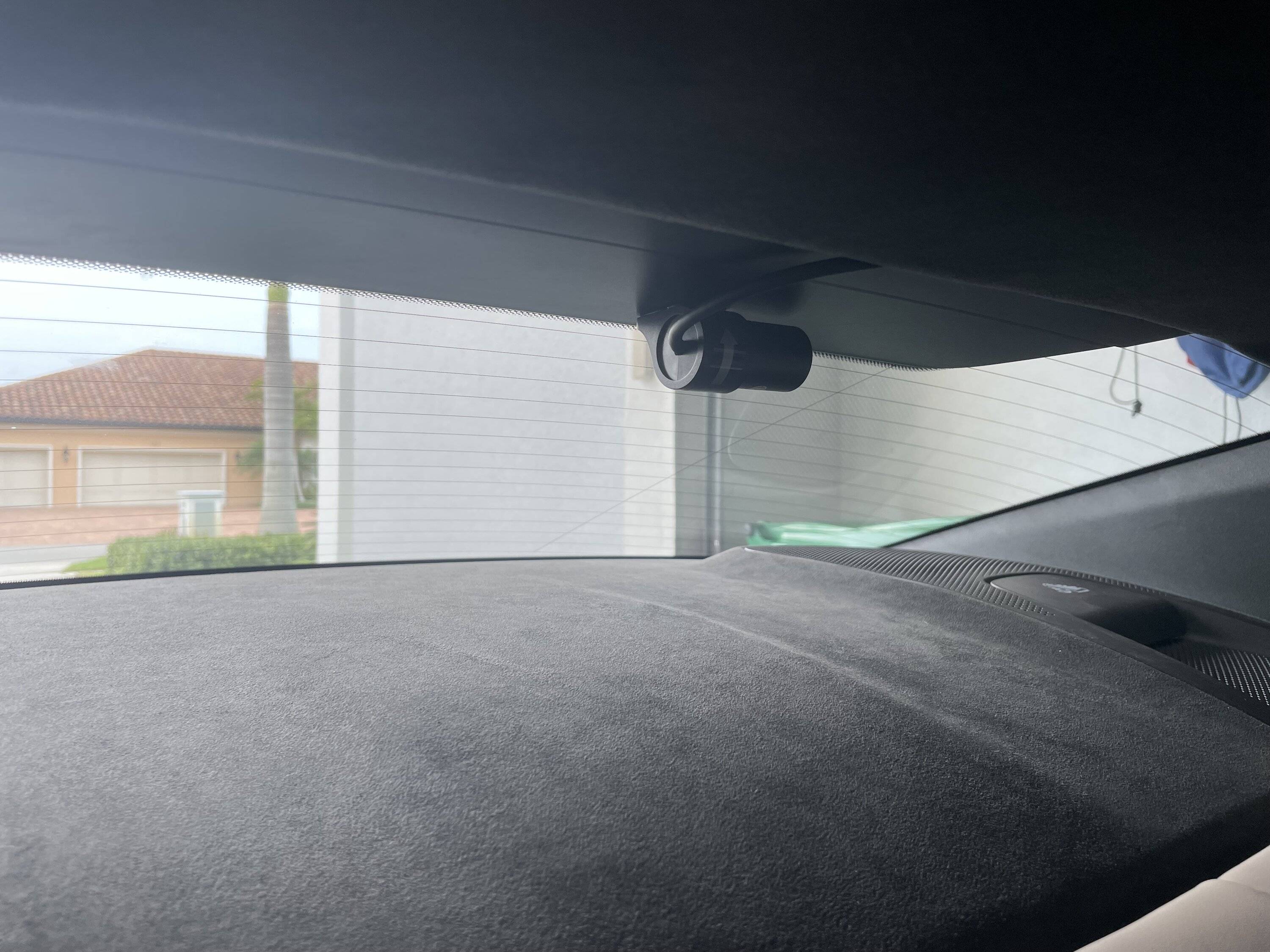

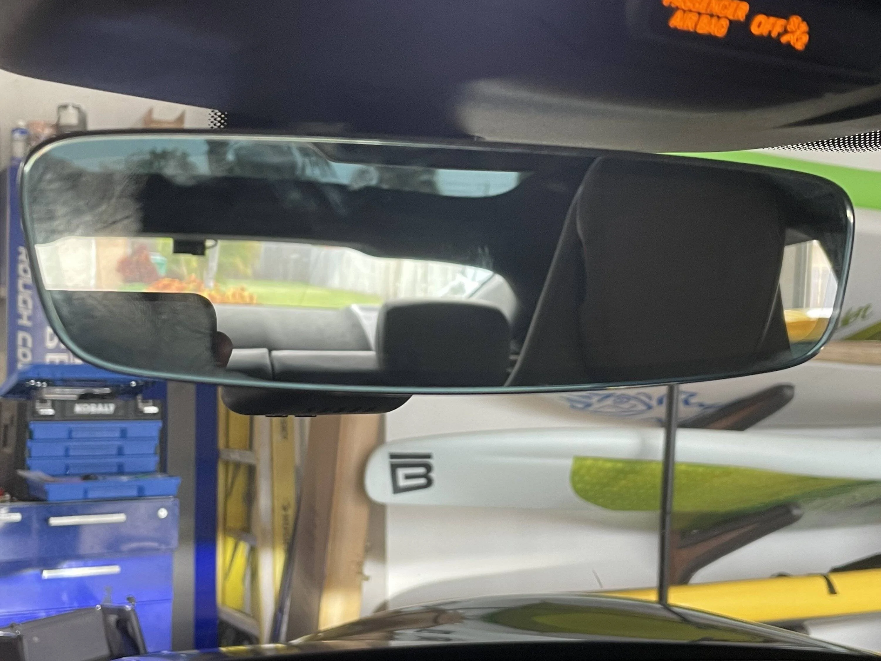

I got mine installed last weekend. The video a couple pages back was very helpful. I didn't get any pics of it installed but the smallest curved piece between the mirror post and the overhead trim was the biggest PITA (maybe because I ordered a rear facing camera). The gaps aren't as tight as new but perfectly acceptable and not noticeable by anyone unless pointed out. The gaps are at least evenly gapped. The from cam is imperceptible and the rear cam is noticeable but unobtrusive. I started to run the rear cam cable myself but decided to just pay to have Best Buy run it for me. I was a little apprehensive about letting a couple of Best Buy hacks do the work but they did a decent job. Overall, I'm happy with the results and the product.
Top pic is to show the size of the rear cam in the mirror.
