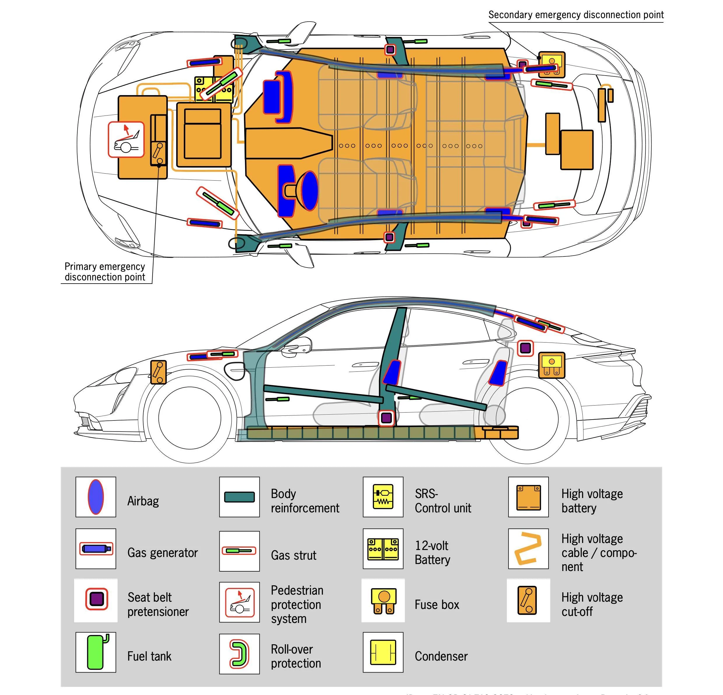

Everyone's got their own appetite for risk, but I'm with @Hirschaj on this one. That wire is crossing over the one curtain airbag (supplied by a single gas generator) in at least two places (near the A and C pillars).
I know my insurance company (CHUBB) well enough that they wouldn't be happy with it.
From the Porsche docs they supply to rescue services:
Porsche Taycan Fitcamx dashcam installation Screenshot 2023-01-13 at 08.59.53
Full doc attached.

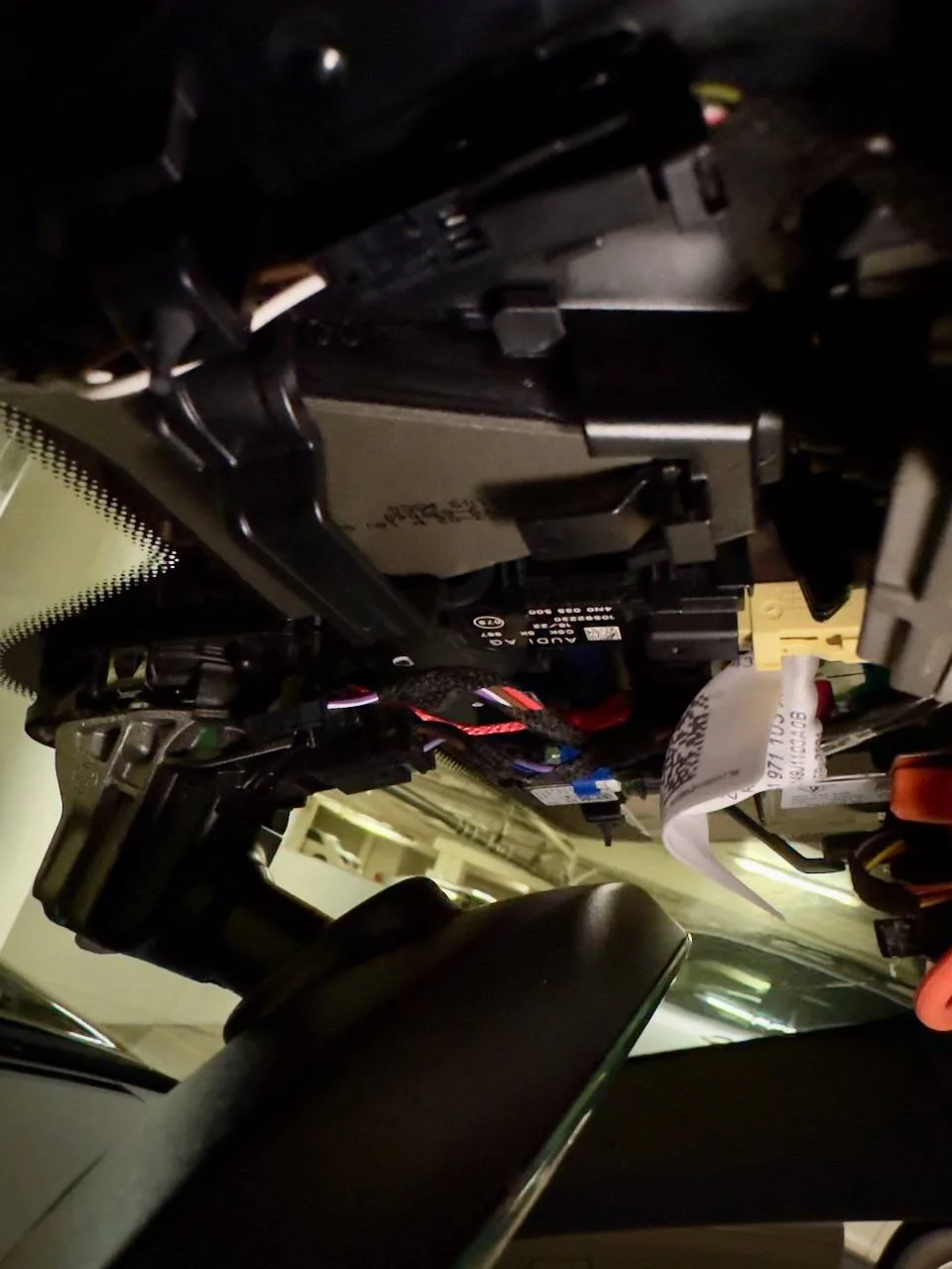

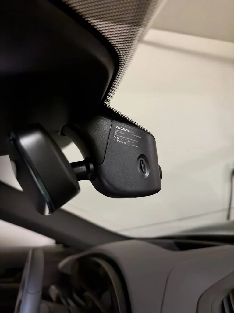

I'm about to do mine. As I understand it, there's some kind of tab that has to be removed to get the middle piece out. Do you have any pics/details from that?
Did you twist off the rearview to do the install, and if so did you remove either of the two smaller trim parts before you did it?

Yes, about 20-15 degrees. It’s a little fiddly to refit, but not too bad.
Can confirm. Easy off, less easy back on.
