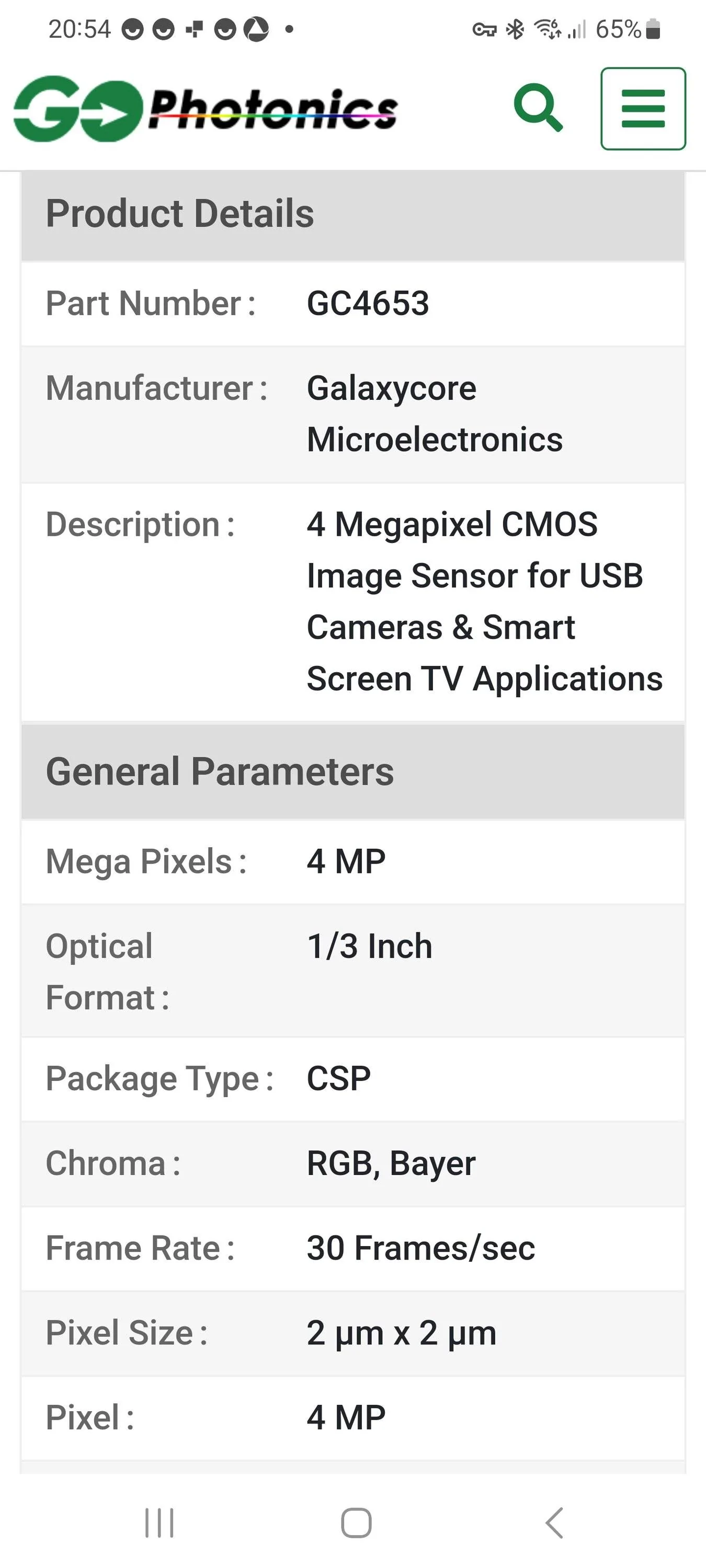

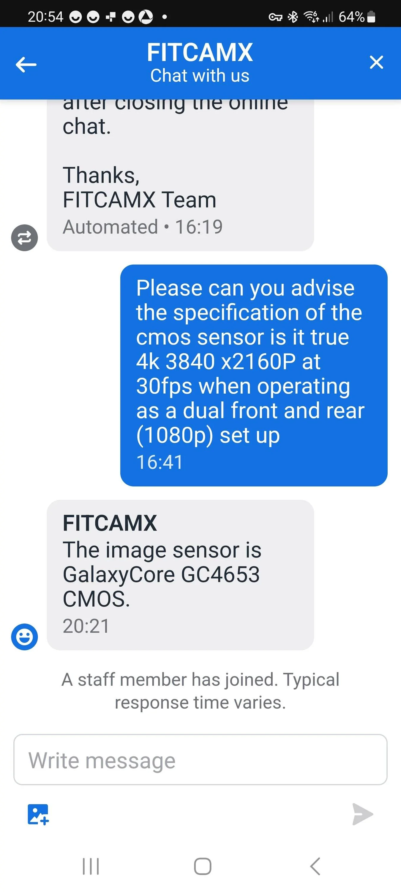

Viofo A139 Pro is a vastly superior camera to the FitcamX. The FitcamX is only 2K with a 4mp CMOS sensor, whereas the A139Pro uses the very latest Sony Starvis 2 IMX678 sensor, which is true 4k 3840x2160P at 30fps

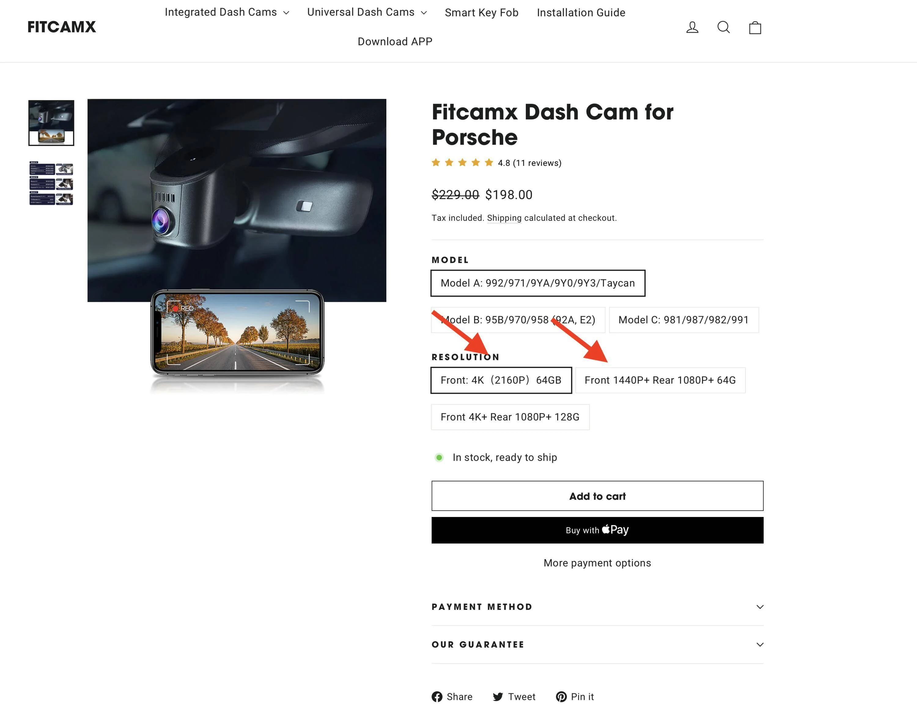

Don't disagree re: the sensor quality. But FitcamX has a 2K and a true 4K variant (which outputs 3840x2160):

Interesting.
I used to have their "4K" camera installed. Would it help if I shared a quick sample file from the camera ?

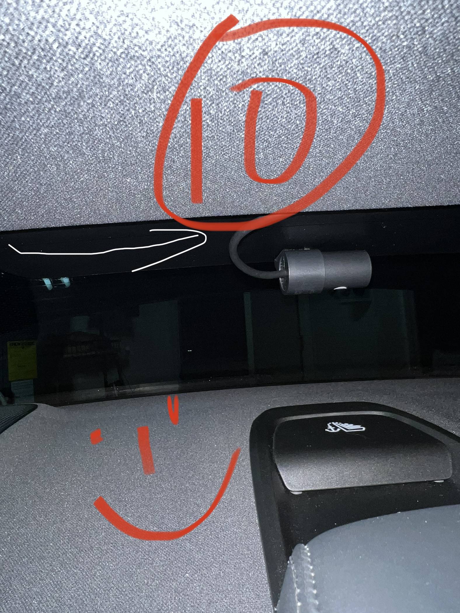

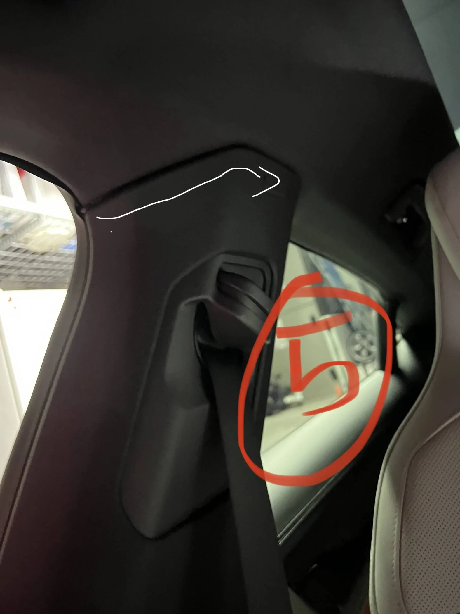

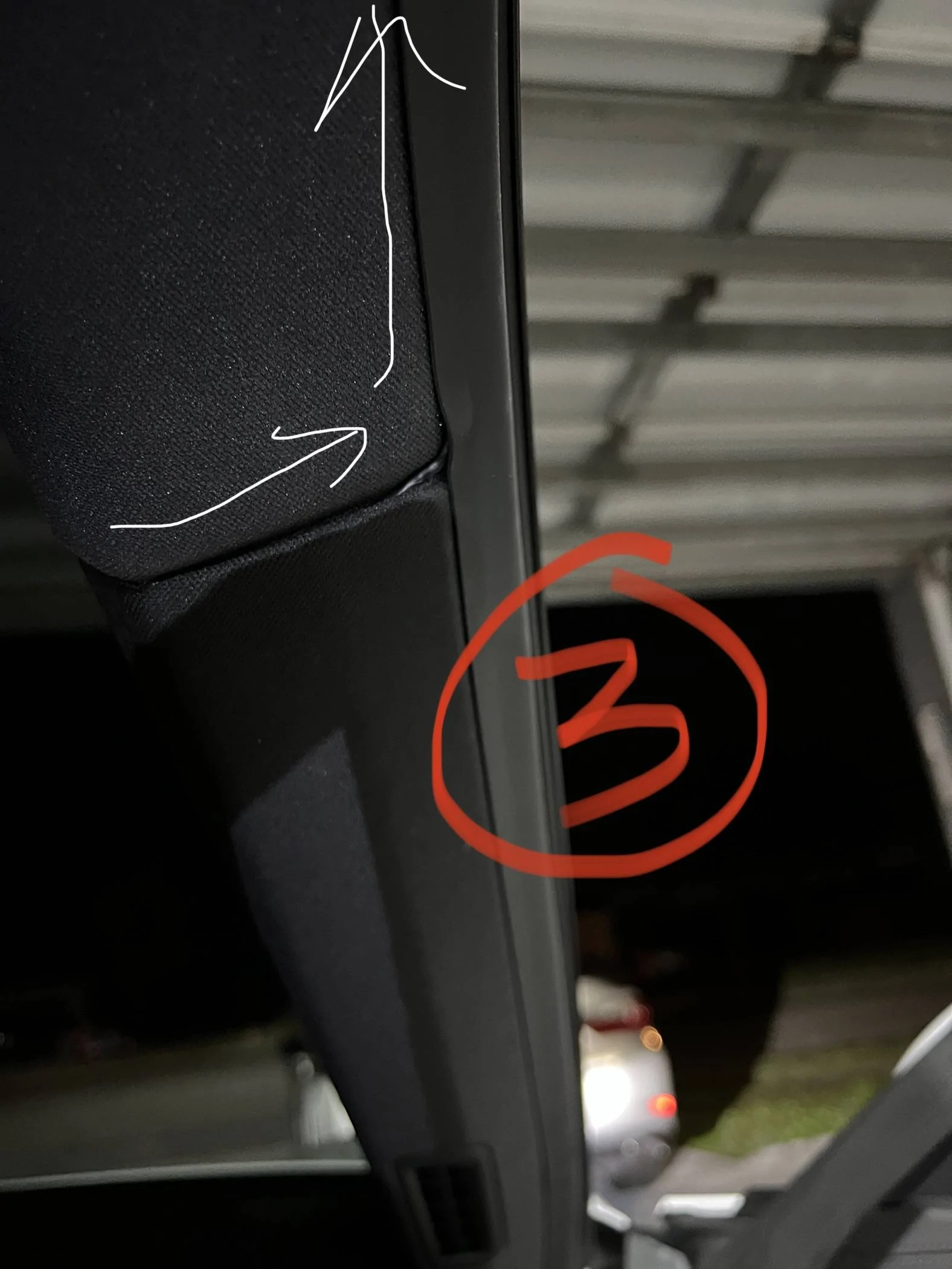

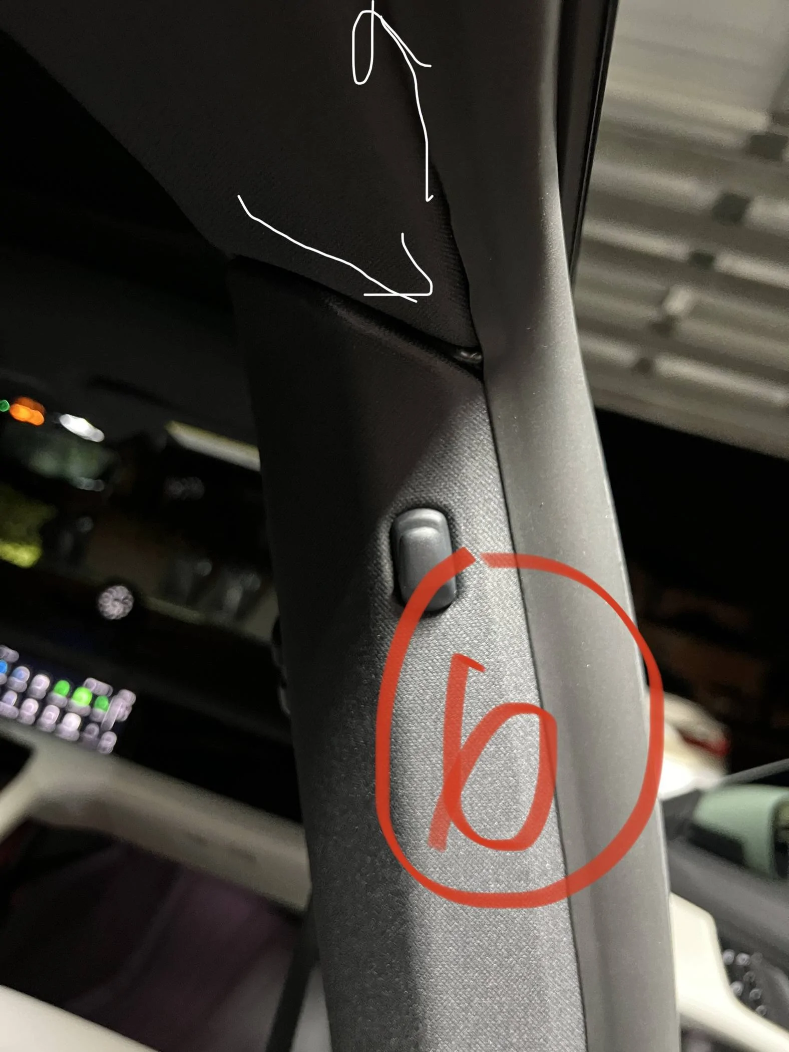

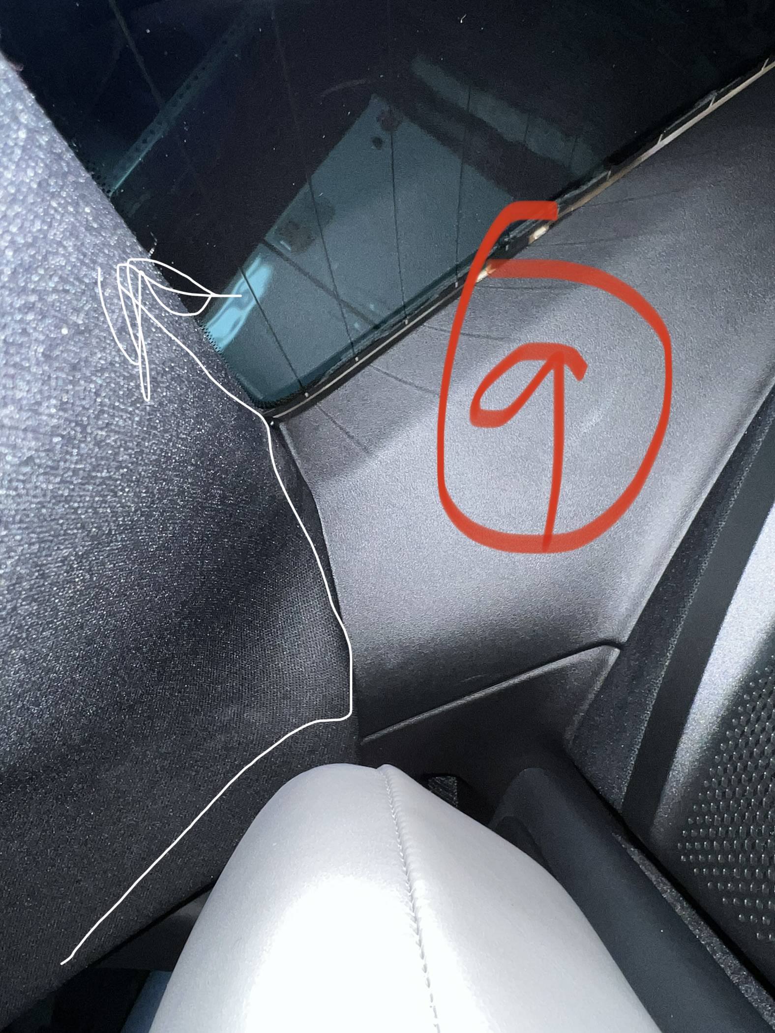

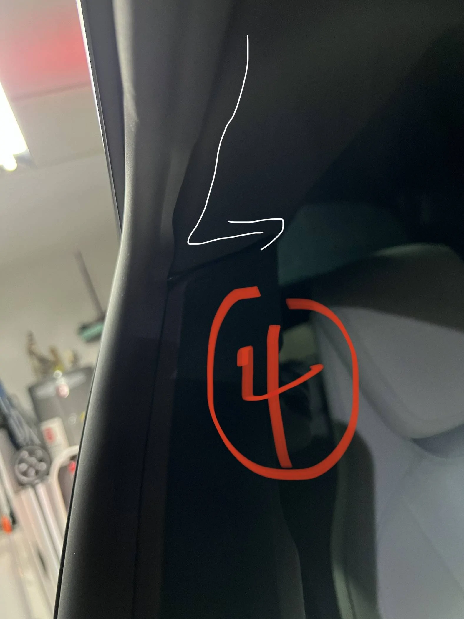

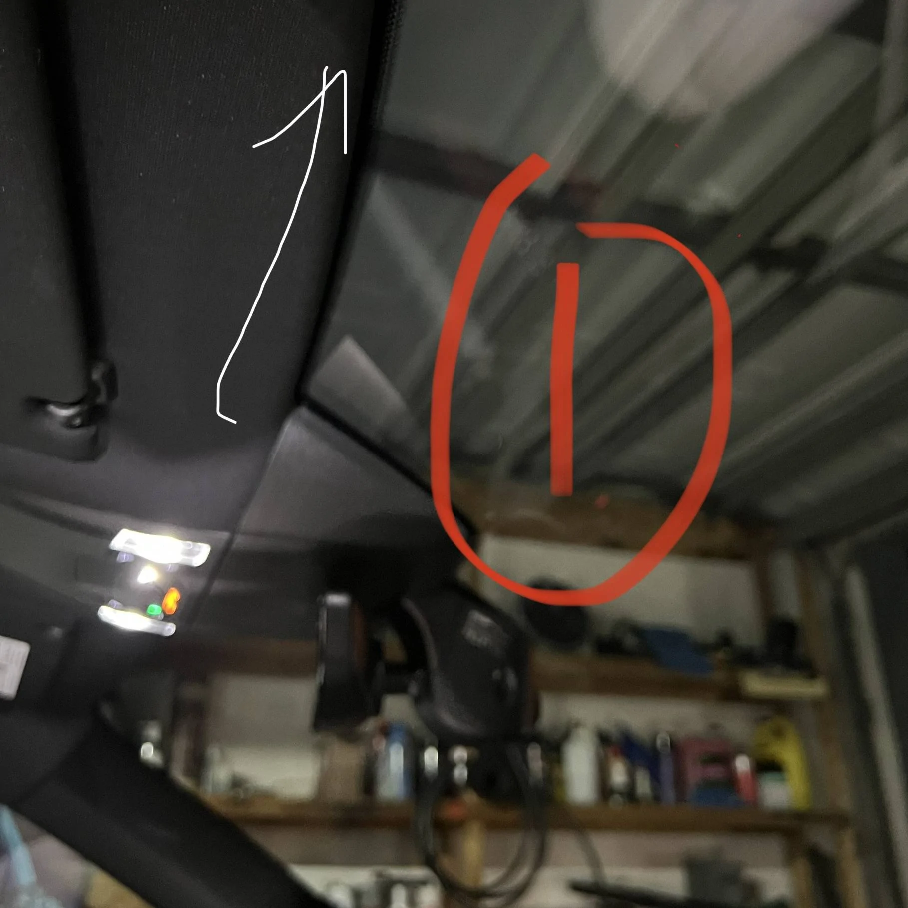

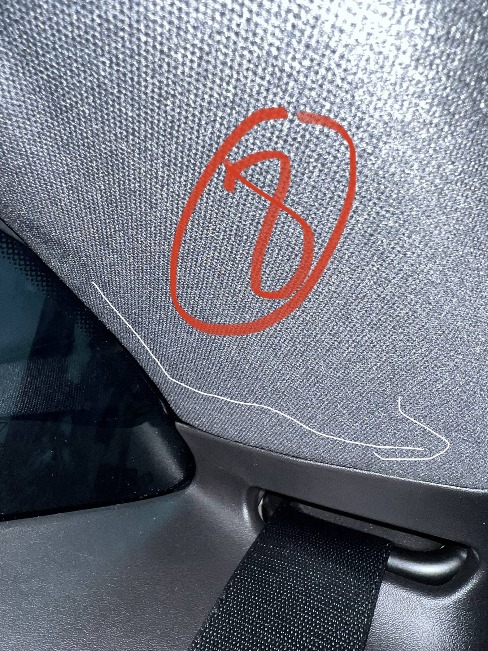

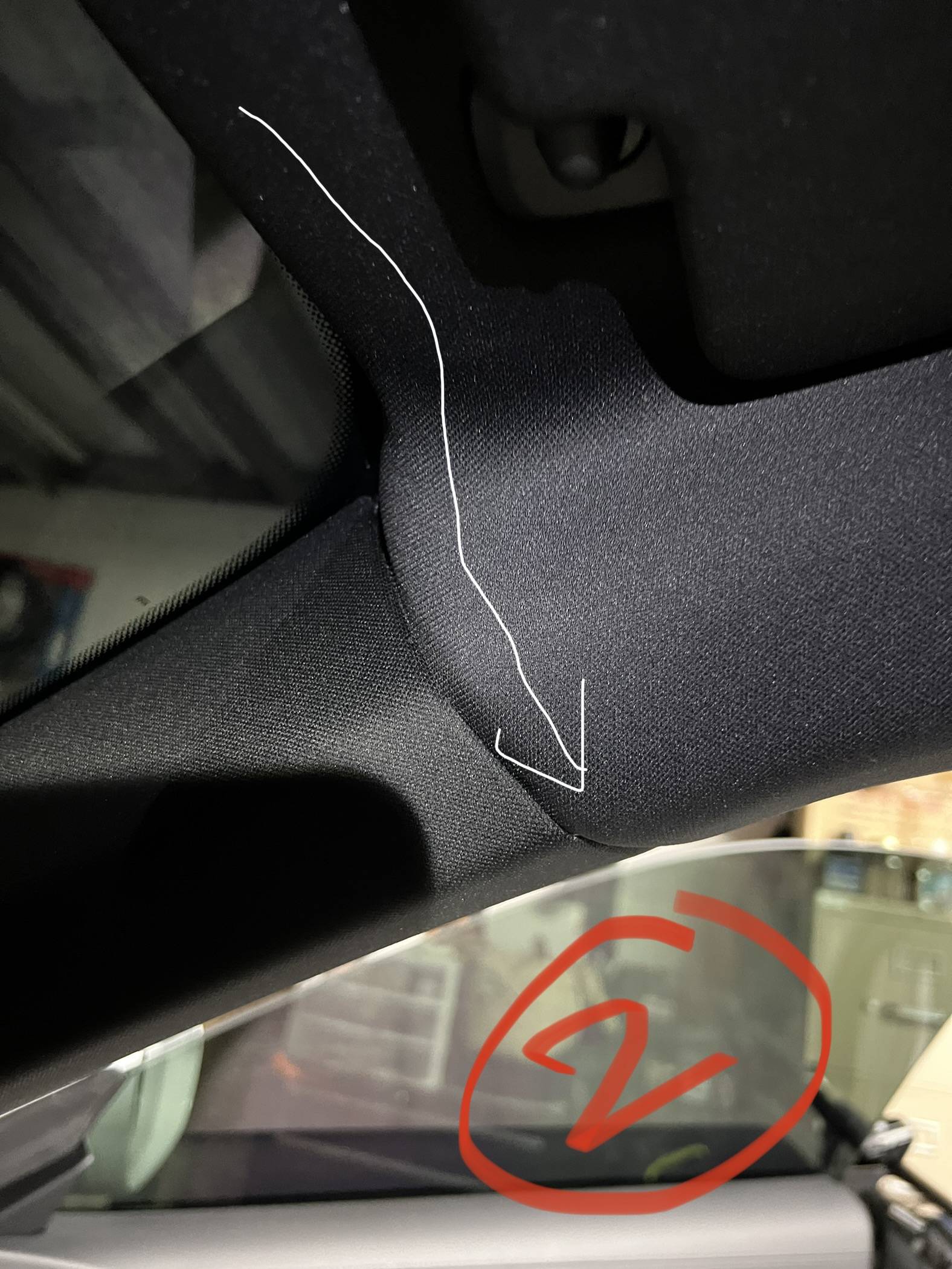

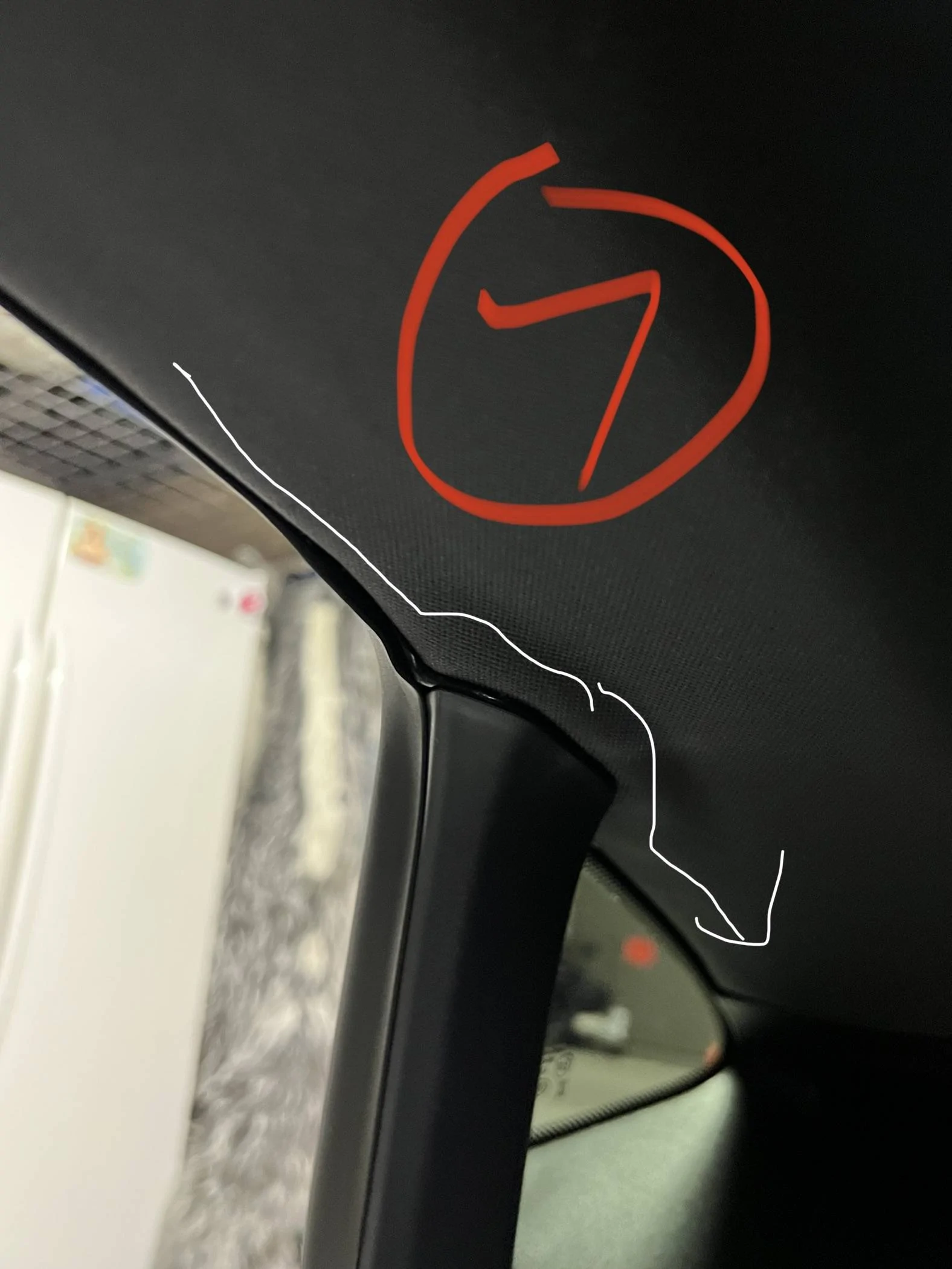

Ok guys so finally got the cojones to install the rear fitcamx ?
I basically pushed in the cable through the roof liner , down the A pillar then through the door weatherstrip, top of B pillar then through rear window weatherstrip and back. Finally tucked it over the 3rd light liner and done. You’re going to have a lot of cable left over just tuck it inside rear top liner.
Took about 20 min without taking anything off just using a plastic tool and a credit card.
You can see a little cable showing in some areas but since everything is black you can’t really notice in person.
The cable is pretty thick to tuck but it doesn’t look bad at all.
Sorry about the pictures hopefully they can help. The pictures are not uploading in order so I had to number each one.

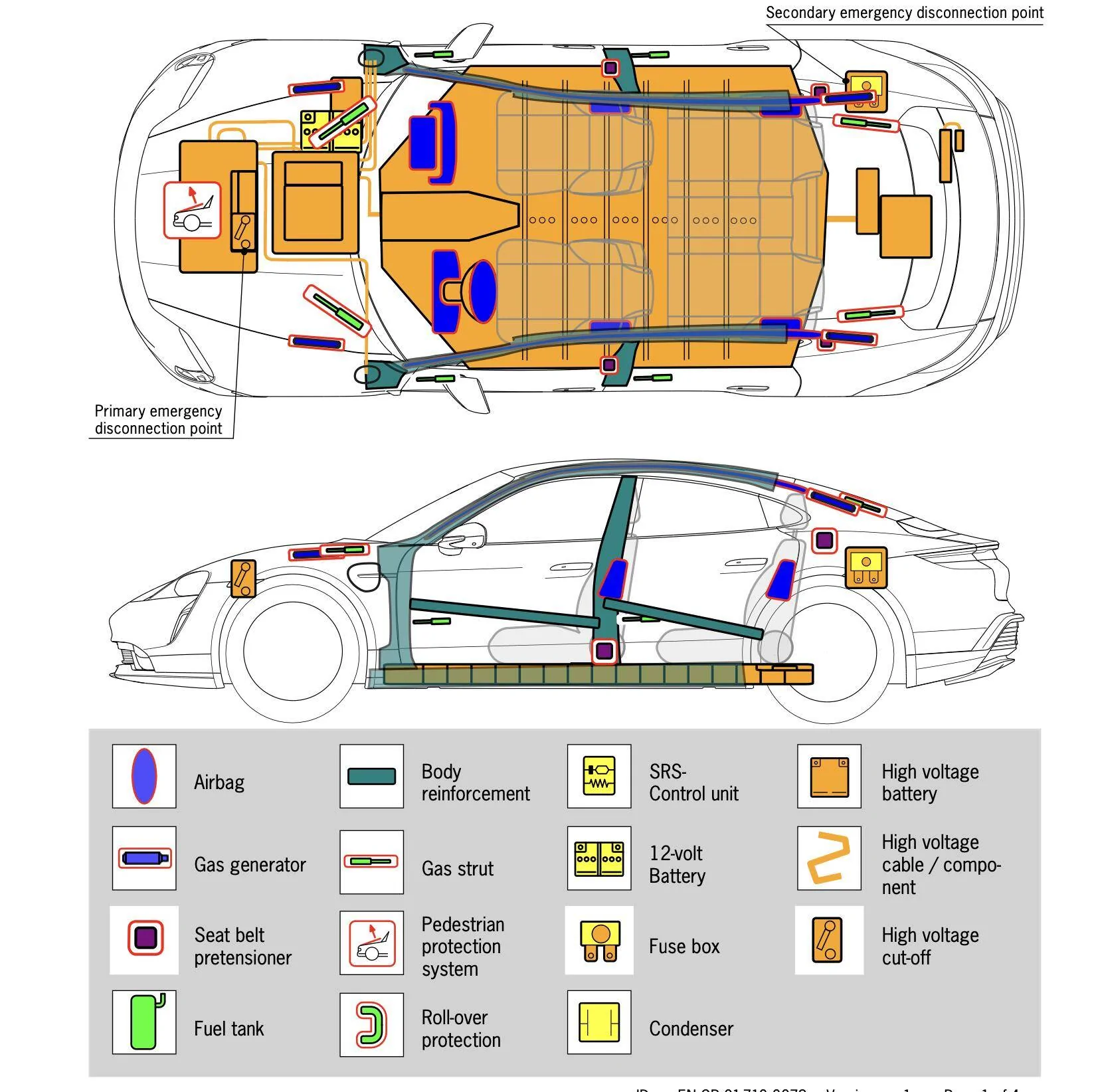

I would have thought that you would want to avoid any airbags, in the a pillar, curtain bags over the windows and in the b pillar, and maybe around the rear door too.
I installed a front and rear camera in my son’s Volvo c60 by putting it under the kick plate. I took the a pillar interior trim off to get the cable behind the airbag. All very simple and avoided airbags too. It was easy enough to get it up to the rear window. Ok, I know it’s a different car but the principal is the same.
You can’t be too careful with airbags, you don’t want to restrict their deployment.

You sure there's an airbag on the A pillars? I had that crazy idea that it was mandatory to identify airbag locations and all my cars have a small SRS symbol on every airbag around the car. Never saw an SRS symbol on taycan A pillar pics.
95
3,518
7,927
Dublin, Ireland
www.targatrips.com
Defo airbag in A-pillars.
Porsche Taycan Fitcamx dashcam installation 1673462233454

I applaud you for successfully running the cable from front to rear but… there are airbags in the A pillar and along the entire length of the roof. I would worry about negatively impacting their functionality during an accident with that routing. The only clean way I can see of running this wire is down the A pillar behind the airbag, across the bottom of the car in the lower door trim, and back up to the roof near the rear seat back.
I was able to pry back the top of the A pillar and pop out 1 of the clips that holds the pillar on. I peeked inside and saw the airbag in there. Maybe this weekend I’ll be brave enough to try and pop the whole pillar off. I pulled the outside top corner of the passenger A pillar towards the steering wheel to safely pop that top clip off. I think the pillar will fully pop off by tugging the rest of it in the same direction.
