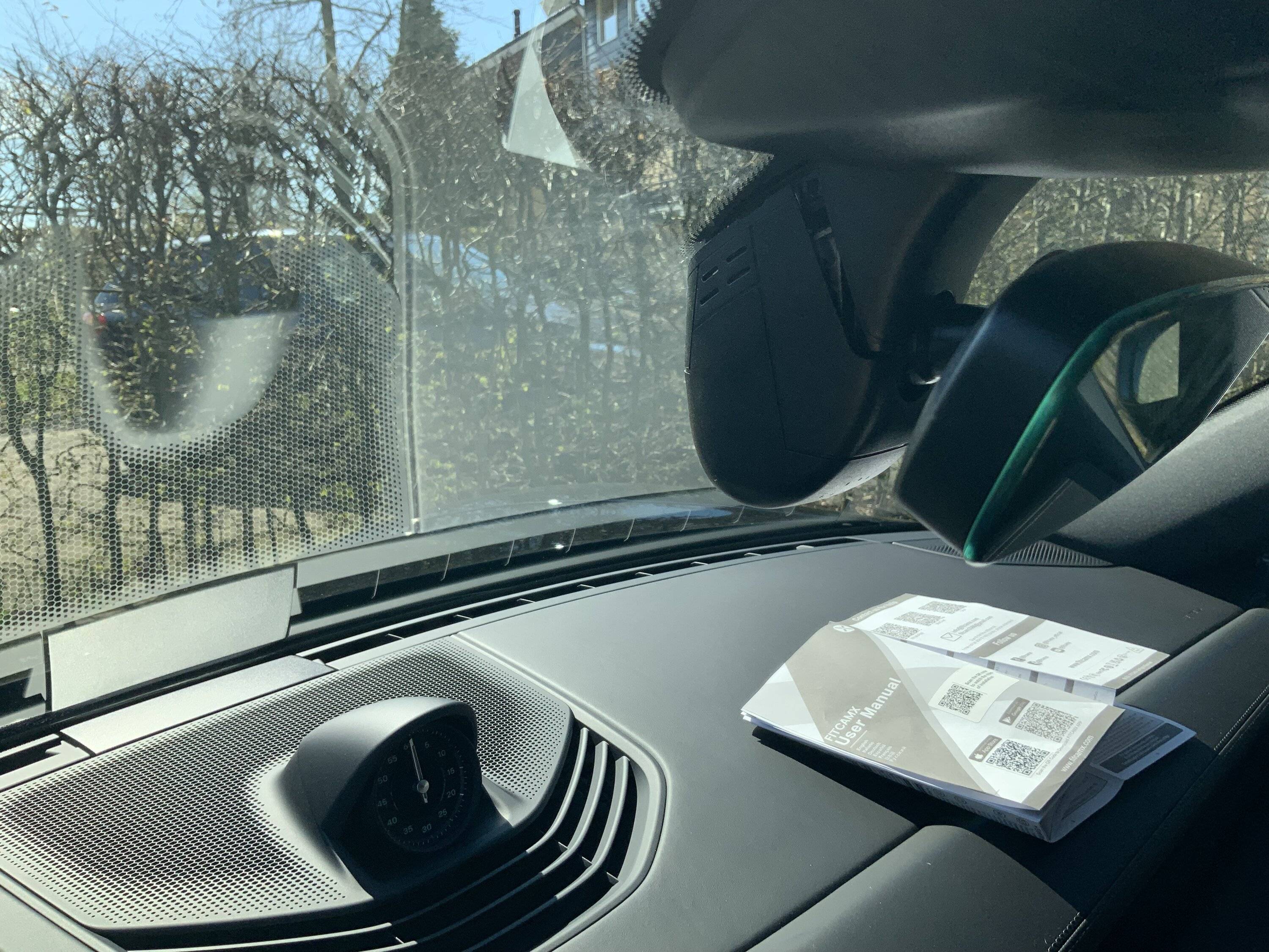

This dropped out? Anybody knows where it sits?
and how do i get the cam to click at the middle part? If comes close but doesn’t lock?

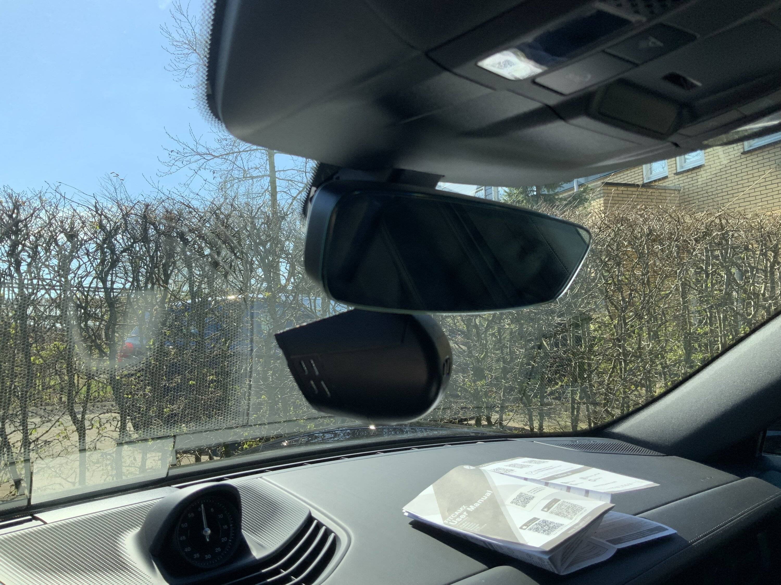

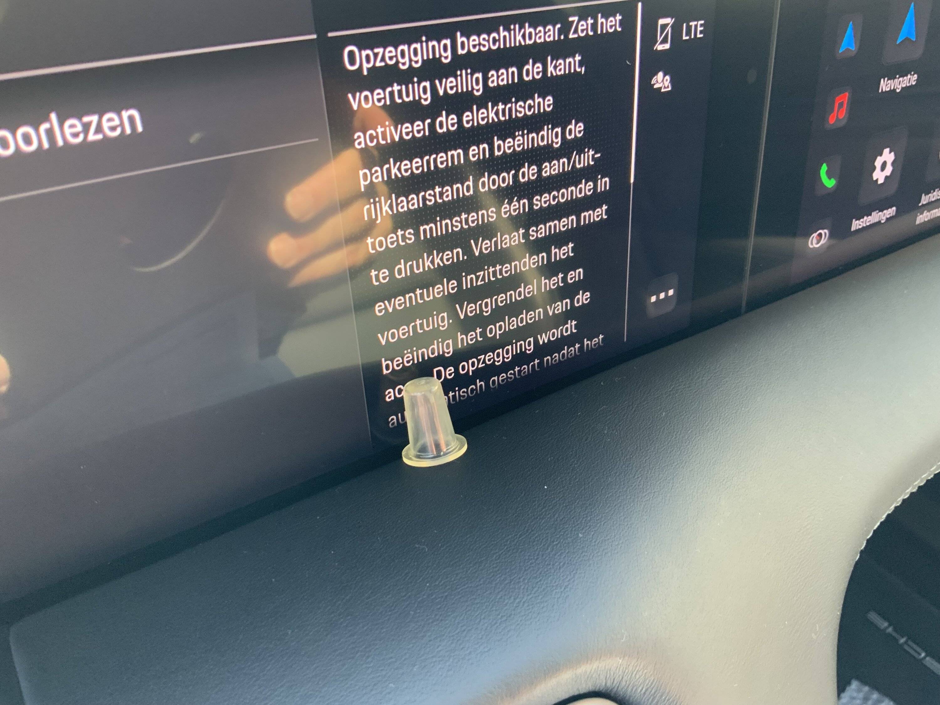

So got it connected and it works, but for the love of god, I can’t get it to click on the socket and slide into the middle piece. It sort of hangs loose one the metal socket and does not secure?
any tips?
