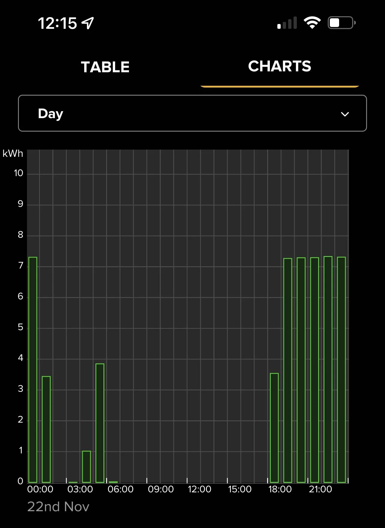

Naturally don’t have my Taycan yet but the chart below shows the pre-heat on my iPace. From memory it was about 2C that day when I set off at 6AM, it did have a brief charge up to midnight (100%) but from checking in the past that won’t have put much heat into the battery and it will have cooled some. You can see when the battery preheat kicked in (cabin heating is the last half hour only). Battery was 18C when I left (using car scanner as no dash display in iPace unlike greatTaycan batt temp info). Meant I could happily enjoy the car off all the A1 roundabouts without holding back ?.
Sorry, I must be thick but I can't discern any of that from the screen shot - only shows kWh of the charging session - what am I missing?
