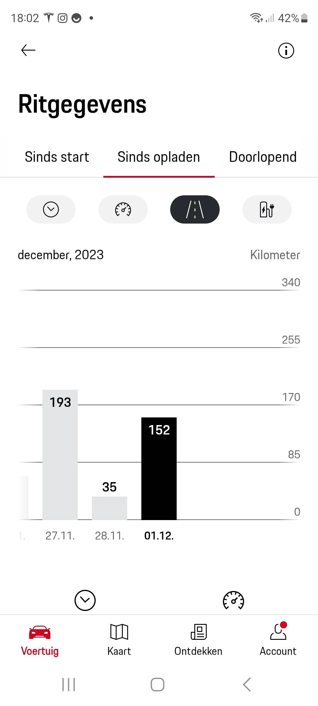

Massive loss here. Current temp around 0 C on average. Doing abt 41kW/100km. Lucky if I get 250km out of a full charge, driving like a granny, which I can't and won't. 200km range is more likely. 21 inch rims with 315 tires behind and 275 in front (winter Pirelli Sottozero 3).
20% left and 153km driven since last 100% full charge.
CT Turbo S on 21 inch winter set up.
