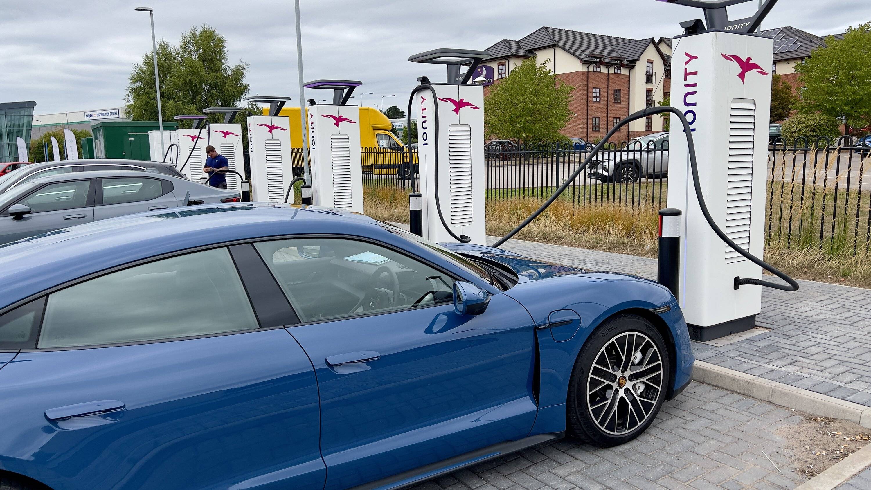

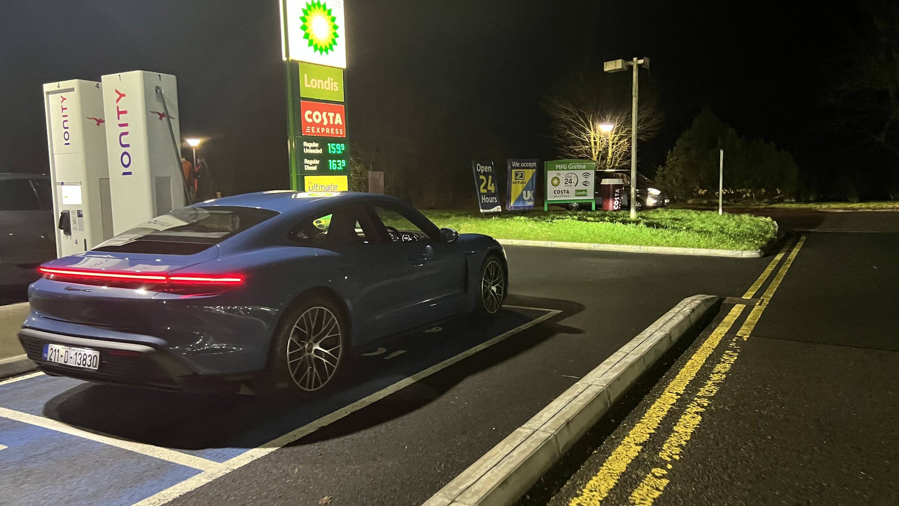

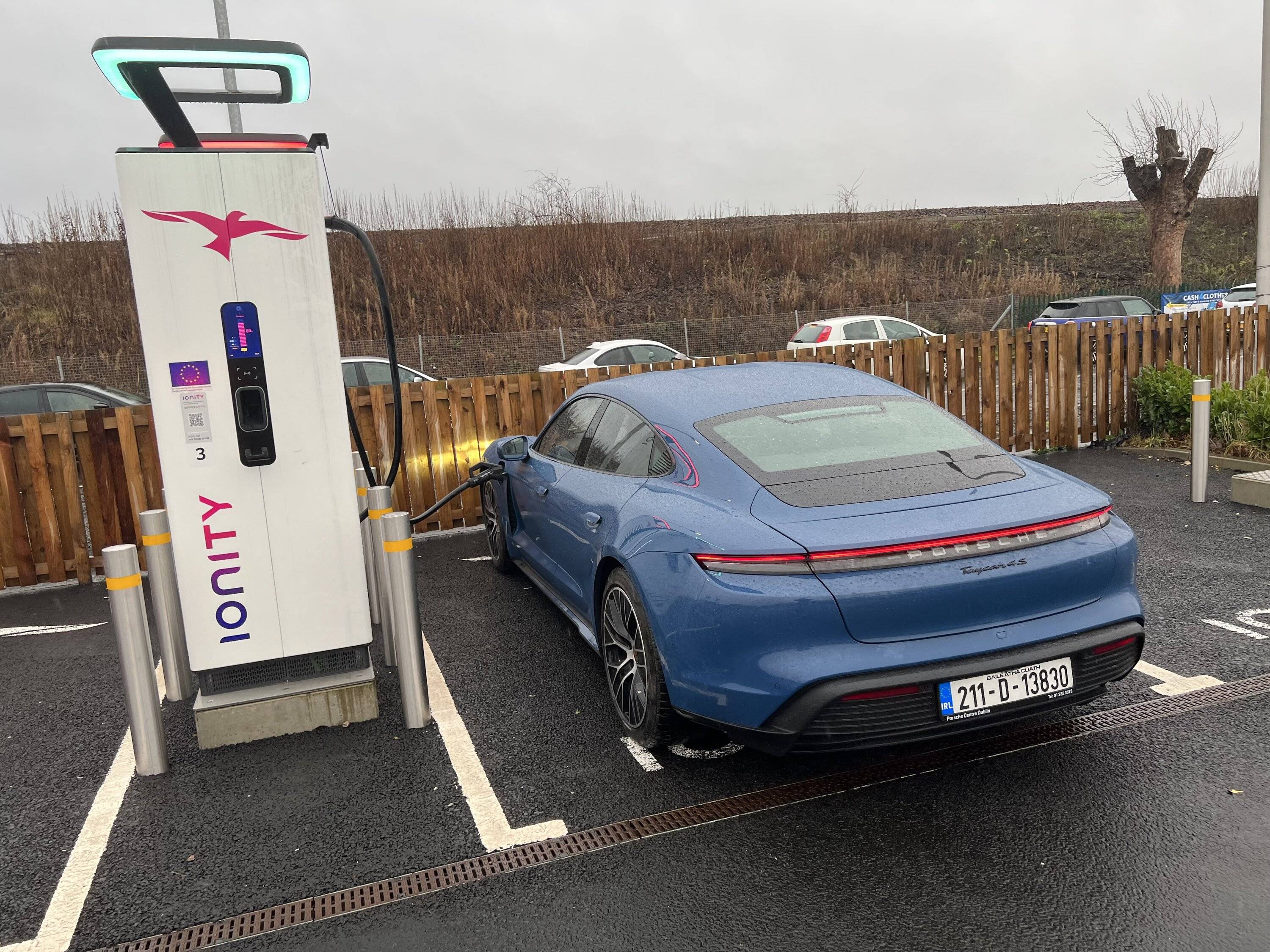

All three are great. Gretna Green is a busy one, they could do with more pedestal's but the queuing there is disciplined.
Stafford

Gretna Green

Perth
