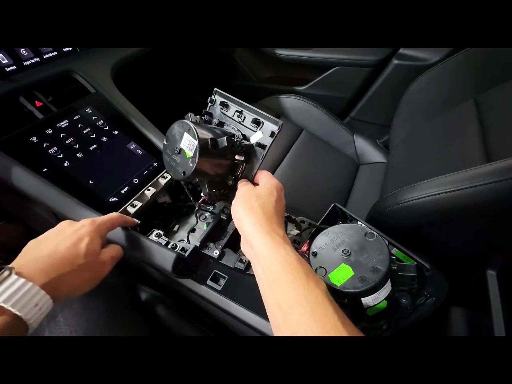

There’s a video on how to remove the nearby cup holder so you can inspect that location for loose fixings if that helps …

I have some bad news for you - the climate touch screens break and something starts to rattle inside with similar symptoms.
Let's hope it's just a clip.
Here's a video with sound:
