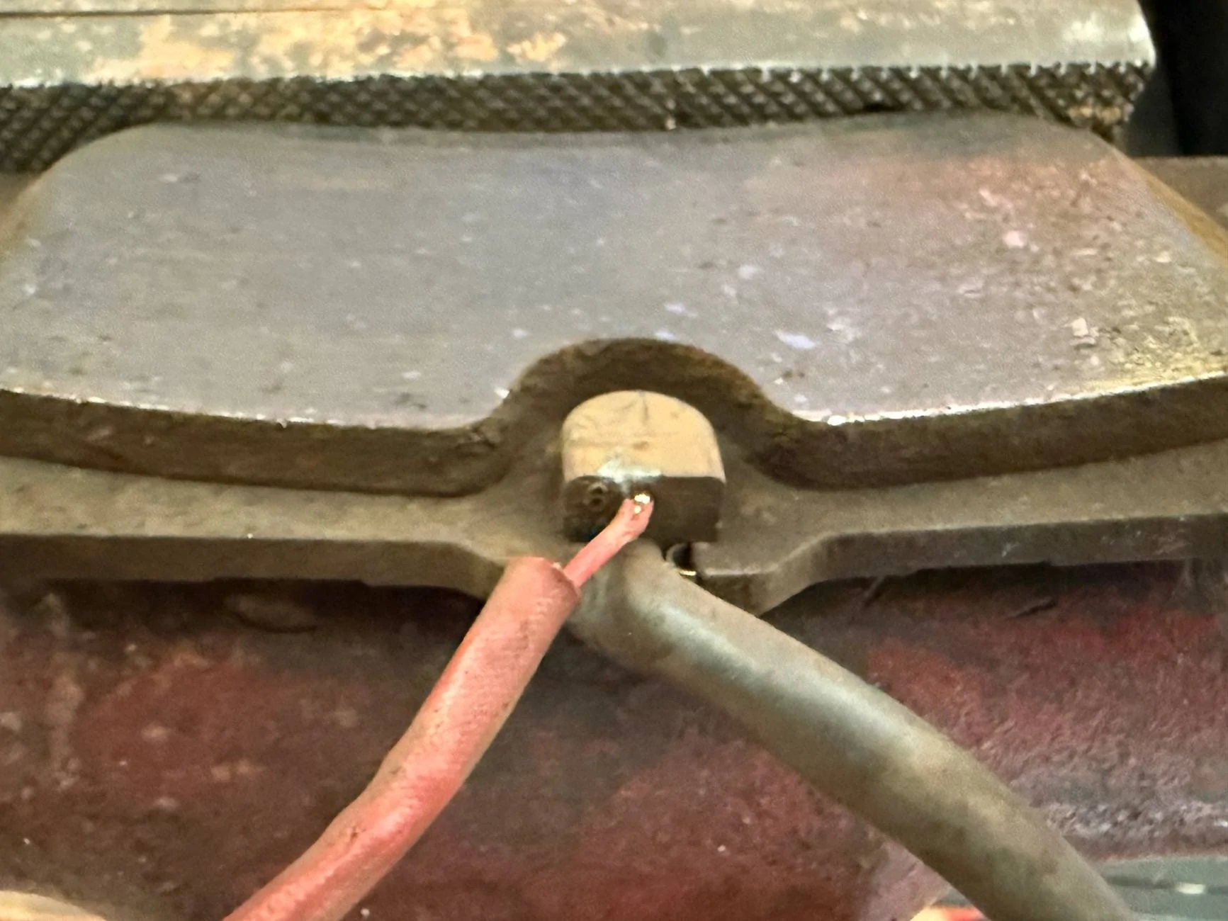

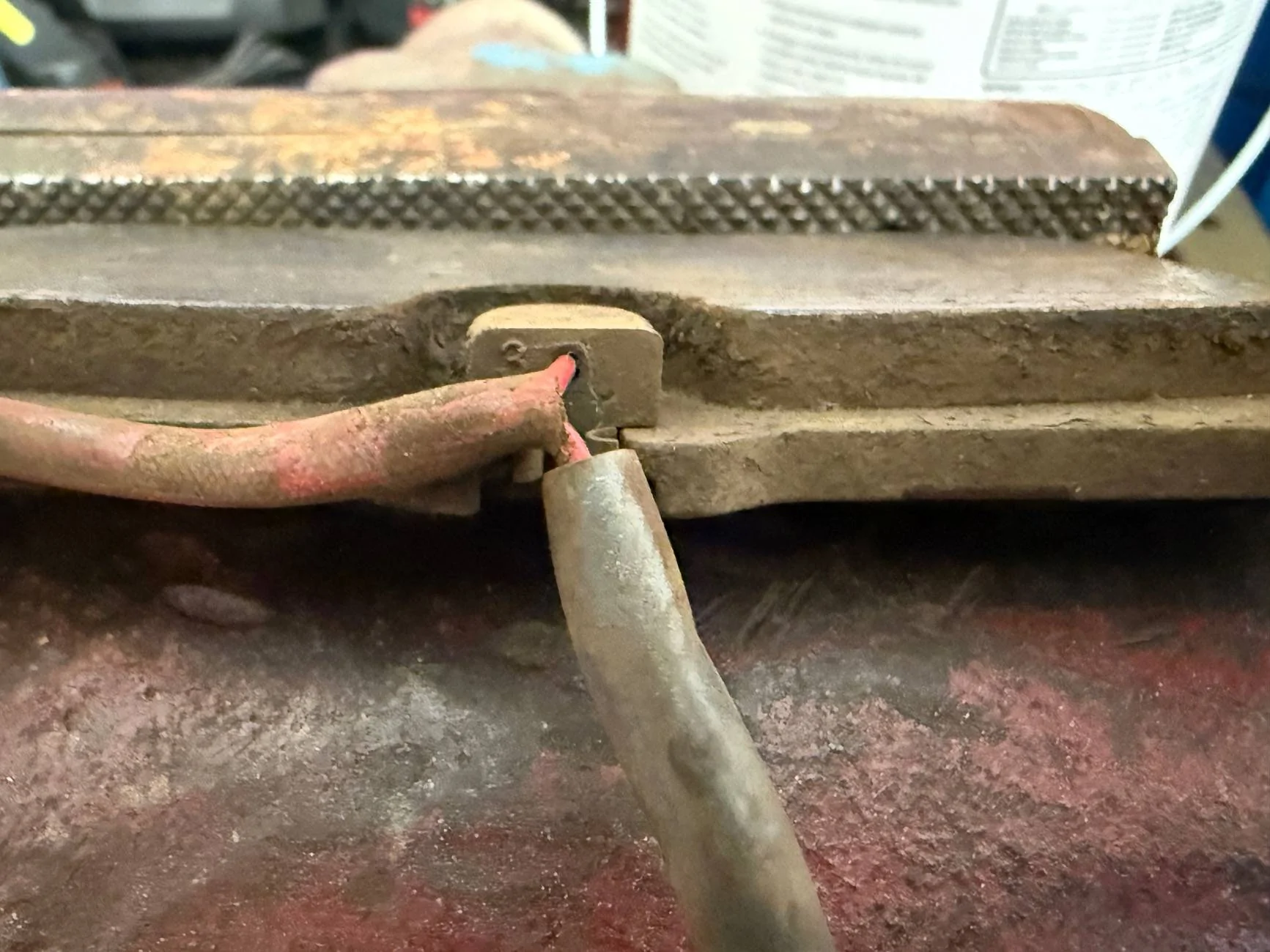

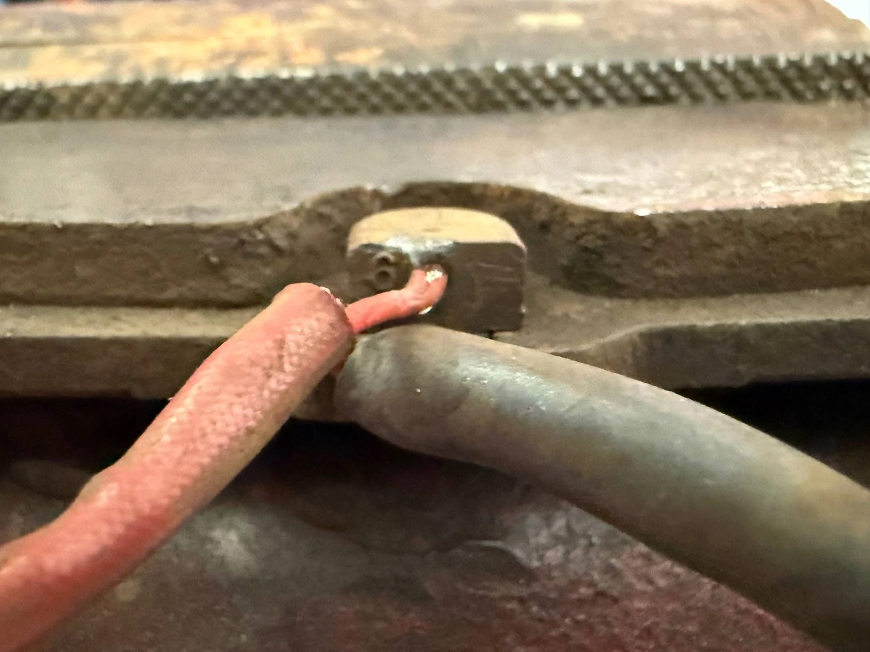

For those interested I changed the rear pads and rotors yesterday. I measured the old pads and found them to be 6.22 mm or .244 inches thick. Also I could not find any evidence that the wear sensors had made contact with the rotors to illuminate the warning light I got. I did not have access to a scanner to perform the parking brake adjustments but didn't have any trouble installing the new rotors. I double checked and when applied the parking brake locked the rear wheels.
