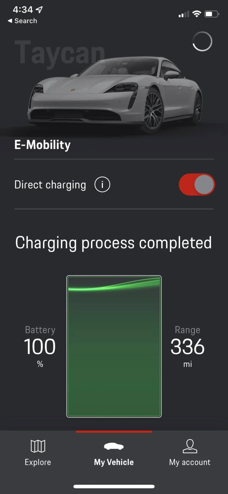

Check it out. I typically charge to 85% per my Profile. I accidentally left Direct Charging on overnight and was surprised to see 336 miles for a 100% charge.
I would estimate that 80% of my driving is on local roads at under 50 MPH with the remaining 20% on highways at +70MPH. So that my explain the significant range.
I can’t say that I’ve actually driven 336 miles on a full charge but this is at least the highest capacity I’ve seen or heard of. Fingers crossed is approximately accurate!

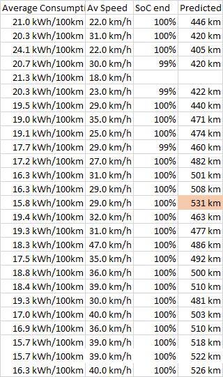

As for range anxiety, doesn't Porsche have a range estimate based on current conditions (including your driving style so far) and perhaps your destination?
Porsche Taycan 336 Miles at 100%! 1630729983096
Highest range was 330 miles. Maybe it's possible to analyze this data to see how the prediction works?

I did a couple of measured tests as to how long it takes the car to figure out your driving style and adjust the estimated range. The test involved driving at a constant speed of 115 kph / 71.5 mph for the whole trip and determining when the difference between estimated range and actual range travelled reached zero.
I figure the car uses about the last 15 minutes of your driving history to forecast your range.
But a caveat. The loads on the car have to be constant. Same speed, no elevation changes, constant temperatures and no head or tail winds. If any of those come into play, than the forecasted range will change. Which makes sense.
The range estimate the cars shows when you first turn it on is just a guess and may not reflect actual range.
