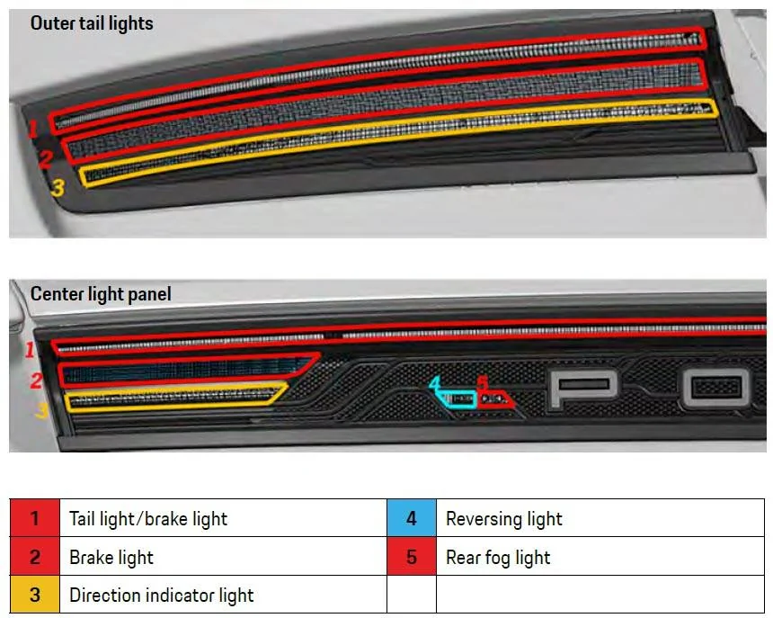

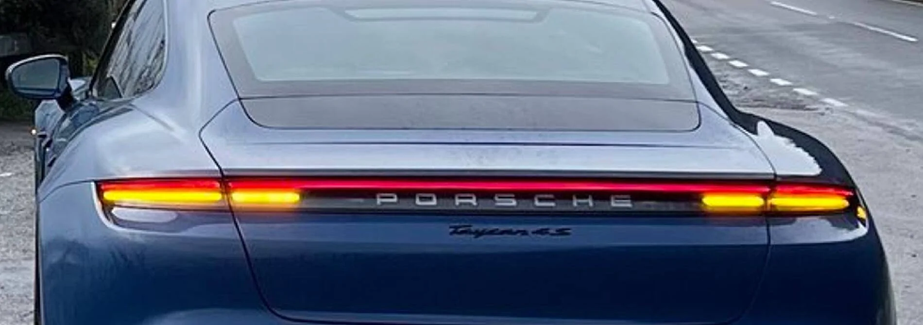

From post #7, it's supposed to work like this for turn signals outside of NA:
Also from 2020 Taycan technical manual:
Thanks! Those are helpful.
I agree. One would assume if the ambers for outer housings are acting like NA spec outer housings, the center direction lights should as well, light up during braking. I'm thinking perhaps the center logic is a bit different. As you mentioned before, the center could be faulty but I hope, hope.....the likelihood of that is low since there are no faults and it's basically brand new from Suncoast.

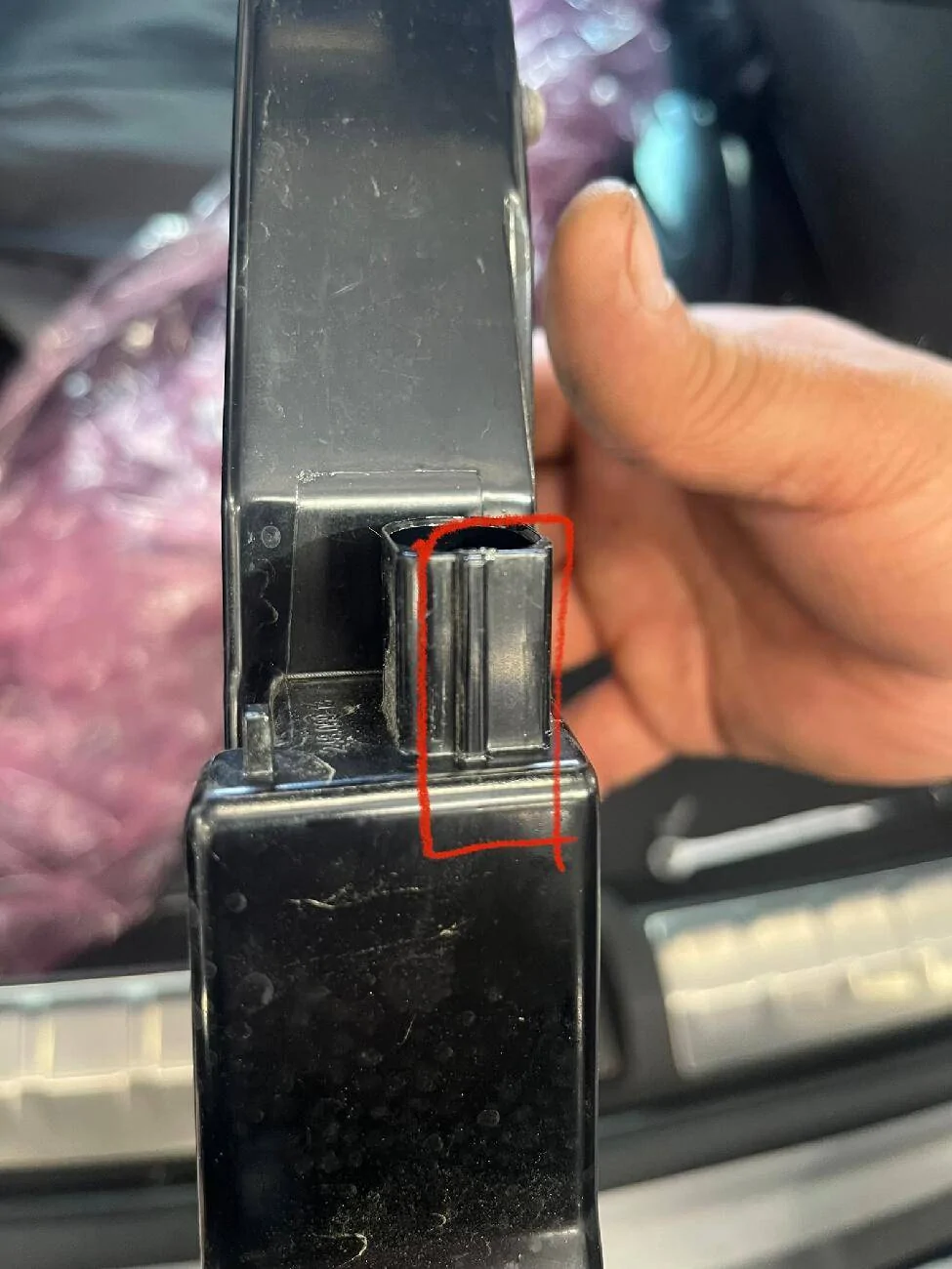

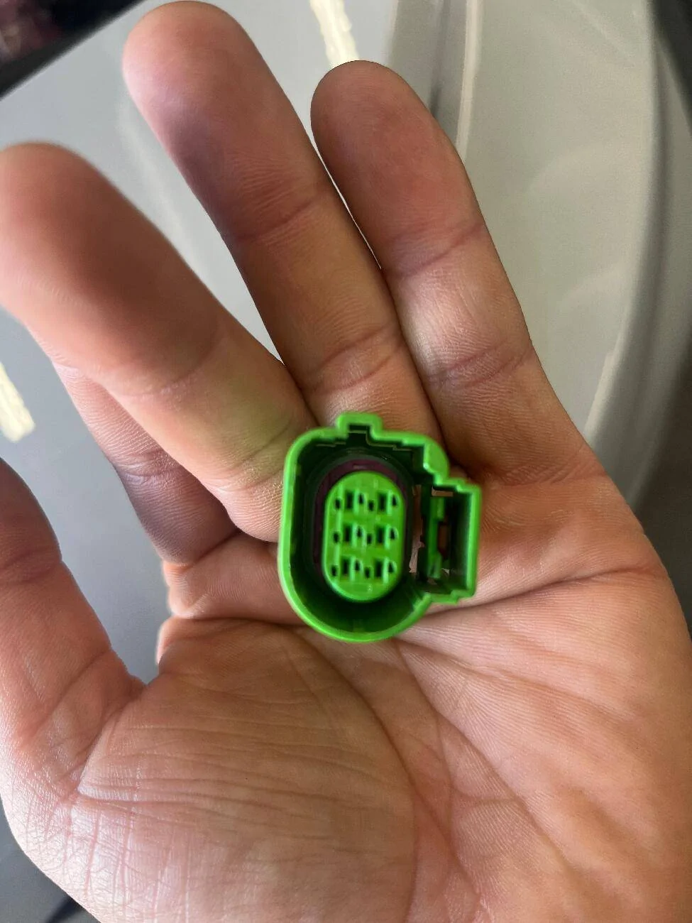

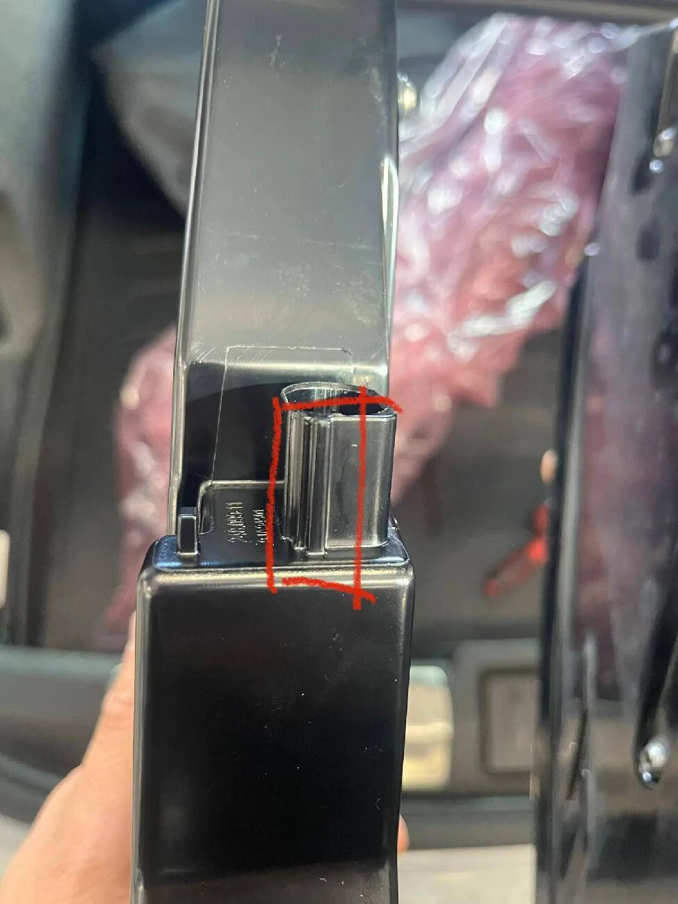

So there is no difference in the pinout, just the connector was thicker or something? It would be nice to see some pictures of the parts and the connectors.

Maybe @mystermykee has some pictures handy, but AFAIK it's same connector just keyed differently, so you can just sand down some plastic key ridges to make it into a universal/unkeyed connector.

These pictures are from the body shop (Porsche approved collision center/where my local Porsche dealer sends all their cars) where I got the lights installed. Didn't get a picture of the pins on the male side, but per our phone conversation everything is the same except for the socket. The outside NA plugs have the ridge to the left, whereas NA is towards the middle.
Porsche Taycan Rear lights color in USA 73024293997__89D0F671-E3D9-4396-ABE9-0A614FB6CF61
Porsche Taycan Rear lights color in USA IMG_7797
Porsche Taycan Rear lights color in USA IMG_7798

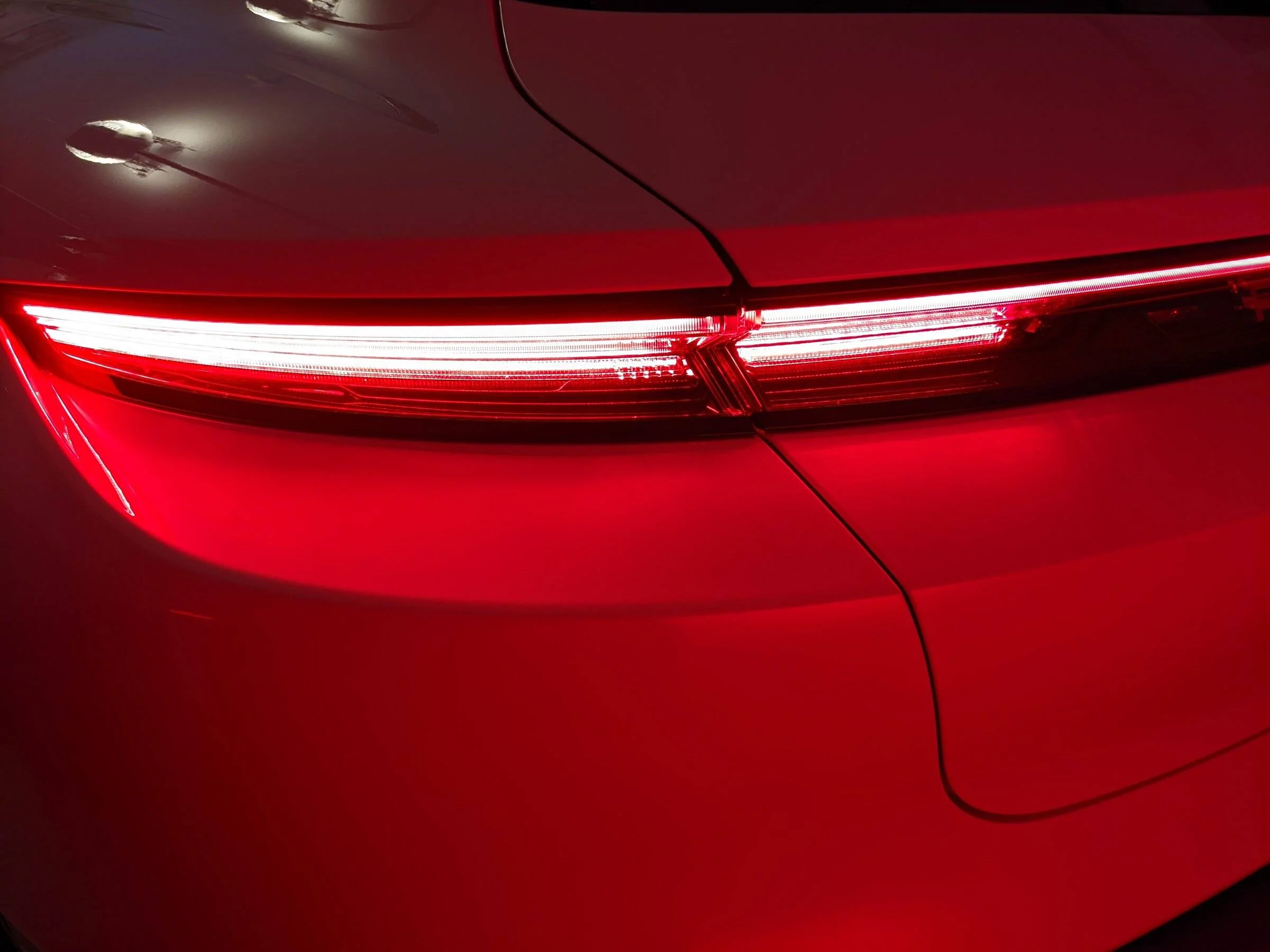

Ok, for those interested, here is the comparison between the US tail lights and their operation:
vs. Euro tail lights (this is a retrofitted US car)
I will be posting a retrofit thread in the next few days, for anyone interested in swapping.
Great work, please share your retrofit notes and findings!
