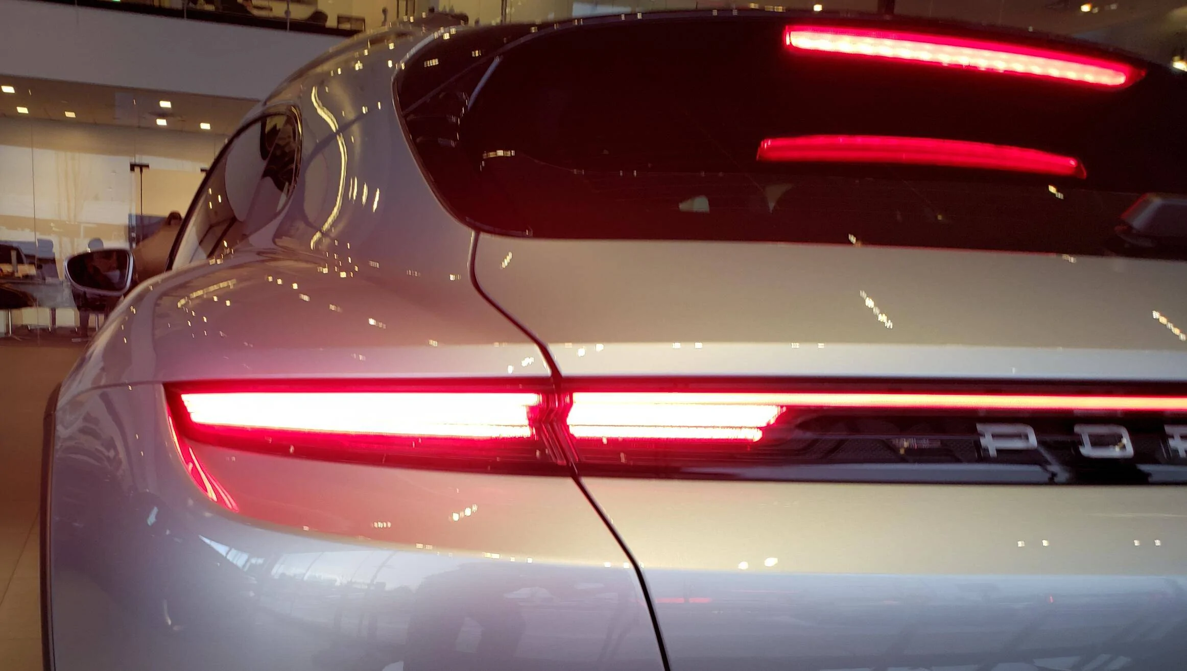

@tigerbalm (or anyone else with a non-US spec CT), what does your car look like from behind when your stop lights are on? Does the same light turn yellows or red depending on whether you are signaling or braking, or perhaps only one of the 3 levels (bottom maybe) is used as the blinker and the top two are brakes, or some other solution?
An up close picture (showing individual segments lighting up like below) of a non-US CT rear lights with the brake lights vs. directional blinkers (better yet, a video of blinkers in yellow while the brake lights are on) would be much appreciated. :) This is the USA model closeup:

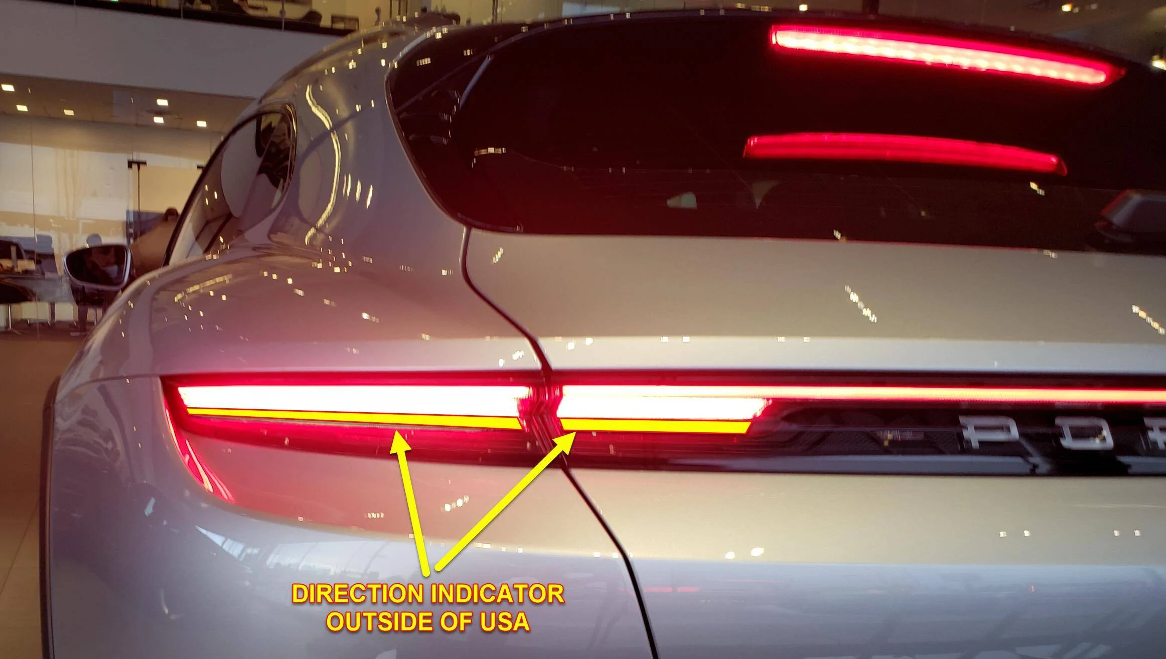

After some digging through the internet, I found out that the non-USA, amber direction indicators (blinkers) use the very bottom light bars on the back, as show in the picture below.
Porsche Taycan Rear lights color in USA 1641722094294
Since these bars light up together with the stop light in the USA, the question is whether or not the decision to light them up in in the BCM2 module which controls the rear lights, or is the logic in the light itself. Some day, when I actually have a car to play with, I could snoop the LIN bus going to the lights, and see if there appear to be separate commands to light up each bar, or just messages telling it "tail light on/off", "brake light on/off", "direction indicator on/off" or "start/stop blinking direction indicator". If the latter, then the Euro style rear lights (outer rear light unit and the center rear light unit/panel) should just work in the USA. If on the other hand BCM2 lights up each bar individually, then it would take BCM2 firmware update to make it work with Euro lights, which would make it much more complex retrofit.

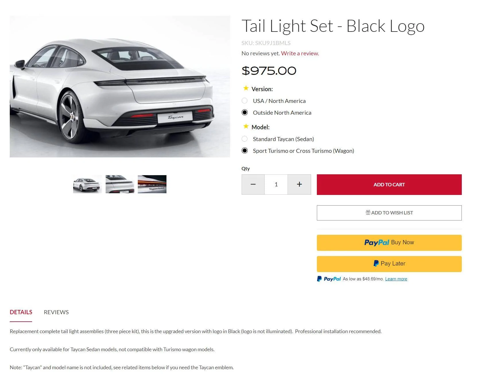

I went looking for this tail-light set and it now seems to have an updated (since I looked a while back) description which says it has all 3 pieces for $975 (installation needed separately)!
Porsche Taycan Rear lights color in USA 1686093609592
https://www.suncoastparts.com/product/sku9j1bmls.html
I wonder if I was to order the "Outside of North America" part, whether the dealer could install it and enable the non NA blinker operation (i.e. separate from brake lights), and what it would cost to install by dealer, or can I just swap it myself and it will "just work" without any ECU reprogramming.

Just a quick update, I inquired with Suncoast and got the following response:
The color of the blinkers is different between the models, red in our region and amber outside North America. Also, the connectors are slightly different, and only the correct version can plug in the car's wiring harness.
We have done the Outside North America tail lamp swap on a 981 and also a Gen. 1 Macan. We had to modify the connectors by shaving some tabs so we can plug them in. No issues at all after installation and no programming was required.
We can't confirm if the same scenario is on a 2023 Taycan, sorry. Please consult with your local technician before doing any modifications.
Debating whether it's a $1,000 (and a bunch of work) experiment worth doing. If I knew it works, I would absolutely do it.

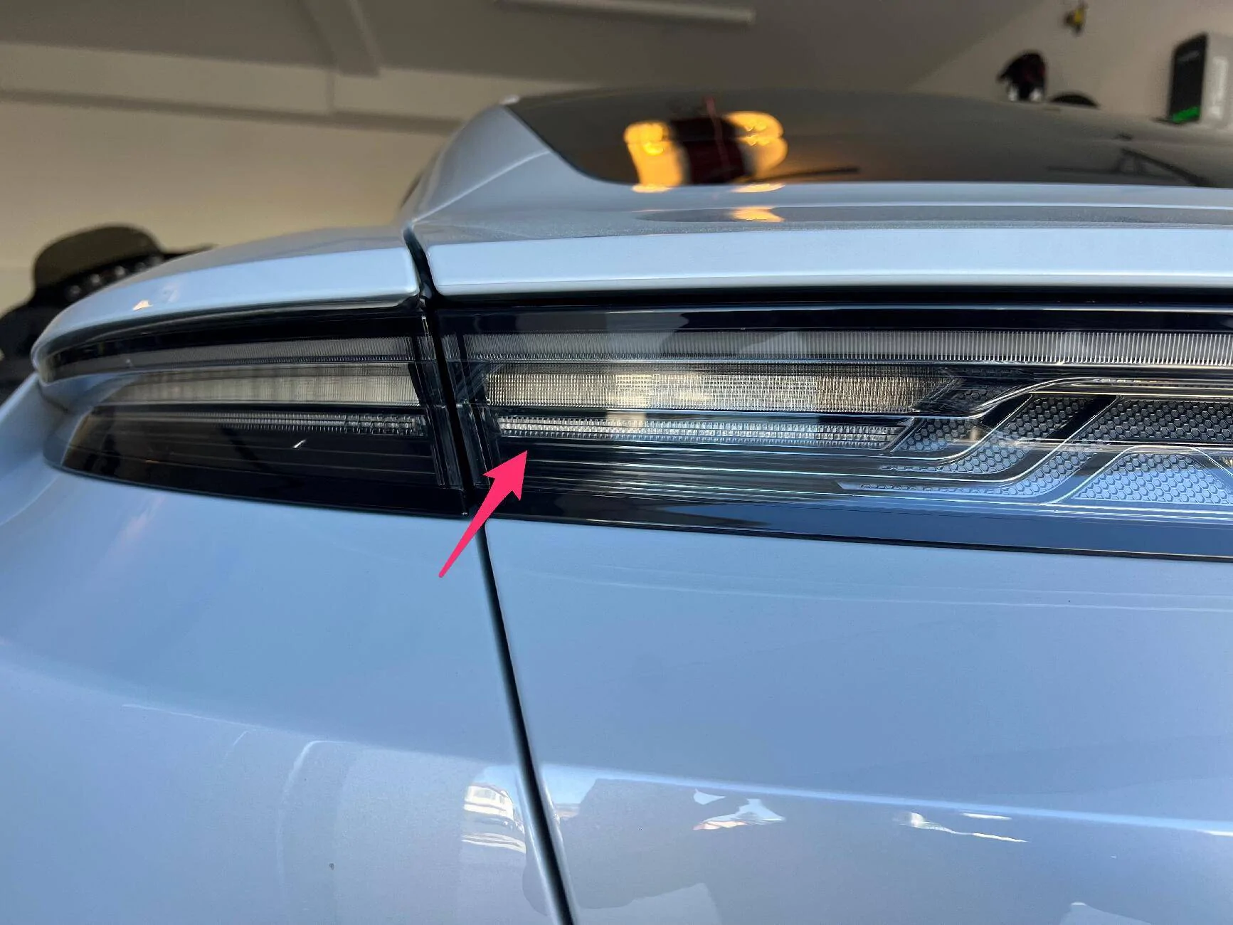

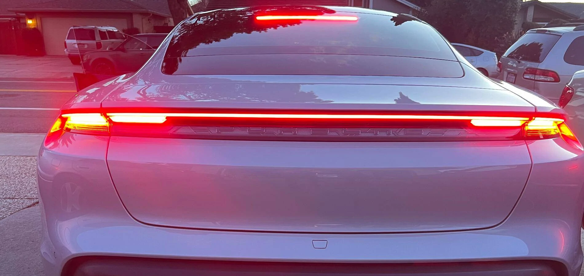

I sure hope they aren't faulty. Wouldn't a fault code be thrown? Here's how they operate right now. I'm getting red lights coming on with the amber blinkers, and the amber blinkers come on when the brake pedal is pressed.

I never paid attention in detail to how the NA tail lights operated, but this part isn't working for me at the moment. I assume that part normally lights up red.

Correct, first picture is with brake pedal pressed--ambers go on.
Ok, so it seems the corner lights are behaving as if they were a US version, only the very bottom bar is amber instead of red (but still acting as both brake and turn signal). Surprisingly the middle bar is not behaving the same. I would have expected the amber part to light up together with the brake/turn signal.
From post #7, it's supposed to work like this for turn signals outside of NA:
Porsche Taycan Rear lights color in USA EU Turn Signal

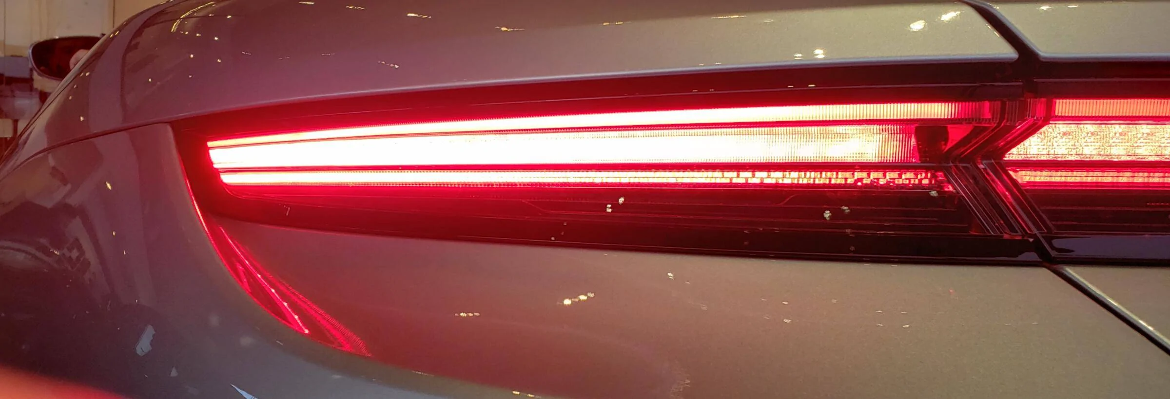

Also from 2020 Taycan technical manual:
Porsche Taycan Rear lights color in USA EU Rear Lights
