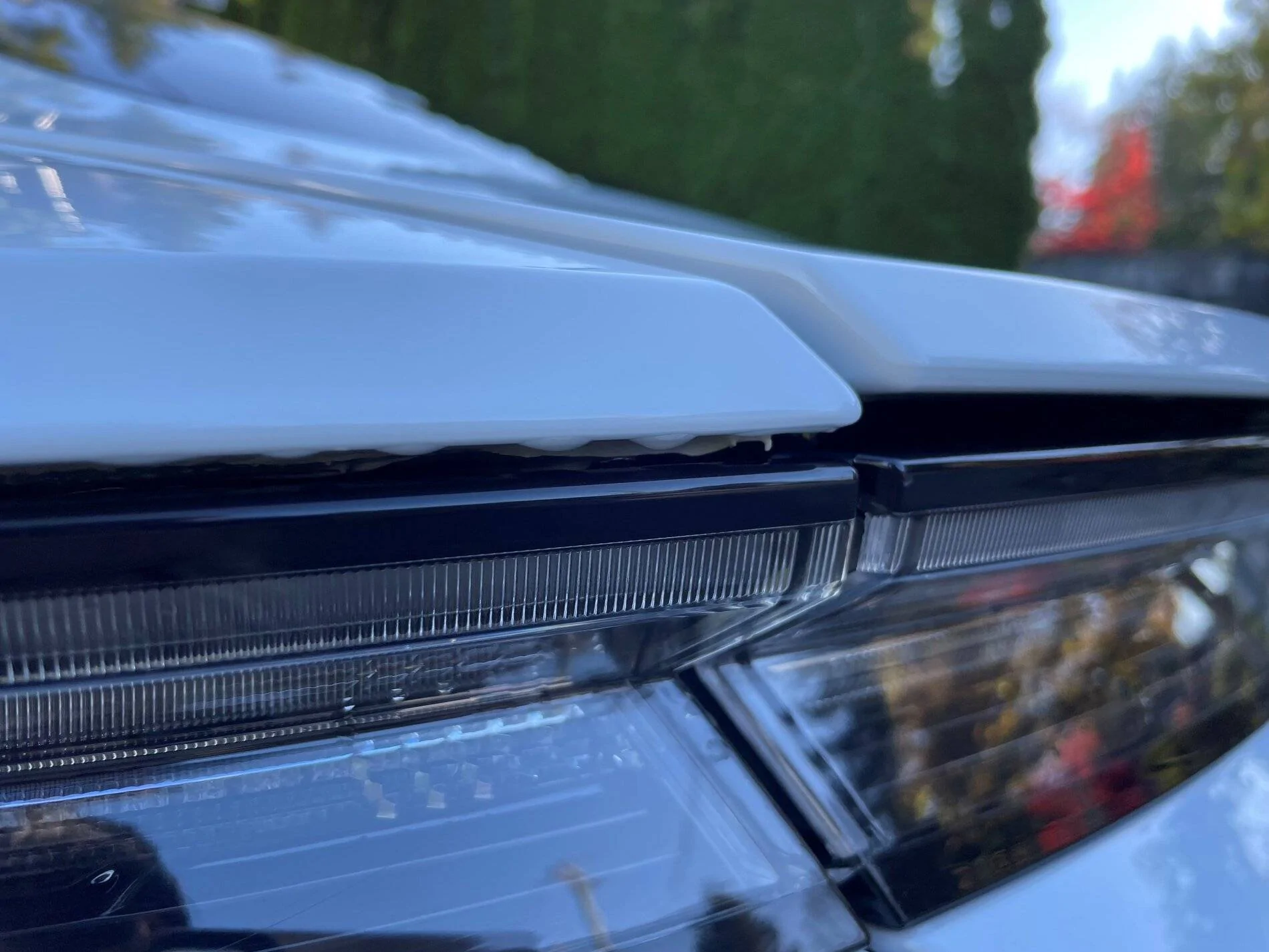

With the colder weather, my spoiler is out of alignment again despite having the support bracket replaced last January.
Has anyone heard of a permanent fix to this issue?
The issue is the materials used and there isn't a fix. Mine is going out of alignment as it gets colder and was perfect in the warmer months. I've had my car for 2 winters now and so this is the cycle.
There was talk of replacing the spoiler but nothing became of that. It is annoying as Porsche have had active spoilers across the range for years now and I've not seen this problem on any model other than the Taycan.
