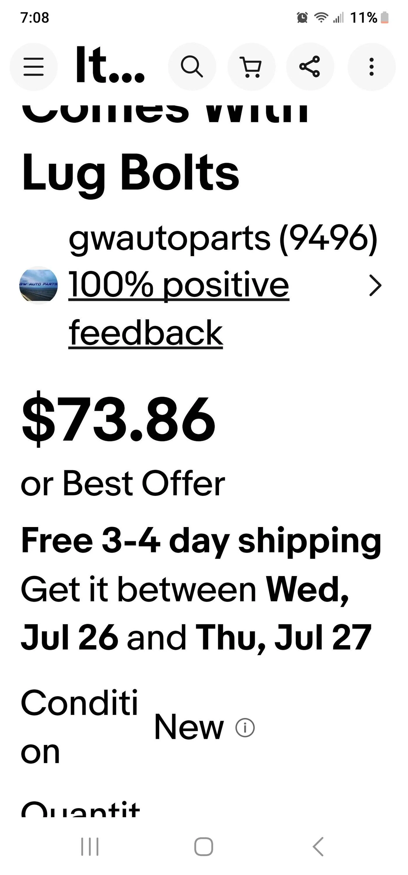

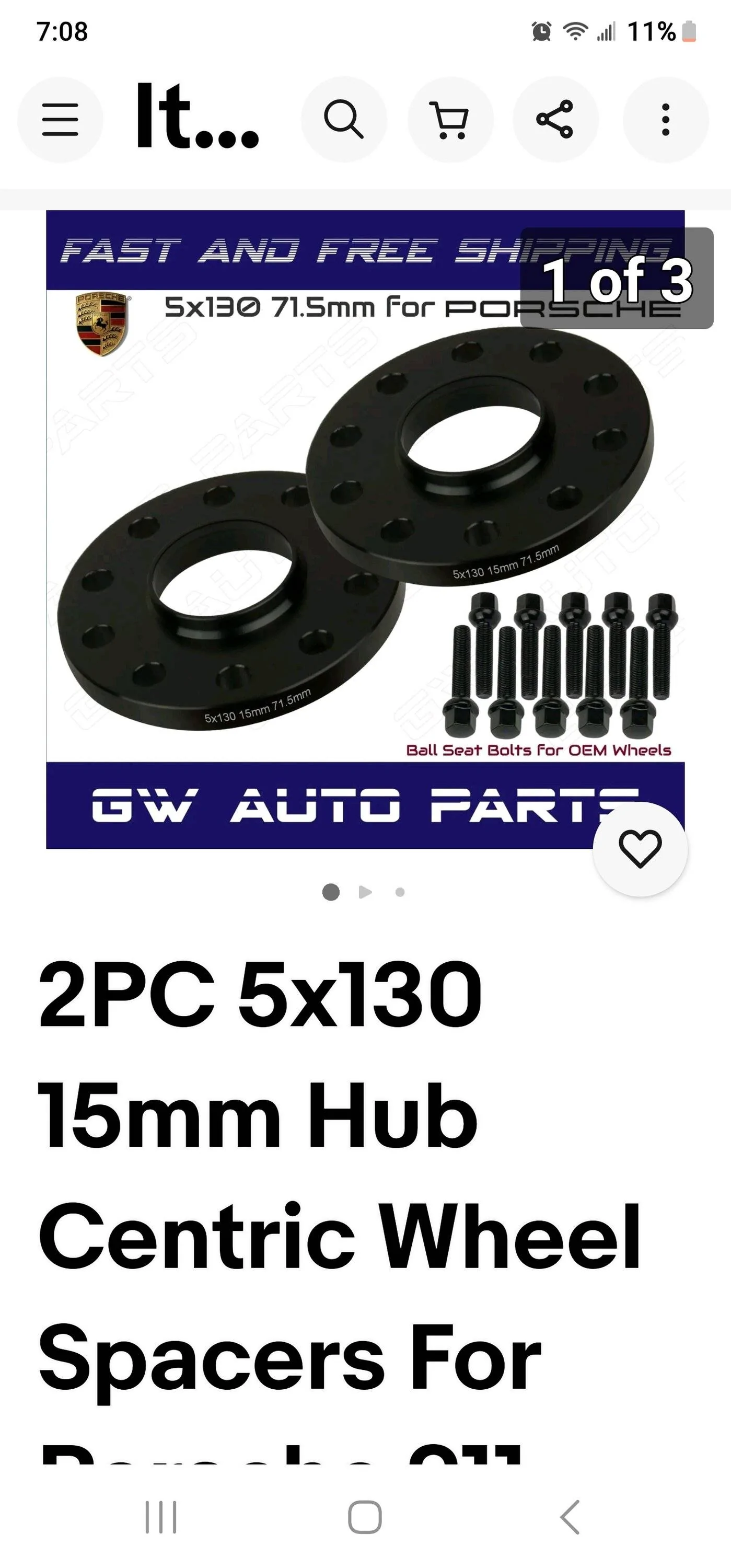

I bought these for my back tires.
They have been great and the Lug nuts we're perfect.
Good Luck

Per H&R, looks like center bore is 71.6. These seem noted as 71.5 - as do many others. Interesting that a smaller bore fits. Tighter is of course better even by .1mm!

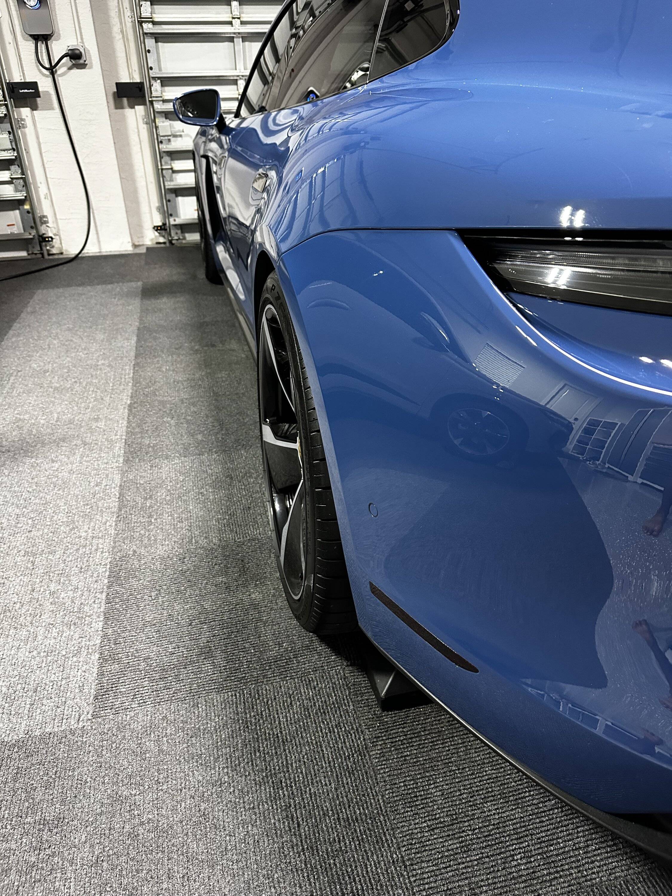

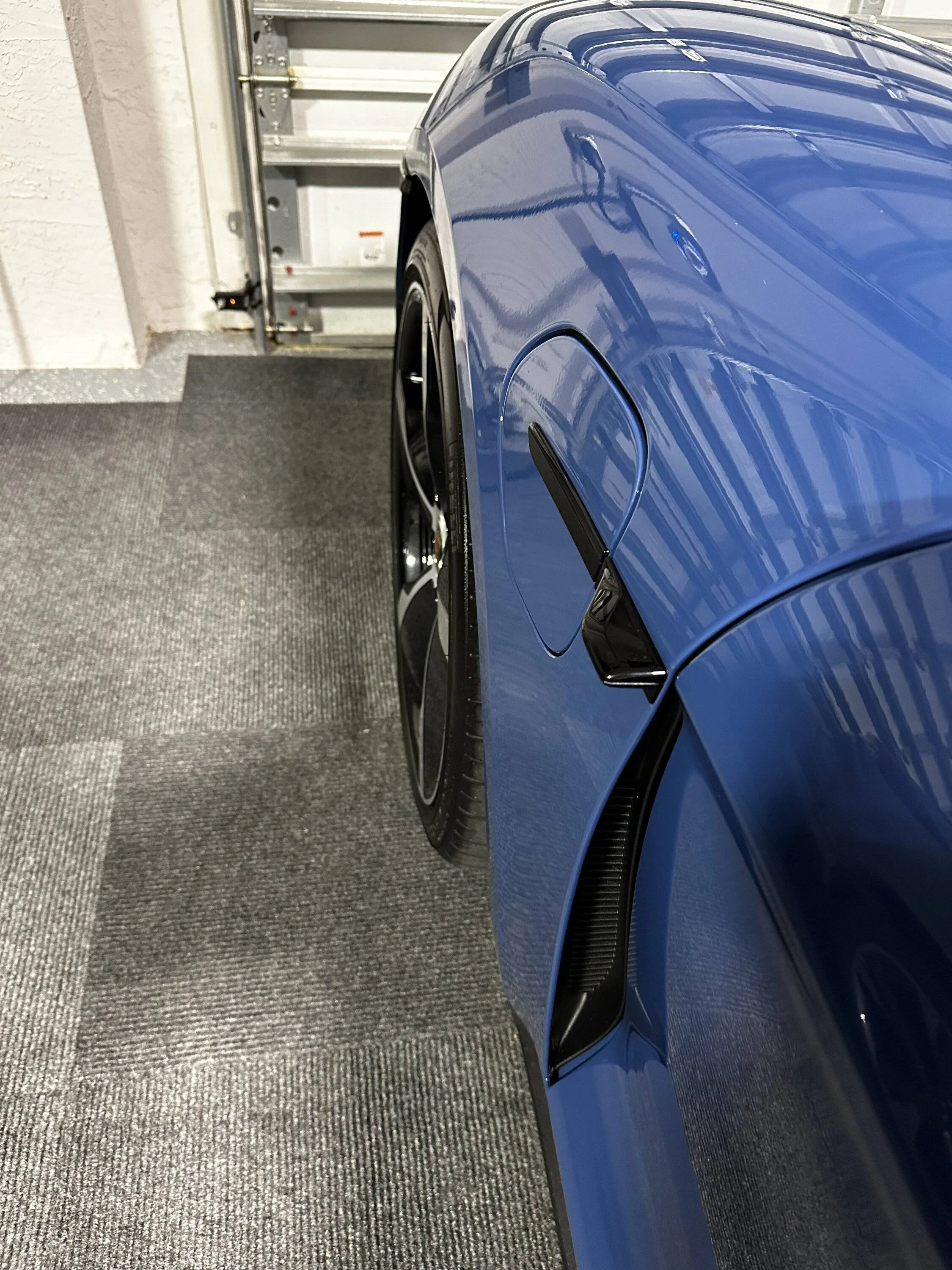

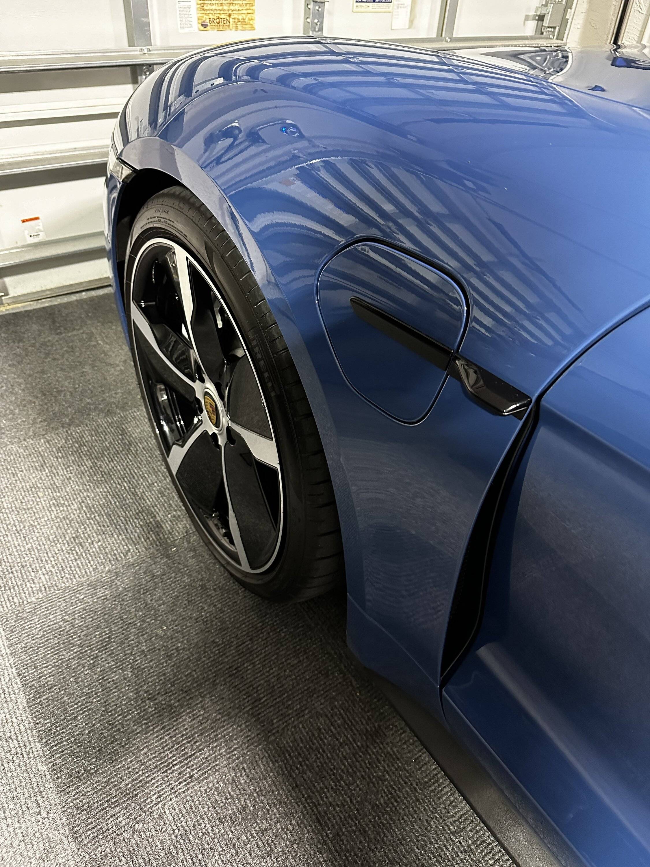

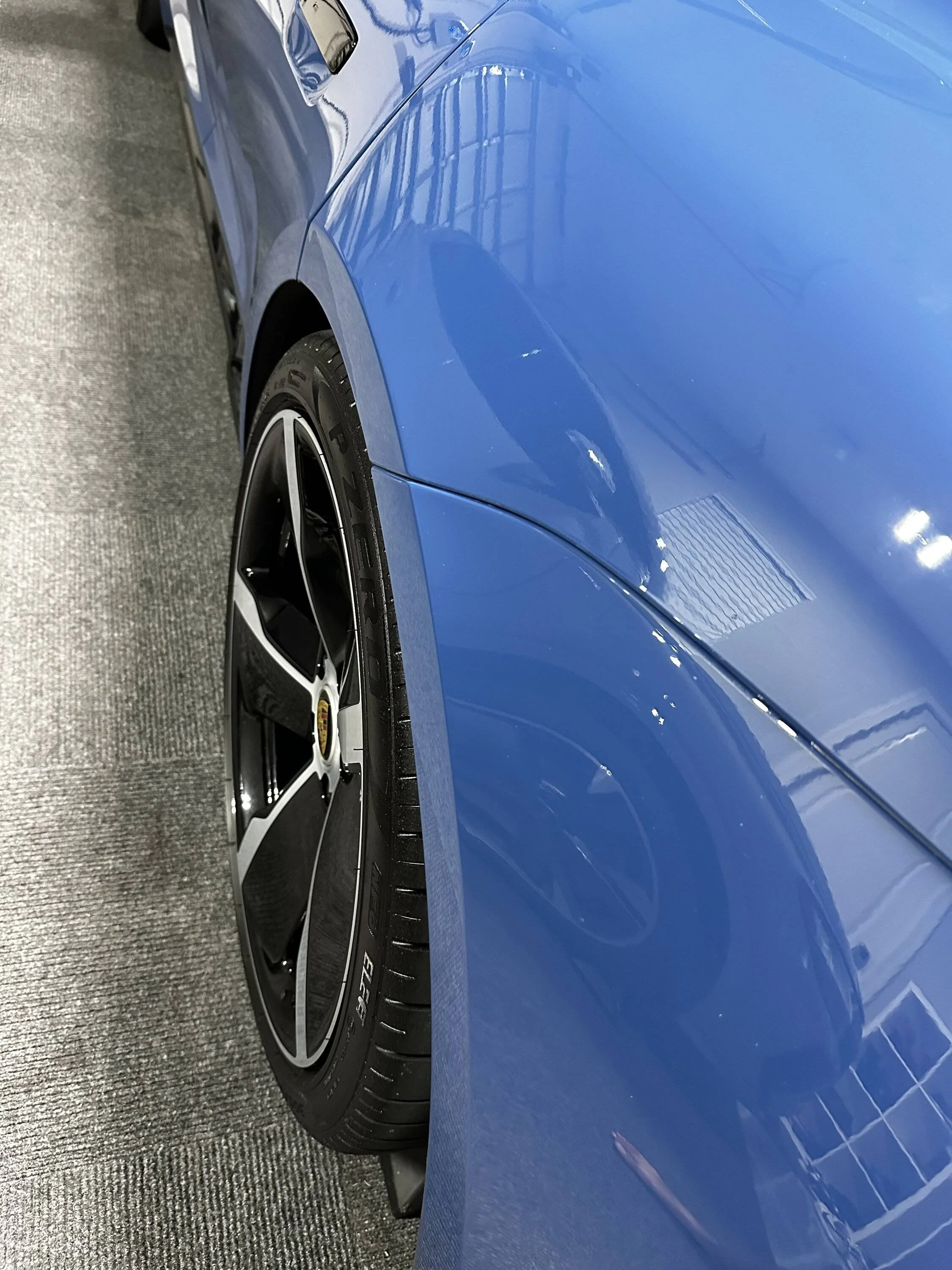

This link is for a package with 14mm in front and 15mm in back but I called them up and got H&R 15mm spacer for all 4 corners on the GTS with 21” wheels (same spec as mission E wheels) and rear axle steering and it looks perfect and have no clearance issues in all circumstances even in low mode.
I like keeping the spacing equal from front to back, and the H&R were top quality as always.
These guys have done many Taycans with spacers and wheels and are familiar with the car.
Pictures are always hard for spacers, but I like a flush look, and no rubbing and it’s perfect to my eyes. Some have done 20mm, but too risky to me.
