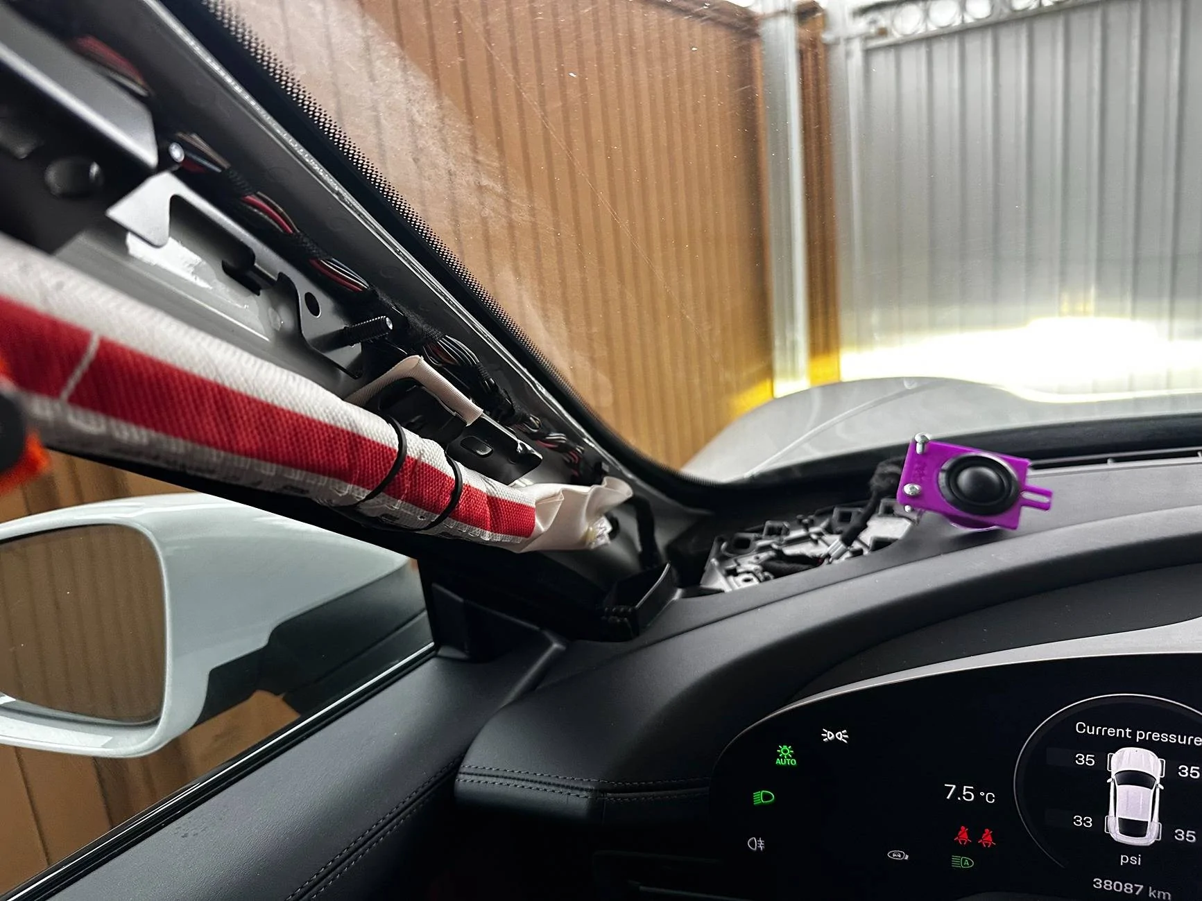

Hey Tony,
I'm curious, why did you need to remove the A-pillar? I realized that you were upgrading from the Bose, which has the tweeters on the dash and not on the A-pillar, so I'm confused why those covers had to come off.

You need to remove the A pillars to be able remove the trim to access the Bose tweeters
I see.

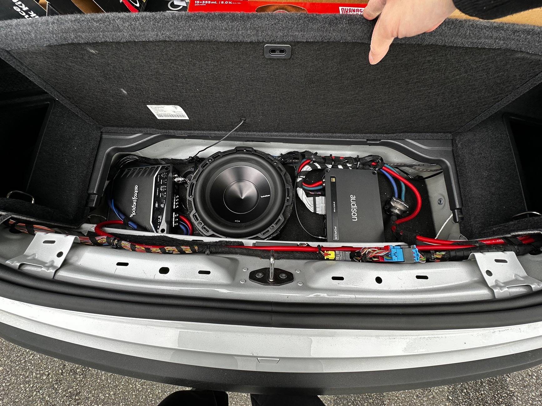

Just installed the Rockford Fosgate P3SD4-8. DAM! The bass hits so hard and CLEAN now. Really puts the Bose to shame. Bose was so muddy compared to this. This thing weighs about 3x as much as the bose one, feels really well made
I've got the GS60 Ans GS40 in transit. Should arrive in a few days

Temporarily connected the subwoofer to try it. Will mount it with proper materials tomorrow

maybe its a POS, but it still works and for the average joe thats looking for a small improvement, it works. when i changed the speakers from bose to audiofrog, everything improved, clarity, crispness, depth of sound, etc. regardless, i've since overhauled the entire bose system (amp, subwoofer, all the speakers). i'll make a post about it soon, but for now heres a picture ;)
