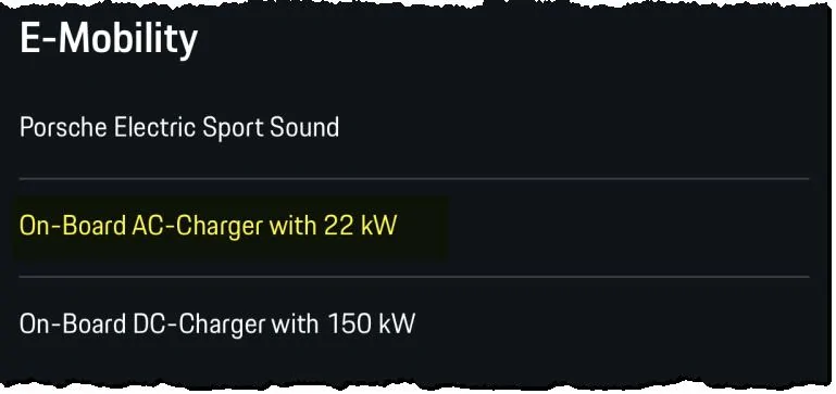

In MyPorsche app, go to "My Garage" (picture of a car in a garage on top right of the Vehicle screen). Then click on your car. Then click on "Technical details", then click on "Included Options". This should list every option your car has. 80A charger will be listed under E-Mobility as 22 KW (it's only 19.2KW, but in EU on 3 phase power this option code is for 22KW upgrade). Here is what it looks like on my car (which has the 80A option, I use it every day).
Porsche Taycan Replacement charger recommendation? 1727773893937-qc
Caveat, I don't know if it will show up in the app if the option was added after delivery. The upgraded charger technically is an option that Porsche officially supports as a retrofit, though a very expensive one (over $8K IIRC, mostly labor, vs. $1,200 if ordered with the car), so probably not a lot of people would be willing to pay for it.

thanks for the guidance I was able to confirm that I don’t have that option only the on-board dc-charger with 150 kw
