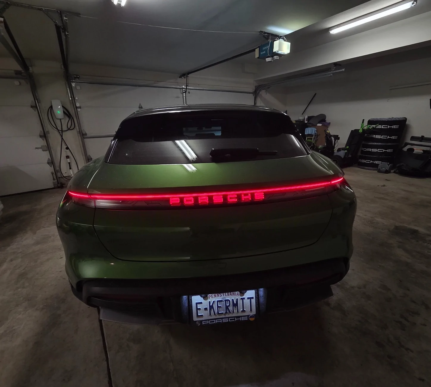

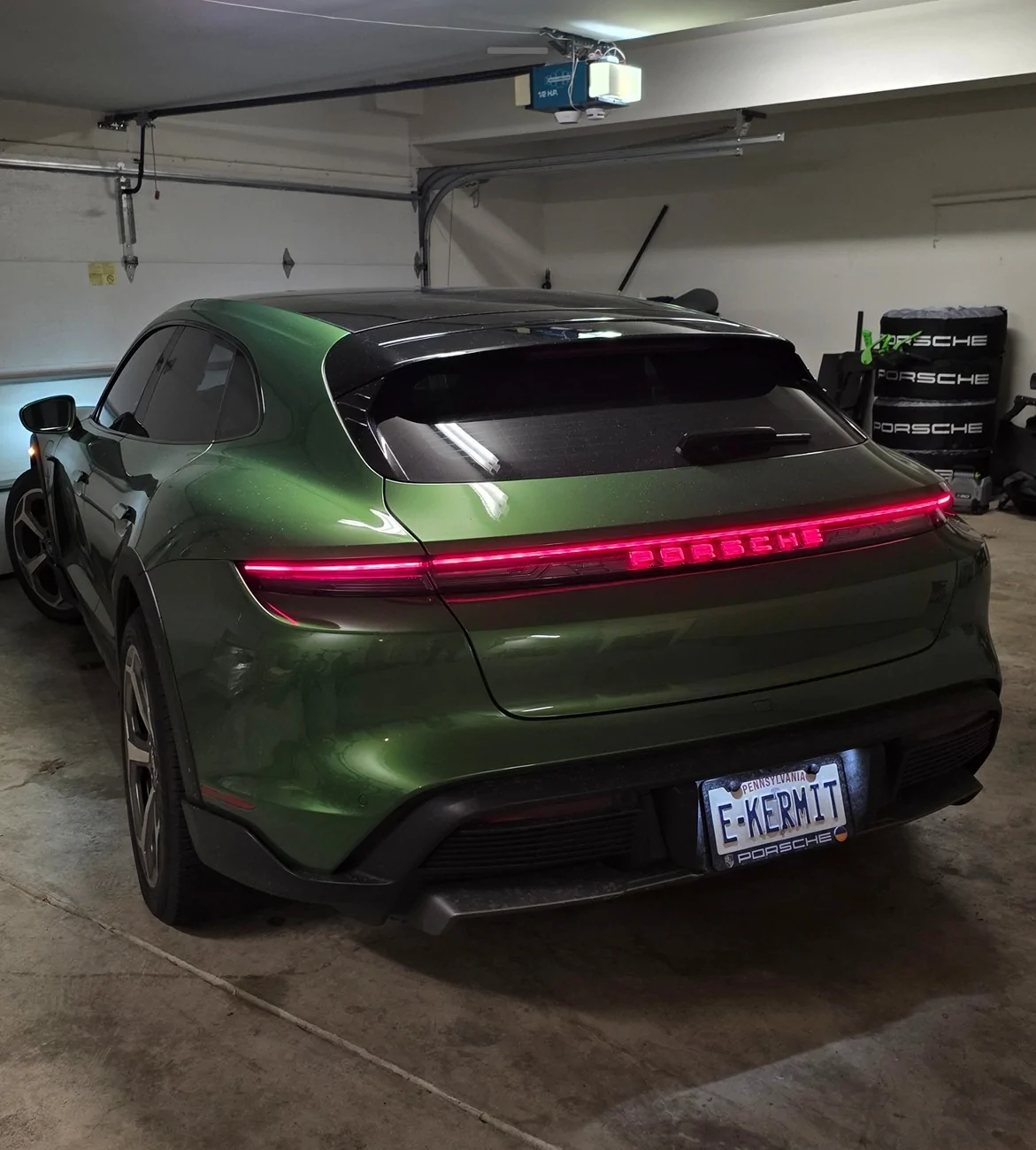

Just to clarify the rear lightbar that I bought from ebay shows the 2024 time stamp on it. Its only the lightbar bar without side indicators.
Yes, with a new lightbar wiring connectors are upside down but it still connects fine without any modification to cars originalwiring. The light bar letters work as on a new model without any wiring modifications or piwis coding.

For the lightbar it was just plug and play. No coding needed. If you also.want yellow side markers like in Europe coding will be required.
Got the lightbar from eBay, Latvia guy. Great dude, good communication. Everything works like it should.

Correct. Just for the light bar it was plug and play. You need to be sure to mention that you are in US and need a US option one. They sell Euro ones too and these have a different connectors and maybe need to be coded.
The one he send me worked without any coding.
Coding needed if you also installing euro yellow turn signals. This is my next project...:)
